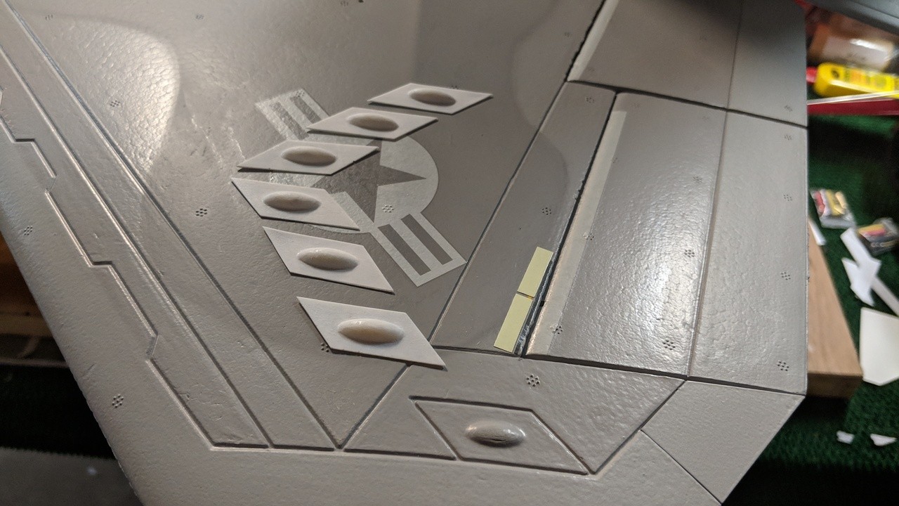

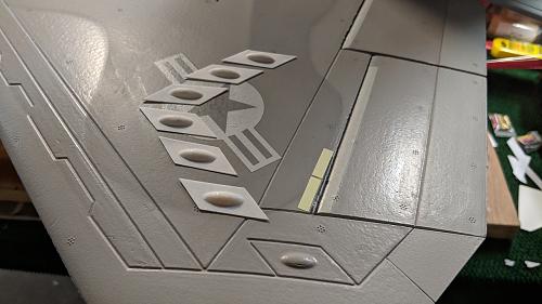

    Making some forms to vacuum form light covers for the wings. Casting them from resin in silicone molds. When I have a bunch I will vacuum form them with clear PETG sheets.

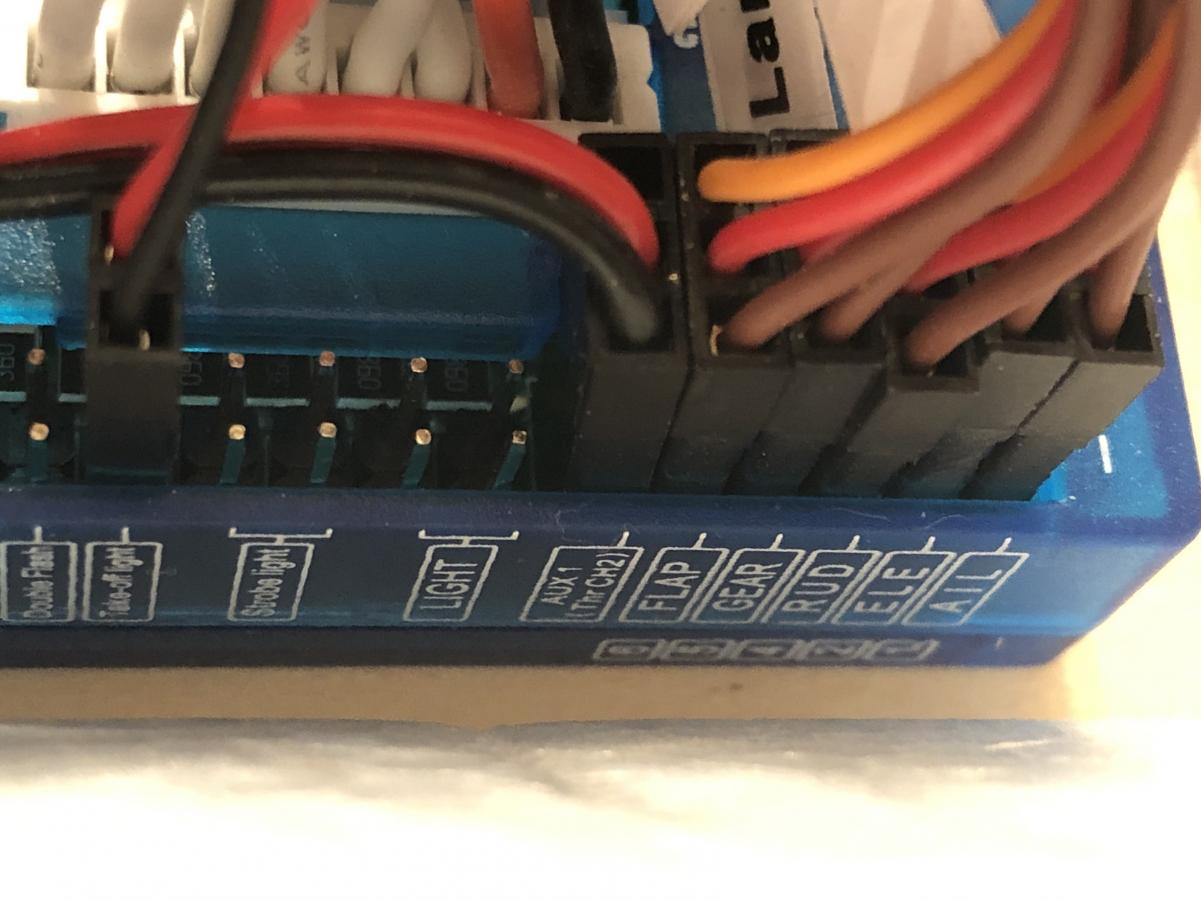

      Woah!!! Great catch! wonder if it matters! .... I will go with factory recommendations! Thanks brother!
      Just saw this post. I have the UBEC plugged into an unused slot on the receiver. Where in the manual does it show where to plug the UBEC. Is it an addendum? I'm using the latest PDF manual online at Motion RC.
                Thanks,
                Luis
                Luis, no mention of where to plug bec in in manual. The control board does have a slot labeled bec though.
                          I didn't even notice that but that is interesting. I plugged my bec into a slot on the Rx since that is what I have always done but I wonder if anyone is using this BEC slot on the blue box.

                            My box has no slot for the UBEC. If you look on the blue box addendum sheet included with the F-22, the MCB-E (the box installed in my 6S Raptor), has no slot for the UBEC. On the other side of the sheet, the diagram for the MCB-D does have a slot for the UBEC and Afterburner LED. This is the only reference to the UBEC slot I can locate... Hope this helps with a bit of the confusion... I have installed a Castle Creations 20amp Pro which has two leads and both of those are plugged into my AR-9030T receiver.
                              I guess I added to the confusion by incorrectly identifying which MCB was in my 6S Raptor. Since I could not read the forward facing labels of the installed MCB, I counted ports using the wrong diagram.
                              Still believe the ubec input should connect on the power bus with the highest power demand. Meaning the bus where the servos are plugged in.
                              Have done this on cortex flight stabilizer and separate rc combo, aura 8 and rx combo, kontronics Kosmik/jeti rx/demon fbl install in my speed heli...all have and are still working without a glitch. Actually, the Kontronix has two leads from esc. One goes to fbl unit where servos are connected and the other plugs into rx. If I were using a castle pro, I would follow this method and run one lead to rx and one to MCB on the Raptor. I see no benefit to having two power leads from one source connected to the same power bus.
                              I did not come up with this method, but learned from the pros who were flying the same equipment. Before taking their advice, I used to only provide power to rx.
                              Just like Ike you can power a rx only system by providing power to just about any spare port on rx. It does not require a label that says “bec”. After looking harder at my MCB, I ended up plugging bec into aux 1/throttle ch 2 port.

                                I agree on the distribution to the power bus. One lead to the receiver and one to the blue box and that would be the best you can ask in that setup... All the buses are positive, negative and, signal, so as long as you follow that pattern, it is all good!! Merry Christmas!!! :Cool::Gift:
