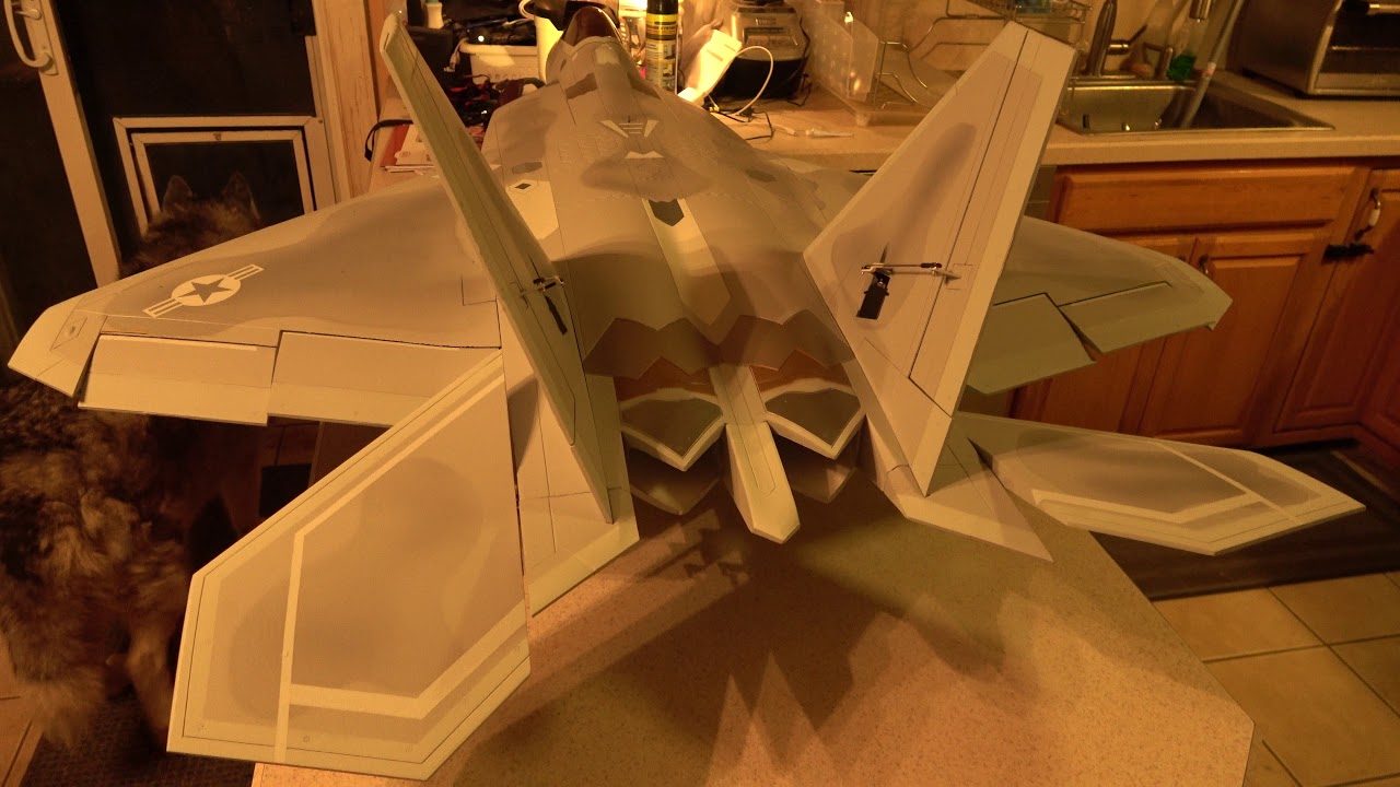

        Another question/issue:
        The supplied rudder linkage doesn't seem long enough to adjust rudder to the neutral position. The manual identified rudder linkages as 85mm long, so I know I'm using the right linkage. There is simply not enough threads left for me to adjust the ball link any further. Picture shows the current rudder position. It's not anywhere near center.

                Flanker271, If those screws were flat bottom, you got the right ones. The end one will stick out due to thickness it is going in. Check your servo horns on rudders to see if centered, maybe a tiny bit of subtrim will centered it. Mine had one rudder horn facing forward a bit, which caused me to unscrew clevis more on that side.

                  The horizontal stabilizer screws are indeed flat bottom, thanks for confirming that these are the correct ones.
                  The Rudder servos are centered and the horns are at 90 degrees when I encountered the short linkage issue. I ended up fixing the linkage issue by reinstalling the horns tilted slightly backward. It now measures approx. 110 degrees at neutral position instead of 90 degrees.
                        Don't know where these linkages came from but they are not the correct ones. On the two Raptors I have the rudder linkages are the same as the elevators and they fit perfectly.
                            They are 85mm. All the same for the elevator and the rudder. Mine fit just fine....

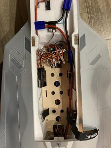

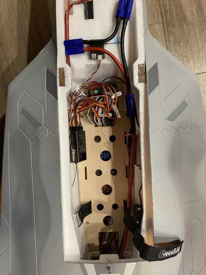

                                  I finished the lightening holes in the battery tray. Now I have access to the gain adjustment knobs on my gyro. To save a few more grams I removed the four magnets from the nose and glued it with Foam-Tac. This baby is ready to roll! Great work Freewing and MotionRc! Click image for larger version
