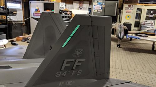

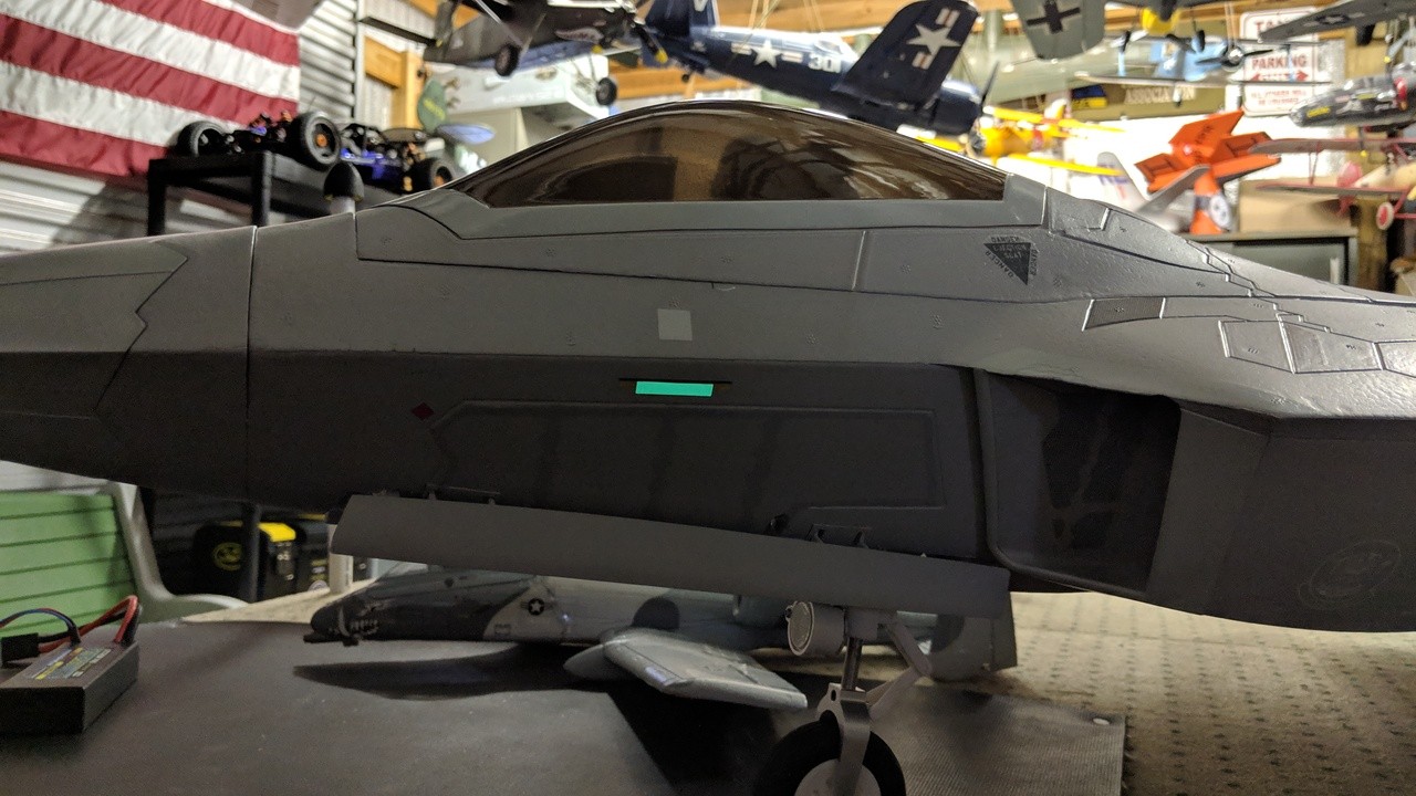

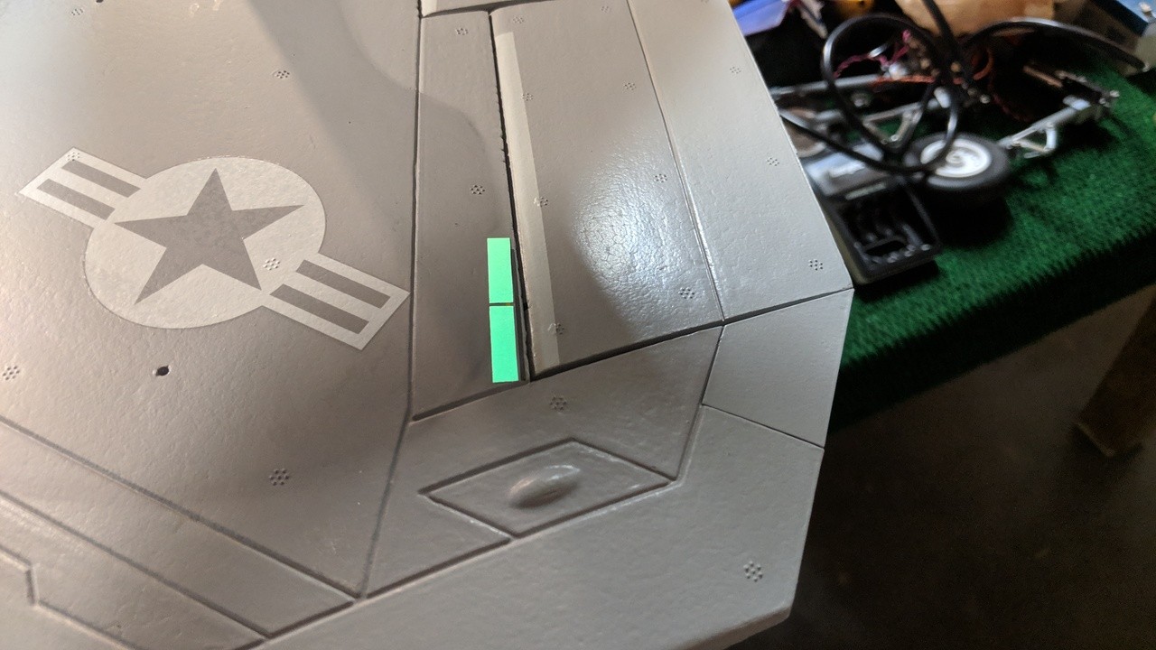

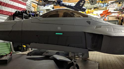

    • Maiden and one other flight successful! She flies great!! Good power on the new 1390kV 8S fan and sounded amazingly smooth. Only needed a little trim to get her tracking straight. Take off from short manucured grass with half flaps was achieved in about 150'. Tracked beautifully through the air and man does it look good. I did most of my flight at about half throttle just taking it easy. Set up per the manual the high rates felt good to me. CG was per the manual as well with two Roaring Top 5000 70C packs. One 6S and the other 2S. Landed with full flaps and a slight tail wind so came in just a little hot but without issue. I couldn't be more happy or impressed with it. George got video of the maiden and will post it up soon. Now on to the mods starting with these...

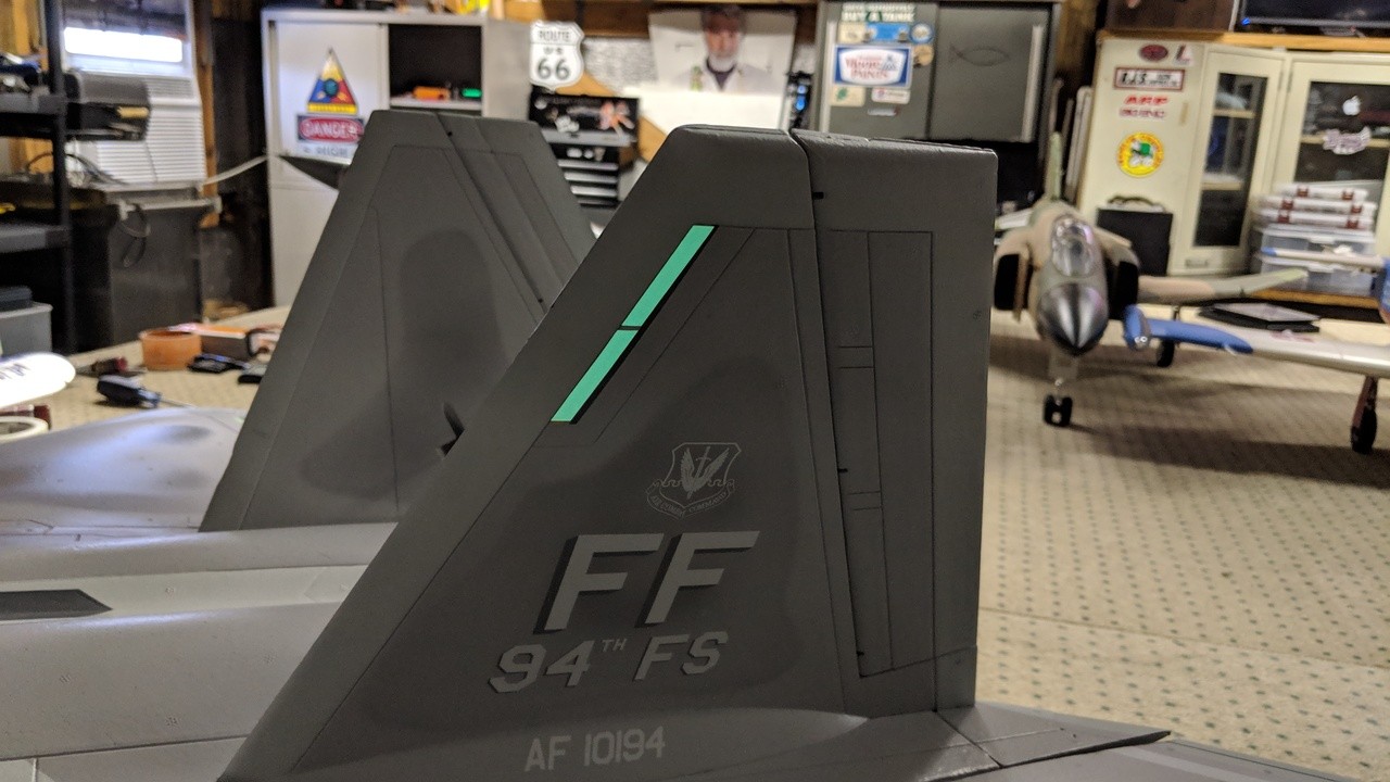

        RCJD, Your F22 looks suburb, as usual, sir. Is that 'glow-in-the-dark' tape? I like it whatever it is. I used 'green slime' colored Glow in the Dark tape on my A-10 and love the effect, but I like the 'blue' on the F22 and presume that is closer to scale. Bravo Zulu. Best, LB
          Glow in the Dark Tape - 30 ft x 1 inch - Glow-in-the-Dark Luminous photoluminescent / luminescent emergency roll safety egress markers stairs, walls, steps, exit sign. Glowing pro theatre stage floor https://www.amazon.com/dp/B01NH0JTQX..._odhdCb11VA3JM

            What are your flap settings? The recommended settings seem off to me?
            • Originally posted by adb2@suddenlink.net View Post
              I set max. or landing flaps at 32mm although I think they could go lower. There was just one value of 32mm for both hi and low.
              • Originally posted by RCjetdude View Post
                Thanks for the link Steve. Ordered a roll. What are you doing making about 1/4" strips?

                    A roll of the blue luminescent stick on vynil is already delivered since seeing your pics ???? I’m ready for maiden today with the 8S version. ( my first 8S ) I have the 6S system ready to install. I’ll fly them both, and stick with what suits my style of flying. I had the F-16 nose wheel, and I ordered a center burner the day I preordered the plane. There are no mechanical issues with mine at all.

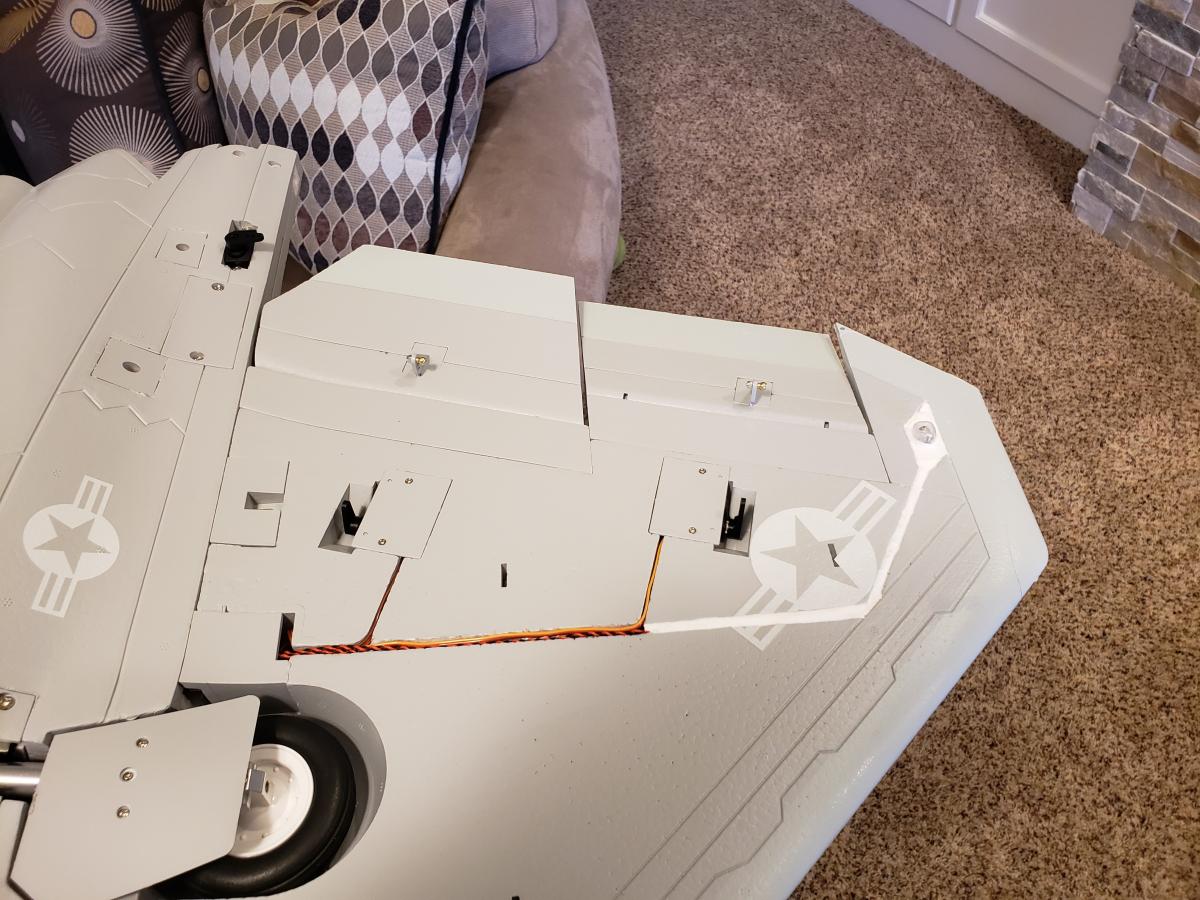

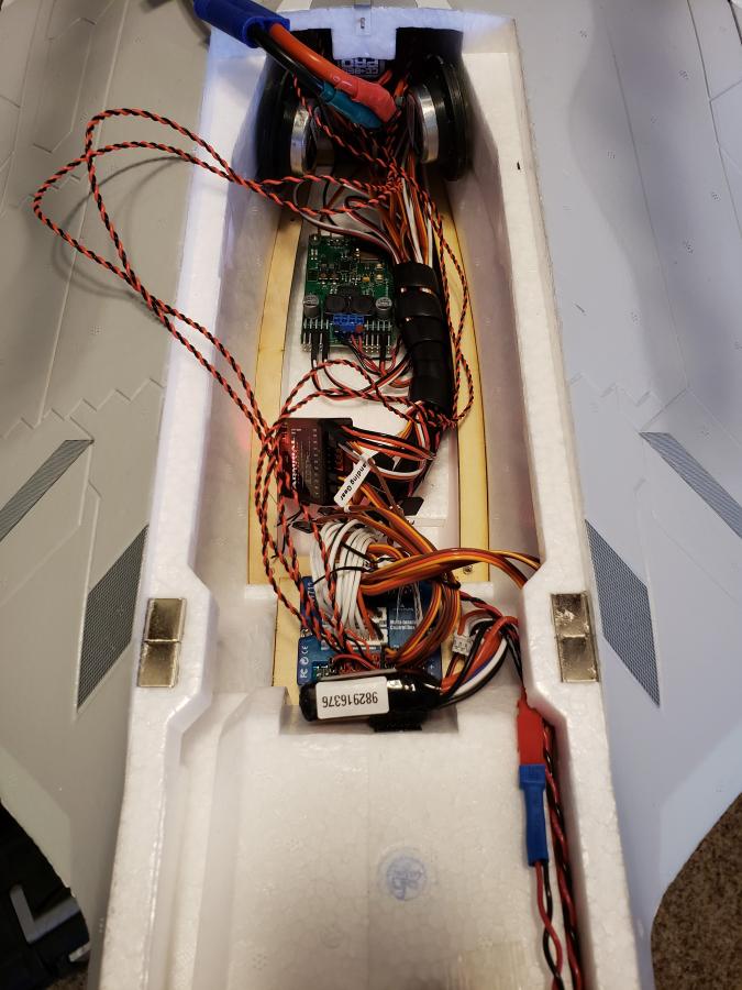

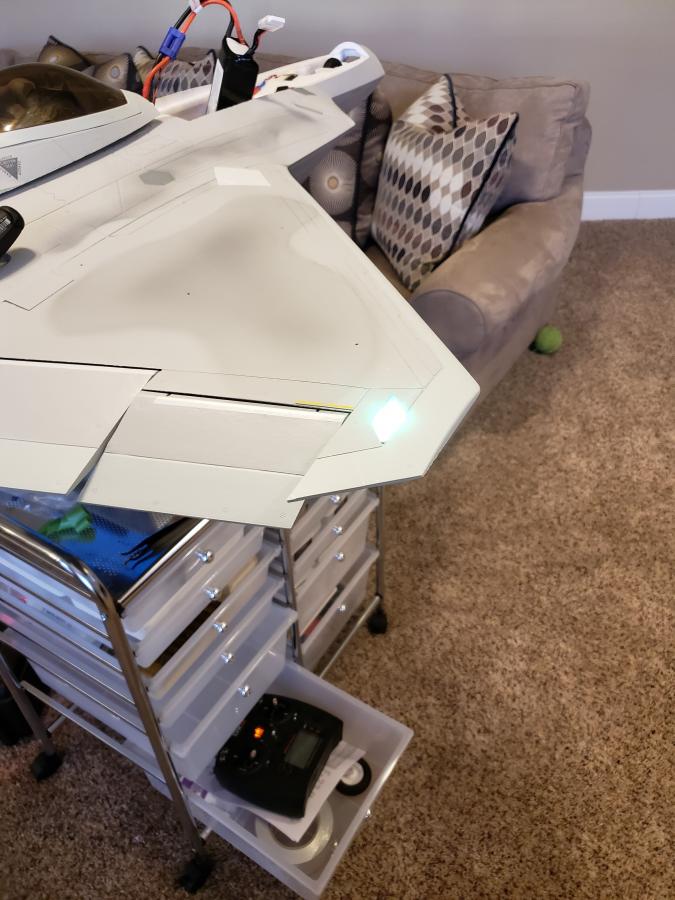

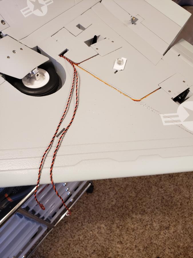

                    • Tinkered a lot this weekend with not a whole lot to show for it, but satisfying nonetheless. Set up the centerburner and lined up some aluminum tape. Wired up and attempted to organize the fuselage with my Shockwave sound system as well as toy around with possibilities for receiver and gyro placement. I ran a bunch of wire (not realizing I can actually plug into the board that attaches to the wings) to set up nav lights on the wing tips. Still need one more light cover from the T45 set to finish, but cut out and placed covers in designated areas. Cleaned up my extra channel with some foam tac, as well as any discrepancies around the light covers. Once I'm pleased with the results, I'll go ahead and airbrush to match. Coming along nicely although everything will likely come to a screeching halt with my wife being induced Wednesday!

                        • Originally posted by bill34207 View Post
                          A little less than 1/4".

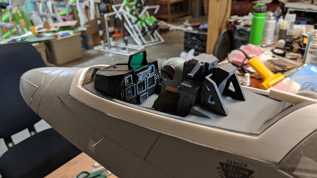

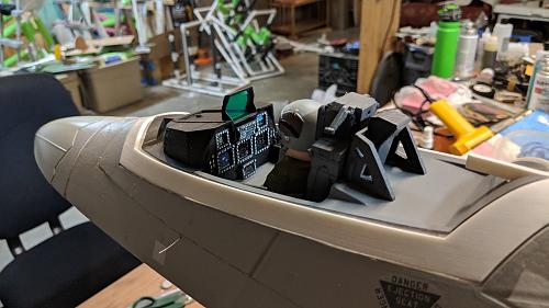

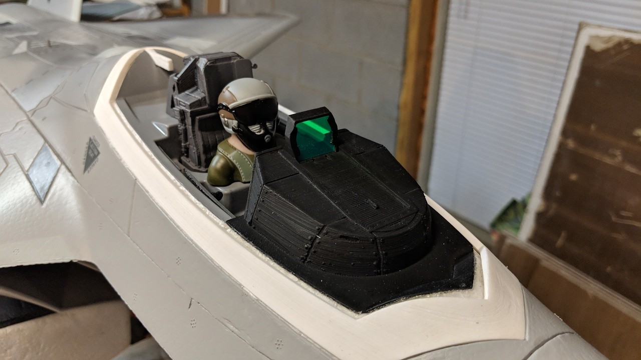

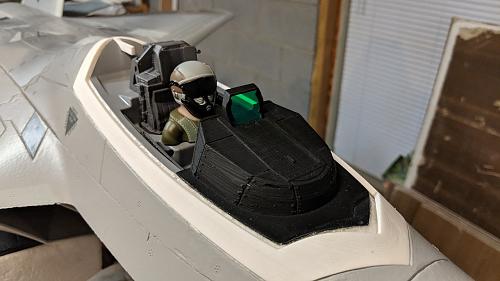

                            And a few pics of the canopy frame and cockpit progress so far.

                              As always RCJD, Looks awesome! nice work! :Cool:
                              • RCJD, Top Notch. Best, LB
                                • Very nice!!!
