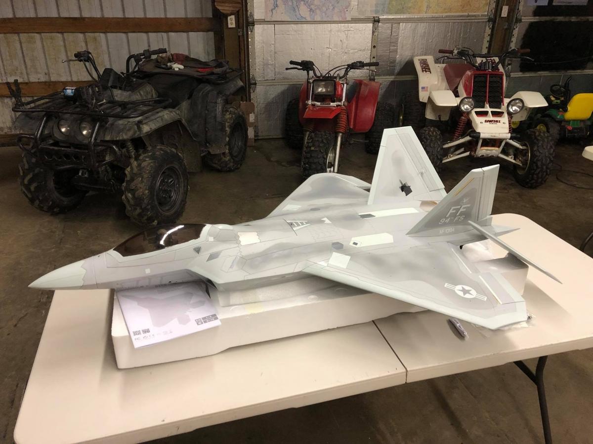

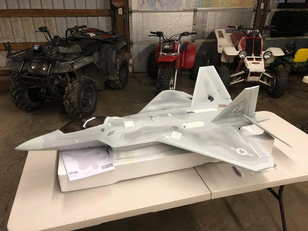

      • Ready for Tomorrows Maiden!
        • Look forward to assembling mine Monday!

            • Originally posted by e4dragongunner View Post
              Looks great! What field, Palos or are you in Geneva?
                      Set to maiden tomorrow too. Noticed your bec plugged into rx. Isn’t it recommend to plug bec into control board?
                      Freewing A10, F4, F22, Sebart Avanti S mini
                      • Originally posted by purduephigam View Post
                        member at Fox Valley.... Just not big on facing south in the winter ! Going to Pratts Wayne in Bartlett !
                        • Originally posted by john2kx View Post
                          Woah!!! Great catch! wonder if it matters! .... I will go with factory recommendations! Thanks brother!
                            I’ve done it both ways but the guys at esprit recommend having power source fed to bus carrying the most load.
                            • Excellent Thanks Man!
