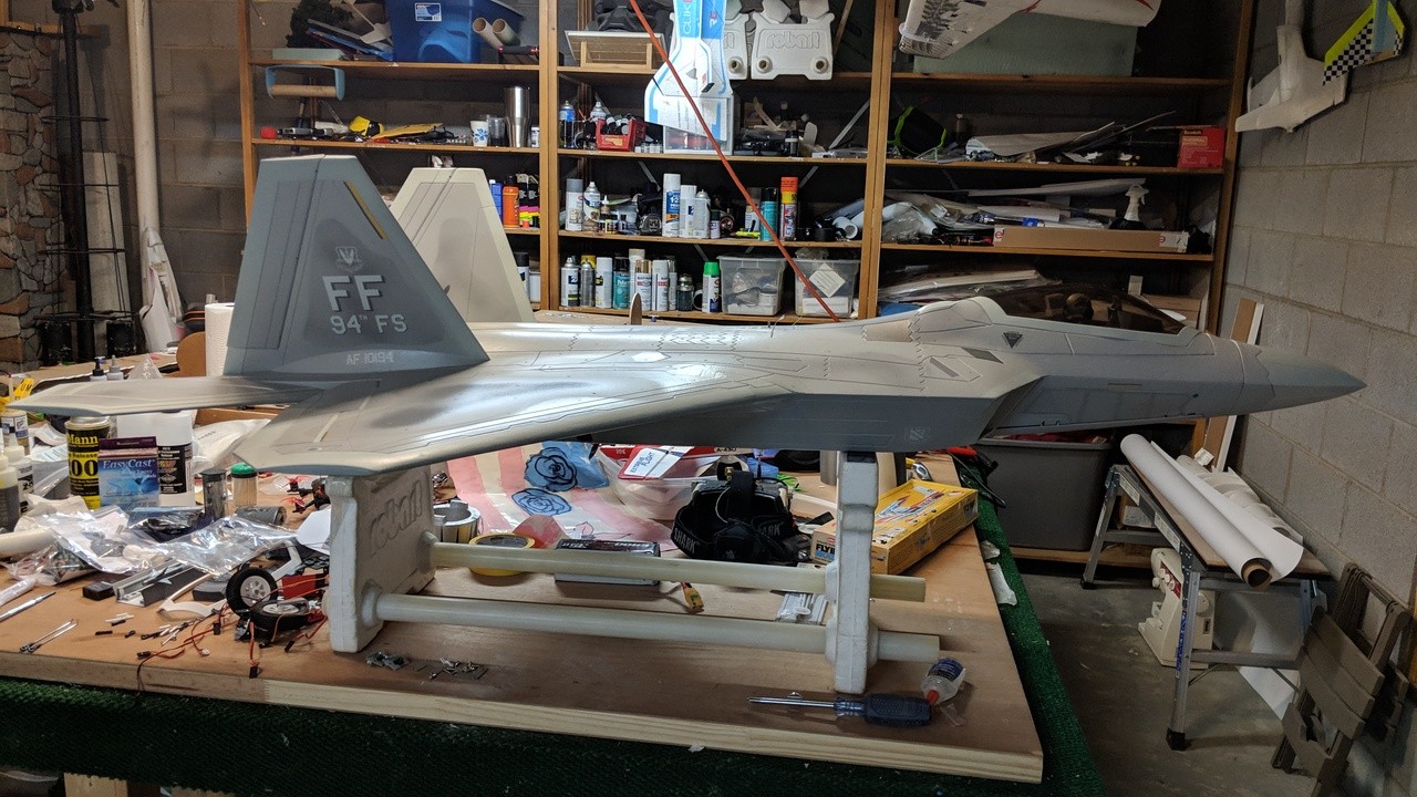

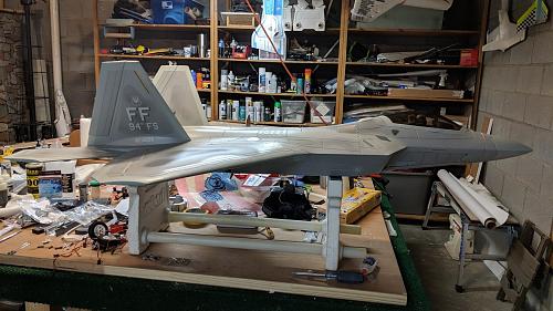

                    I got my 8S bird today and this thing is a beast if a plane. New style of hinges make them almost invisible. Nice touches all around and I don't feel the need to re-paint it! LOL Everything worked perfectly and I noticed no slop in my aileron and flap hinges. I plan to fly it stock and will then do a few mods. Cockpit detail, opening canopy, RC Geek center burner and nav lights. Anxious to try out this new 1390kV fan. Overall I am very impressed with it so far. When I first opened the box I thought the vertical fins were the wing... :Silly:
