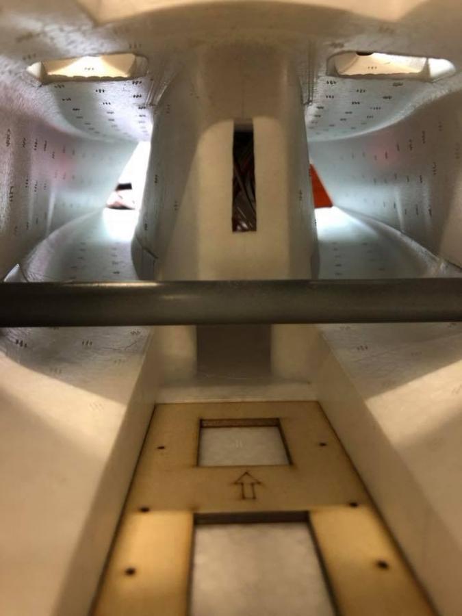

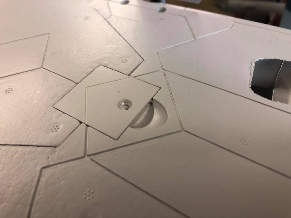

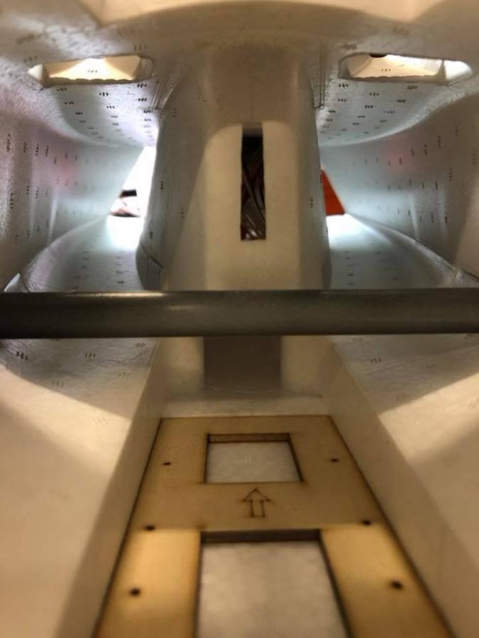

    Found a picture from building last night and zoomed in. This was after I was messing with them seeing at what deflection they touched. But, you can kind of see what I am talking about. I'll get better pictures tonight.

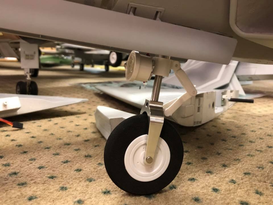

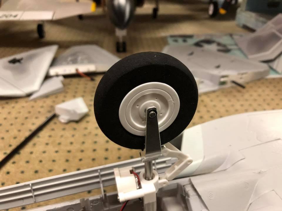

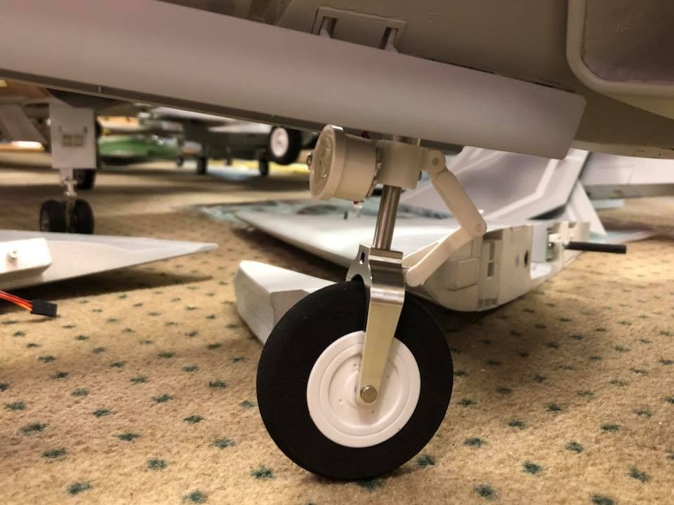

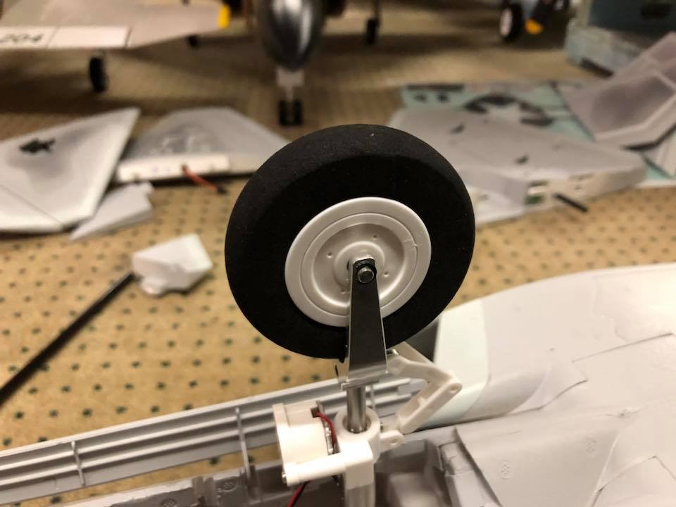

        First things first… I had to get rid of that crazy front wheel, this is a Freewing F-16/F-104 main wheel.
        https://www.motionrc.com/products/fr...for-4-2mm-axle It’s a direct bolt-on.

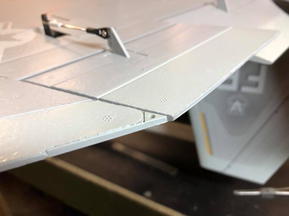

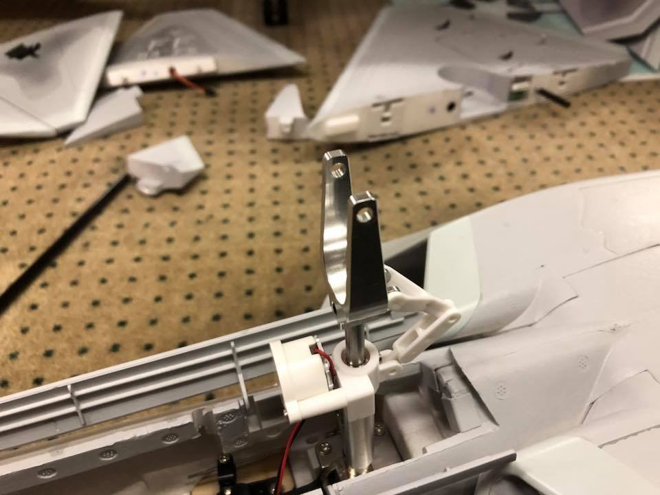

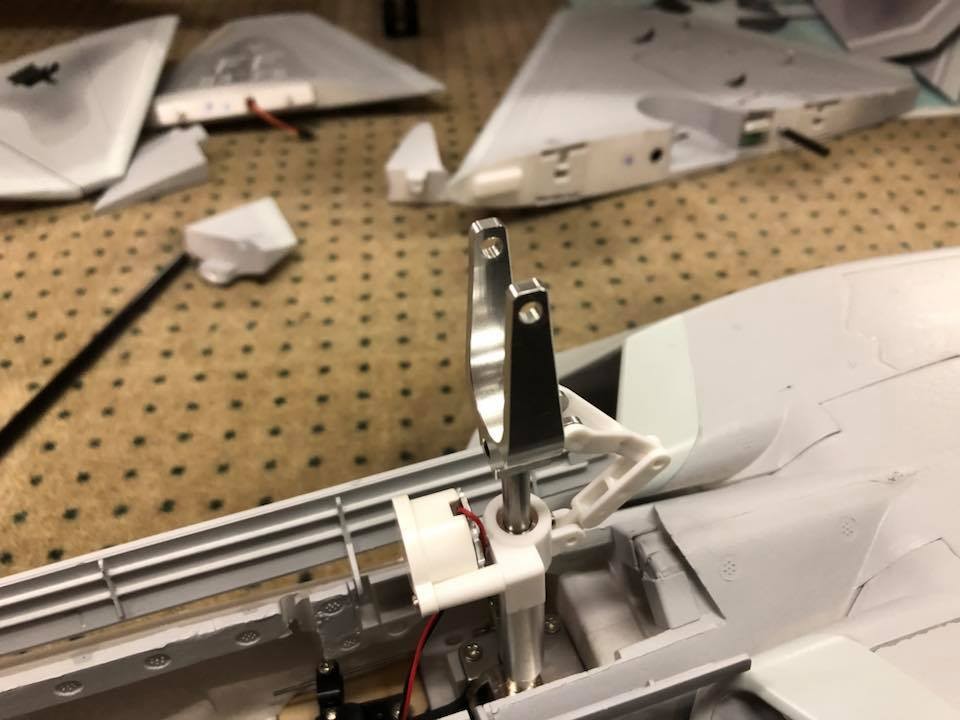

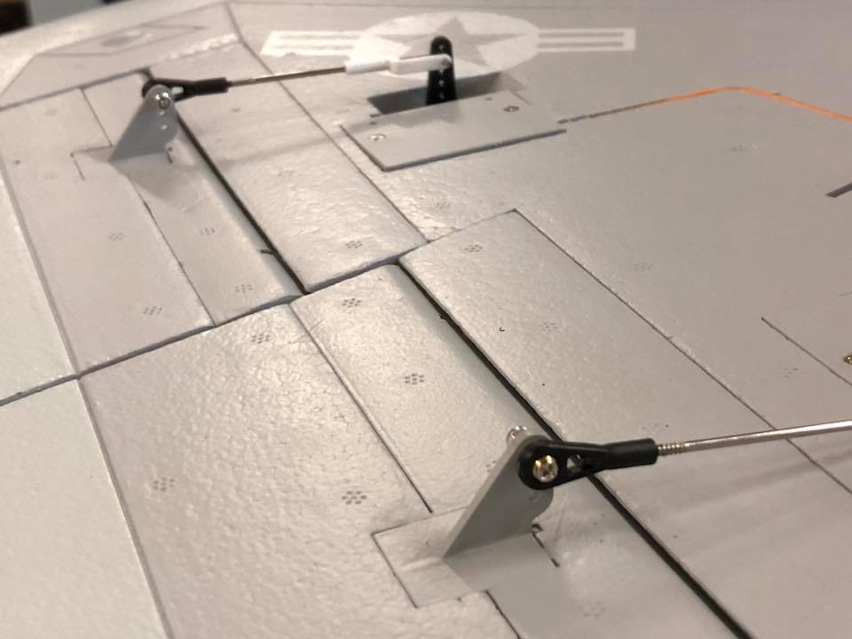

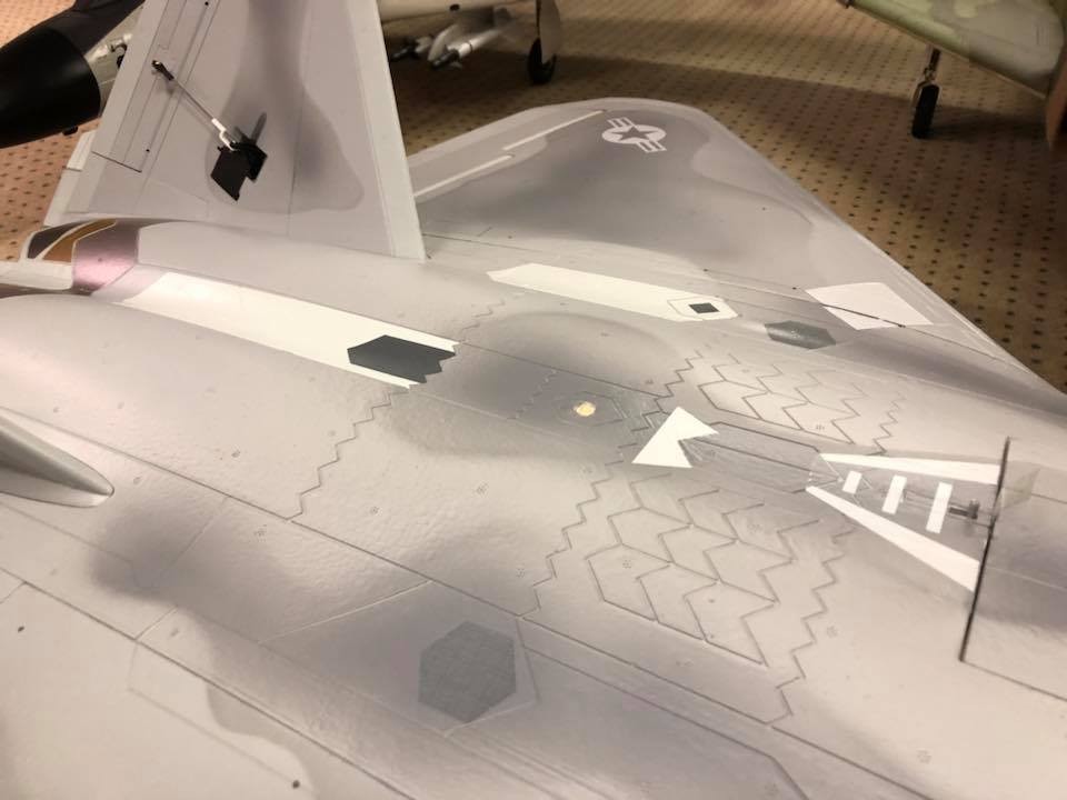

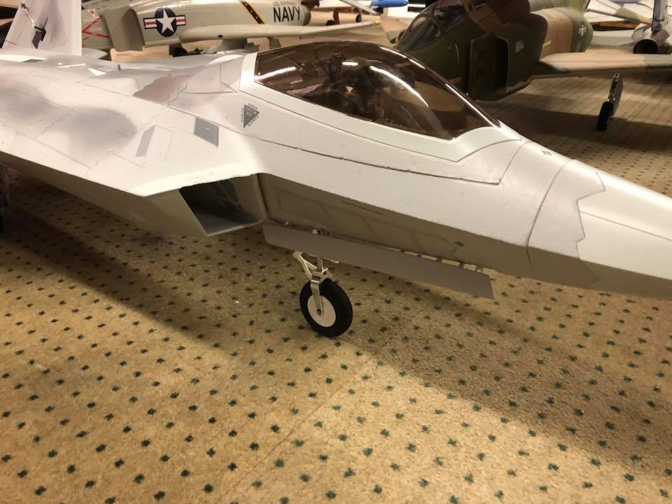

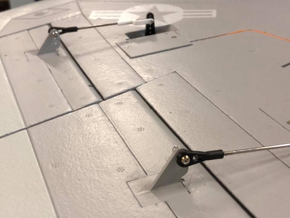

        I love the finger grips on the fan cover...cavernous intakes...sharp point protection. I moved the right flap ball to the other side of the arm for straighter alignment, also added strobe lights top and bottom. The blue box has, constant on, two and three flash connections...I went with the three flash:Cool:

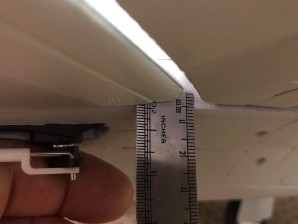

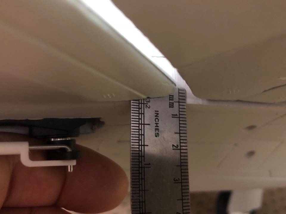

            What is where your elevator should be positioned at neutral stick.
            Thanks everyone

              Originally posted by Visva11
              Can someone help me explain this.
              From where should I measure the 5.5mm? From down move 5.5 mmm to up?
              Here’s a better picture of where the elevator neutral point is at 5.5 mm
                Perfect. Cleared my doubt...thanks alot.
                but which is the elevator leading edge? The red marked?
                then what is the blue marked?
                thanks in advance.
                  thanks in advance.
                  The sharp edge (seam) in the blue pic.

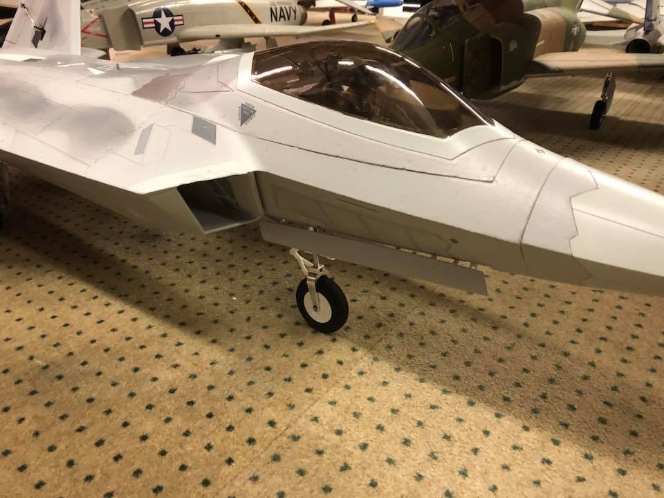

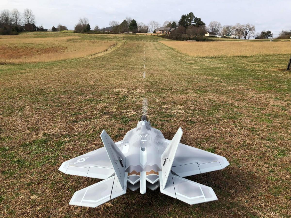

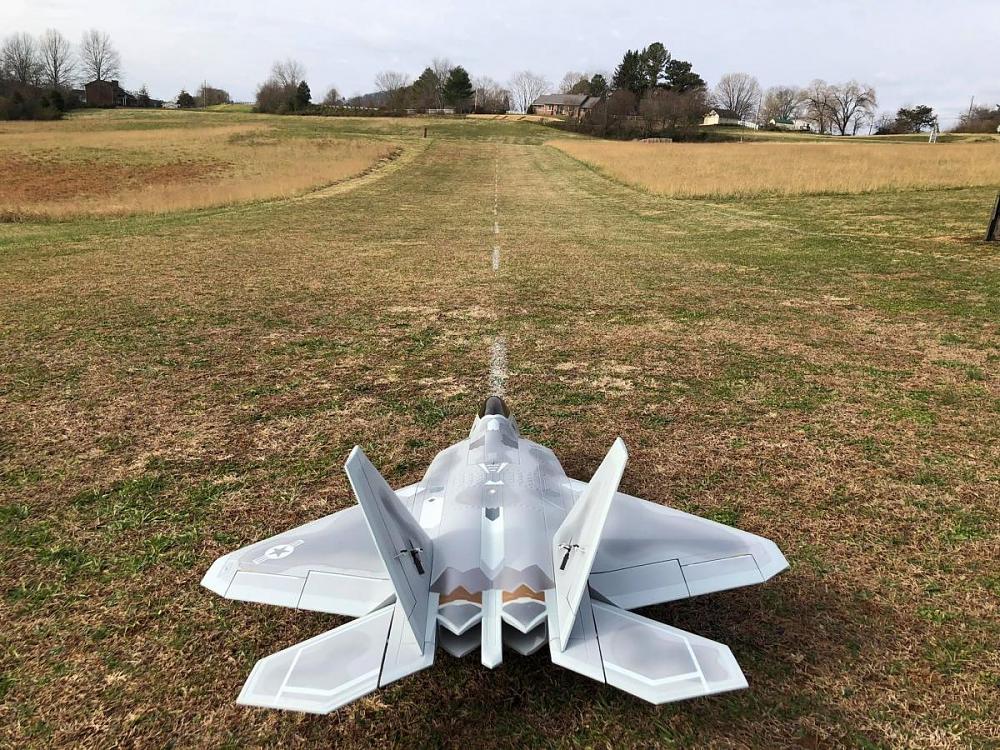

                        This is the ugliest plane I ever loved:)
                        I just never was a fan of the F-22's look but if there's a great looking Raptor this is it, it's one heck of a plane. Solid as a rock, great on grass and will slow down to a walking pace.

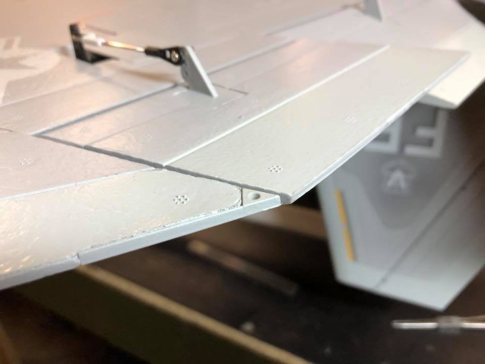

                          Great pics and info! Would love to fly mine, but concerned about play in ail/flap hinges. Did you have any in yours? Thanks!! Tom
                                No play at all in mine

                                    #577
                                    Not a bit.
                                      I know right! But they fly so good! Stoked!
