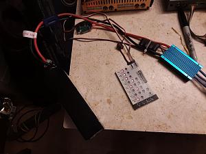

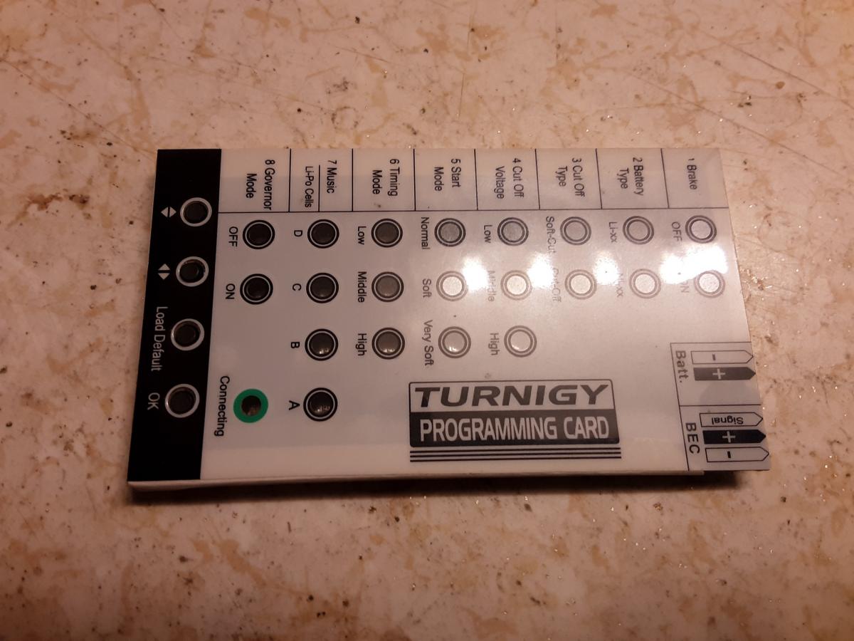

        #1563
        This is the one I use. Works for the 100 in my L-39 also used on the 130's in my twin 90 mm A-10
        Note that on non internal BEC equipped ESC's you also have to hook up the external BEC lead to the battery side.
        Click image for larger version  Name:	20190123_062904.jpg Views:	1 Size:	103.4 KB ID:	173903
          • 5398
          #1564
          That's the same one I tried with the blue 130A ESC from the F-22. I had tried it before on my Stinger 90 too. Tried with both BEC and a 4.8 flight battery and it wouldn't recognize it. It does work on the normal black shrink wrapped Hobby Wing ESCs.

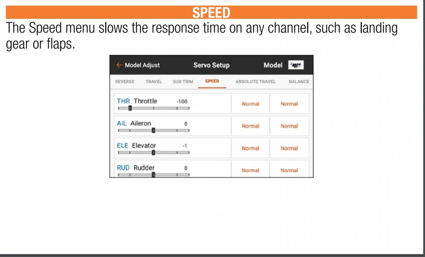

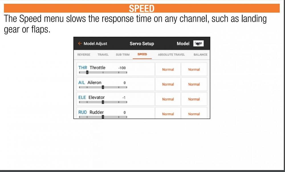

            Hey guys, I'm doing Steve's canopy mod and using an auxilary channel on my IX12 to operate the canopy. Still getting used to this radio. I set it up to start with on a turning knob to test it but would prefer a switch. Anybody know off hand if there is a way to slow down the servo in the transmitter on a channel other than flaps/elevator?
              • 8218
              #1566
              Hey Brad, in the Servo Setup menu there is a Speed sub-directory. That's what you are looking for my man!

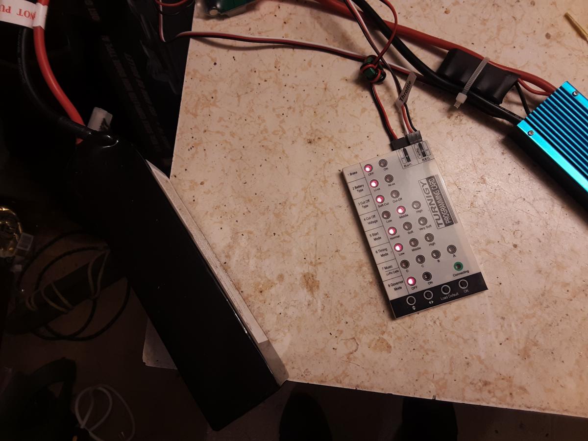

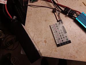

                            #1573

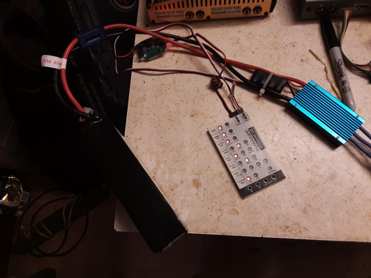

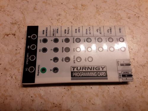

                            That is strange. I bought a complete 6s F-22 setup from Mikeee on RC Groups so decided to try it. Works on mine. I changed the timing from medium to low, updated, unplugged the pack and it kept the setting so changed it back to medium and updated again
ID:	174043Click image for larger version
