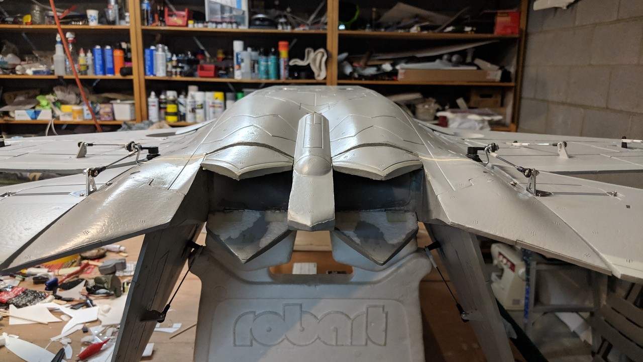

                        Also, I am having a difficult time finding the neutral point for the elevator. I have looked over the diagram at the manual but it's finding the precise centerpoint as the base to measure up 5.5mm to is which I am having trouble with. I *think* I have it but I was wondering if someone had a photo of where the TRAILING EDGE of the elevator lines up with the aft section of the fuse. This will tell me how close or how far off I am. I appreciate the help. Here's a photo of where I have mine at the moment...
                        Click image for larger version  Name:	Capture1.JPG Views:	2 Size:	47.1 KB ID:	172765
                          #1452
                          I see Steve mentioned that it's waaaay too much down which is what I expected. I would assume the trailing edge of the elevator should match up with the trailing edge of the fuse. Clearly I measured from the wrong location.

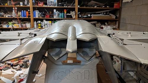

                            See mine? Mine is only slightly down elevator. Half a trailing edge thickness of down in relation to the trailing edge of the fuse. Roughly 5.5 mm from the bottom edge of the fuse to the center of the stab.

                              Perfecto Steve, just what I needed. Thank you!
                                      Here is what you need. Make sure you get it right, or otherwise if it's set too high, you will run out of up elevator, and have major issues flying ... ask me how I know.
                                          :Scared:
                                          Copy that...From the bottom of the fuse side up to 5.5mm. Appreciate it!
