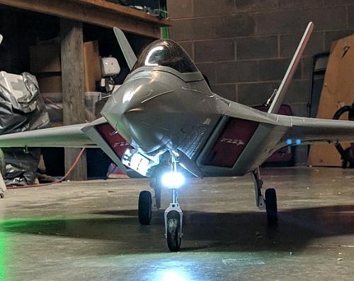

        I also removed the 19th century locomotive landing light and made 2 smaller ones using a "GT Power RC" kit from MRC. Input can be from 4 to 6 V. so I'll Y into the CC20 BEC I'm using- there's still 4 strobes and 2 nav lights to install.....
        Tom

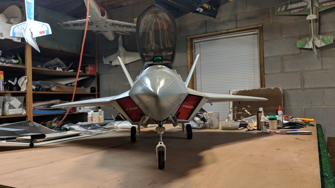

              BTW got the kit Friday night. Don't have a lot of time but started in on the mod list. Painted the verticle stab servos using post it notes and grey primer. Tightened up the nose wheel yoke set screw and loctite. Pulled the first spring out of gear,after binding receiver and dropping the gear, to either shorten or replace. Pulled the canopy to work on canopy mod and 3d pup instrument parts. I assume existing parts have to be removed? Also assume hud gets recycled? Anyway that's where I'm at.

                Nice work! I think I may have to do this as well! F-22 is scheduled to arrive today, so its time to start pulling together the list of mods.
                  Glad you're getting into it Brad, and yes, the HUD gets reused.

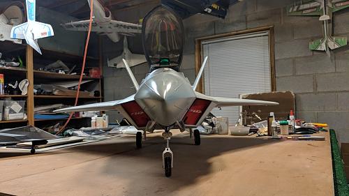

                      #2 is here, now to start on it with all the mods. I have Jeremy's slime light and nav light kit, and some other 3D printed parts. May take me a few weeks before I'm back in the air as I'm gone all next week on a work trip.

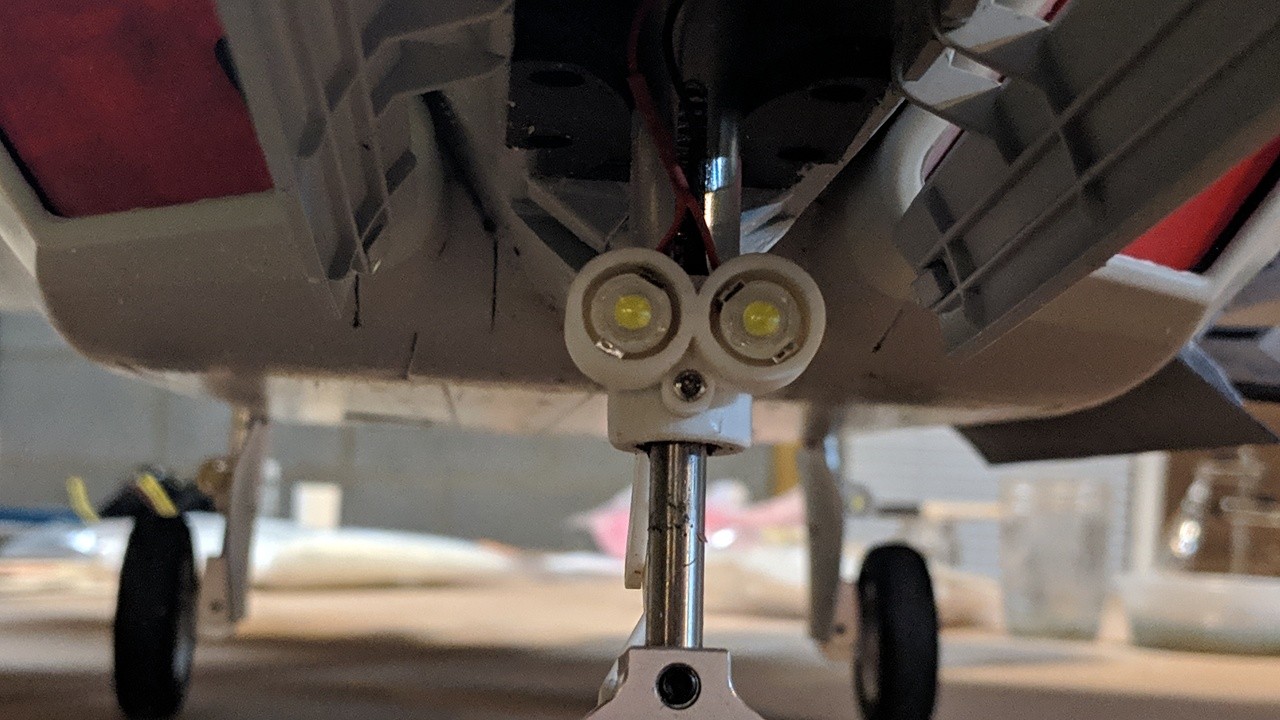

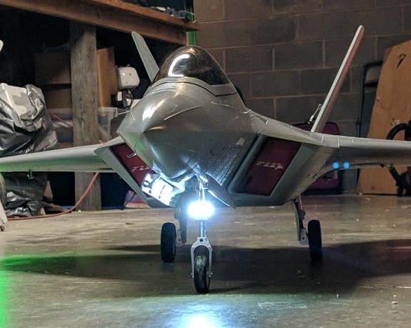

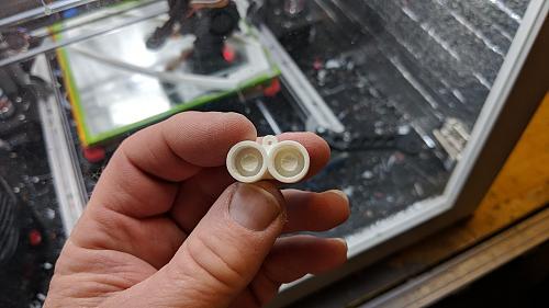

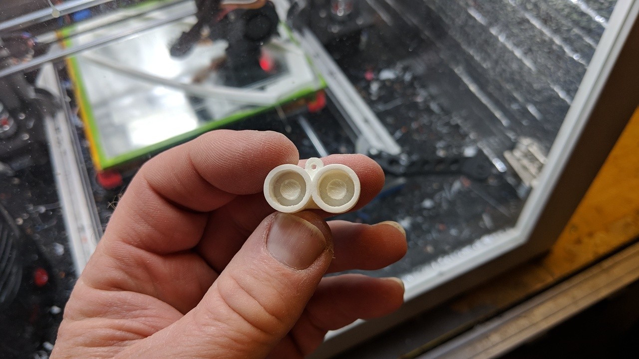

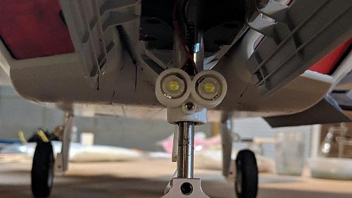

                                          Two 1W white LED's instead of the 5W. Designed and printed a double light housing to fit on the strut.
