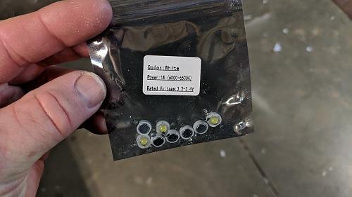

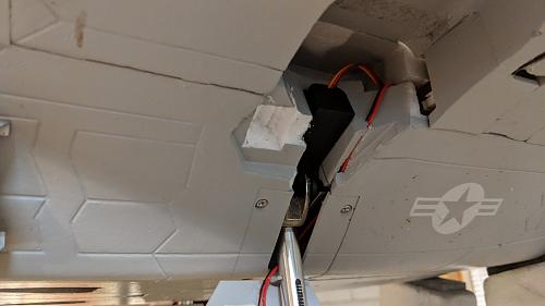

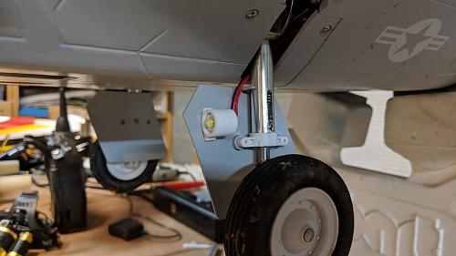

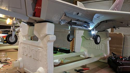

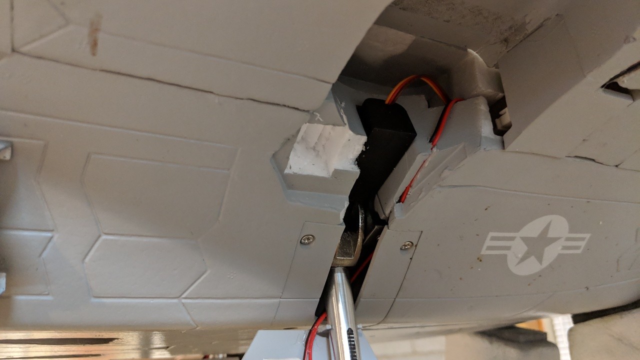

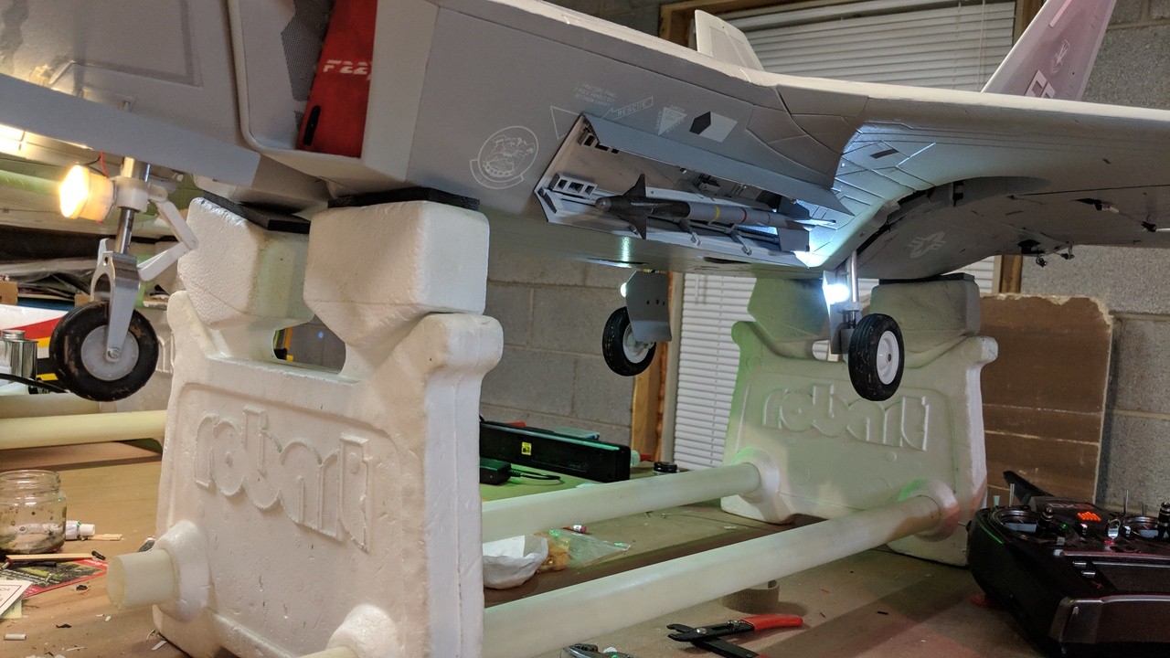

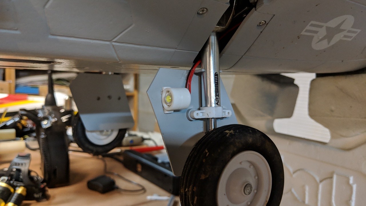

                                      I actually did that to mine with a couple of spare LEDs when I did my lighting system. I told Pat i got glued mine to the bottom of the strut, but I like the door install better.
                                      We fly well after sunset out in Utah for a lot of the videos. The noselights on the jets are so bright when it gets dark that you can’t see the wingtips for orientation sometimes. Even with the added wingtip lights.
                                      When you install the lights down low enough on the gear or gear doors, it creates an angle between them and the nose light when you slow the jet down on the approach to let you know you are on speed, at the right angle of attack even in low light. Like this...
                                      O
                                      o o
                                      See pic at the very bottom and the videos!

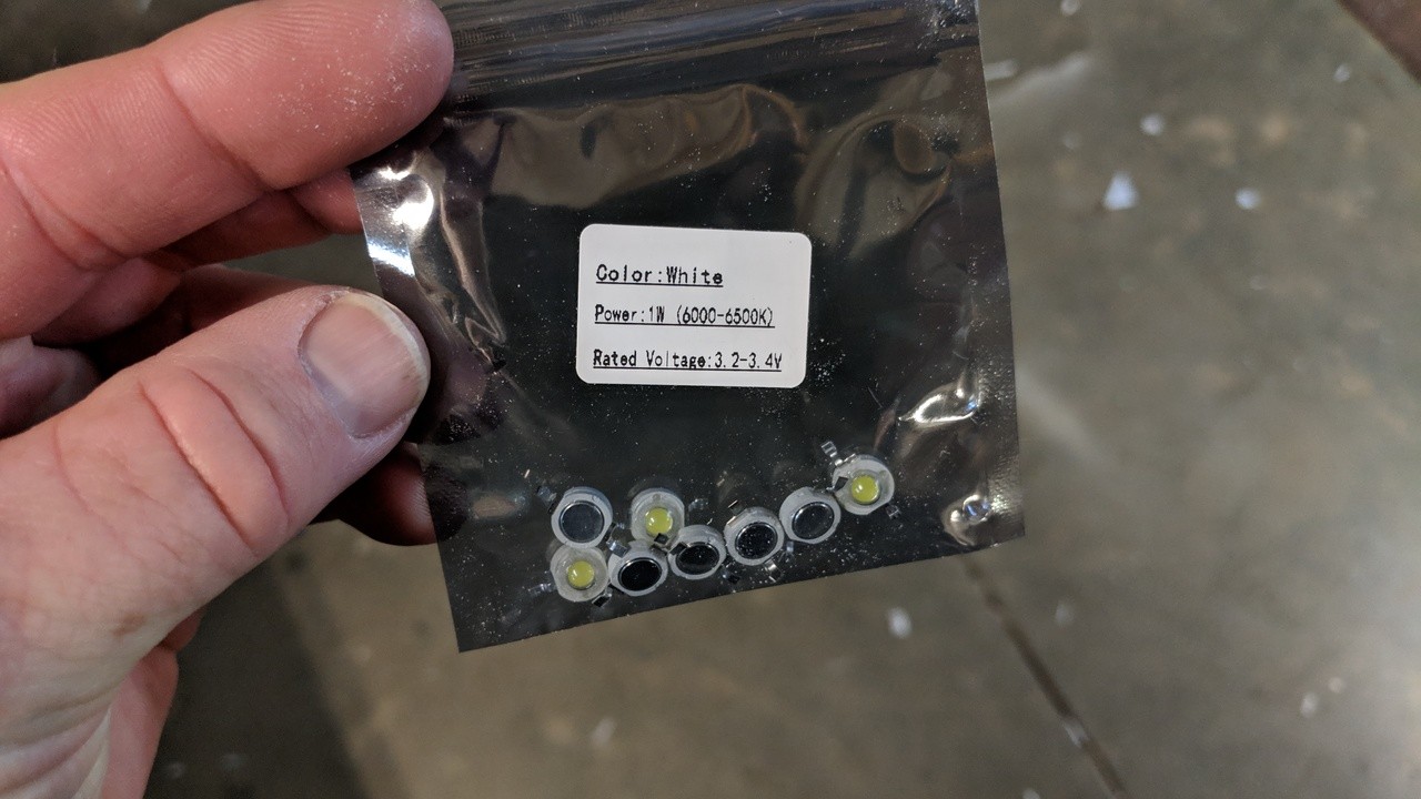

                                      I got some white 1W LED's off of eBay, made some 3D printed mounts for them which I then just glued to the gear doors. I made a three to one harness and just plugged the nose strut light and two main strut lights into the take off light spot on the MCB-E. I then recessed the foam in the wing where the light fit when the gear was retracted. I think Pat did something similar on his.

                                        #1159
                                        I’m having a hard time with orientation below the tree line and want to add lights to the mains as well. I like Steve’s idea but don’t have a 3D printer to make LED housings. Motion carries a single light (in housing) but it looks pretty big as compared to what you guys are using and I’m not sure if I can remove enough foam in fuselage to tuck them in when retracted.
