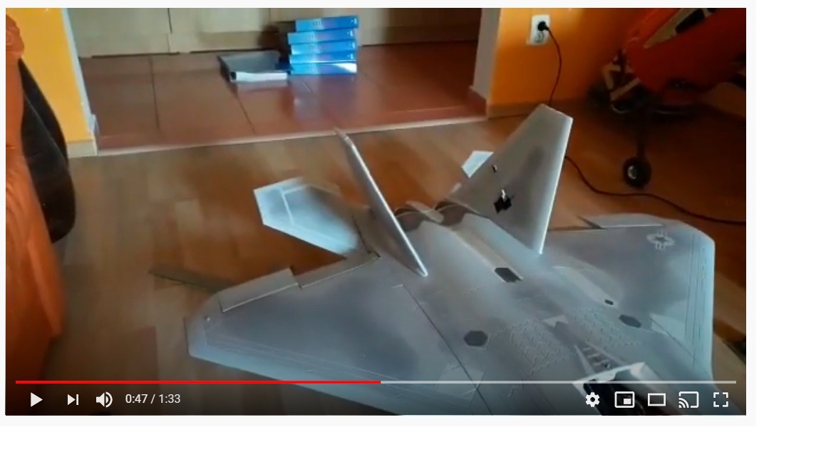

          Waiting for the maiden: https://youtu.be/yoLAHM_zCG0

            The elevator to flap mix you have, down elevator to up flaps, may be counter productive. On normal airplanes flaps cause up pitch or spoilers down pitch. On the F-22 and some jets it's opposite. In your case the up flaps or spoilers may contradict each other. Assuming you added the up flaps to have more pitching effect.

              it seems i made like you:

                Yes, I did it and don't use it because the "feel" is bad... Don't forget I also have TVs that add to my pitching moment.
                  So you suggest me do not use this mix? elevator and flaps. I have to use only elevator ? I don t have TV as you see.
                  Badan Kit - Yak55M 2.8m; EF - Extra 300 2.3m; Multiplex - Funcub;Funjet Ultra2;Parkmaster;FW - F22 90-X45 Xicoy;ROBBE MISTRAL 2.0
                    • 5402
                    #3149
                    Not use or reverse the mix.
                    You can try it both ways to validate my results.
                      This is correct... The F22 likes a little UP EL with flaps deployed.
                        • 5402
                        #3151
                        From a different perspective. Yes a little up compensation because the F-22 slightly pitches down with flaps to keep level. He is mixing flaps to pitch. To get more pitching down flaps with down elevator and up flaps (spoilers) with up elevator would give a slight (very slight) increase in pitching.
