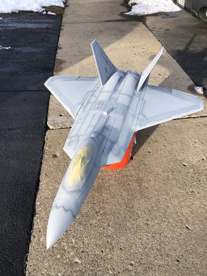

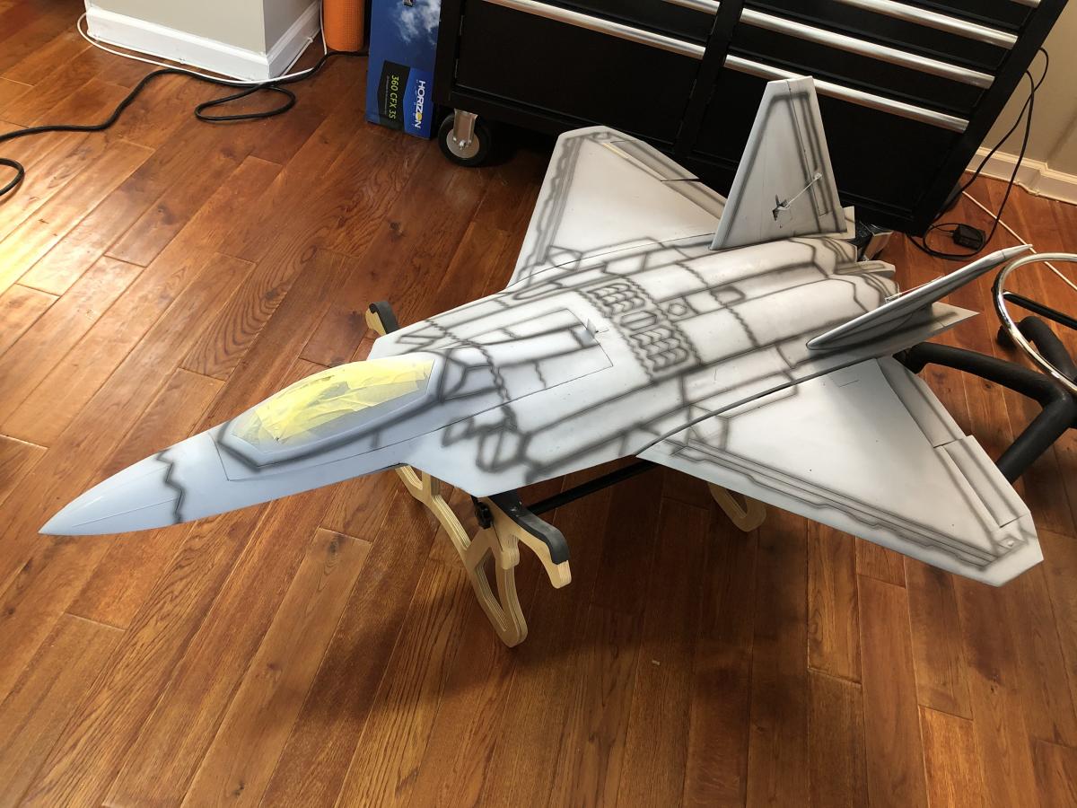

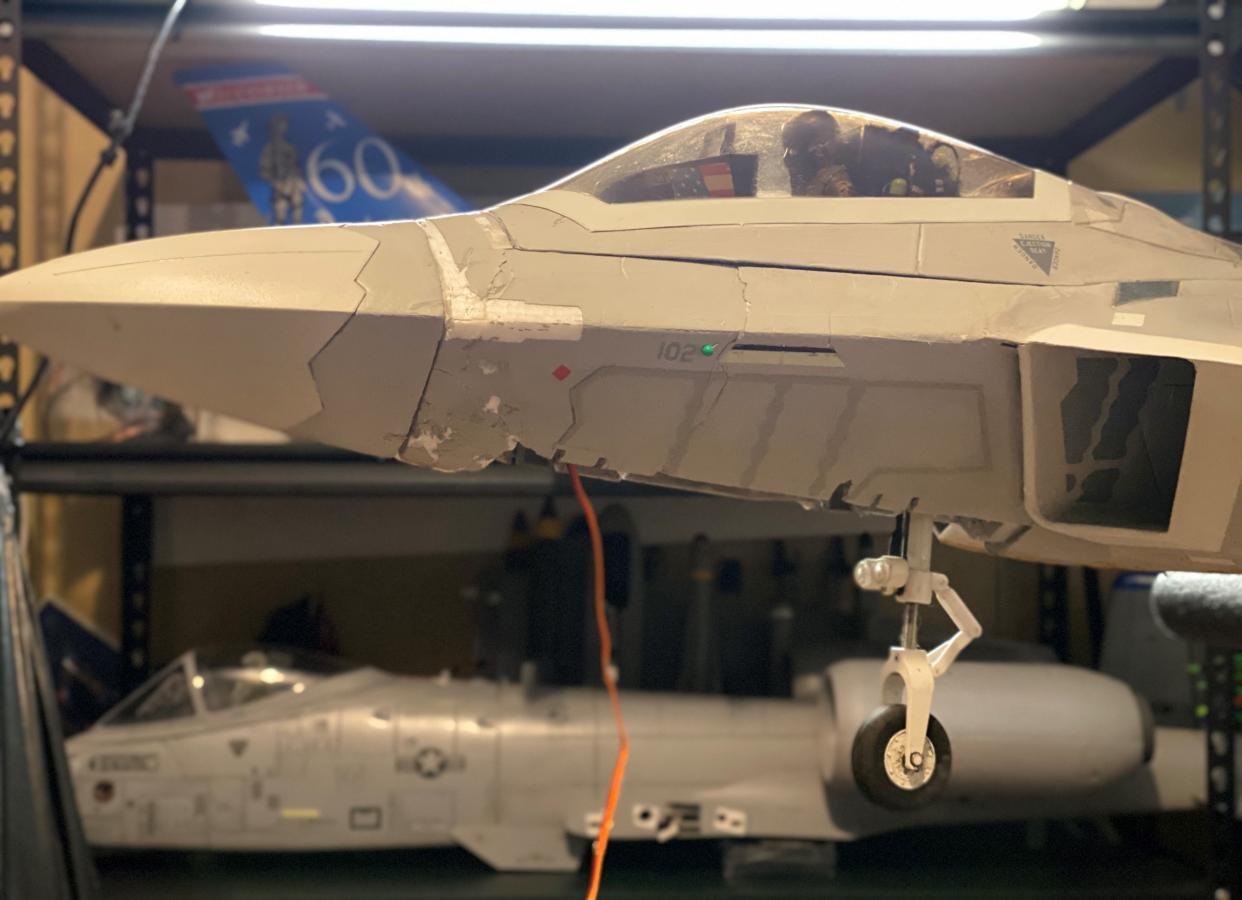

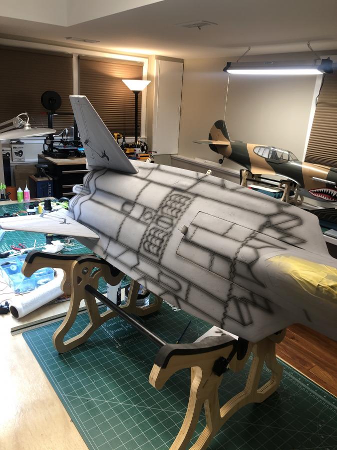

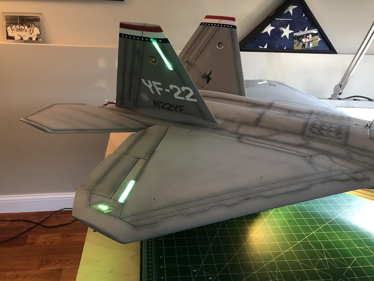

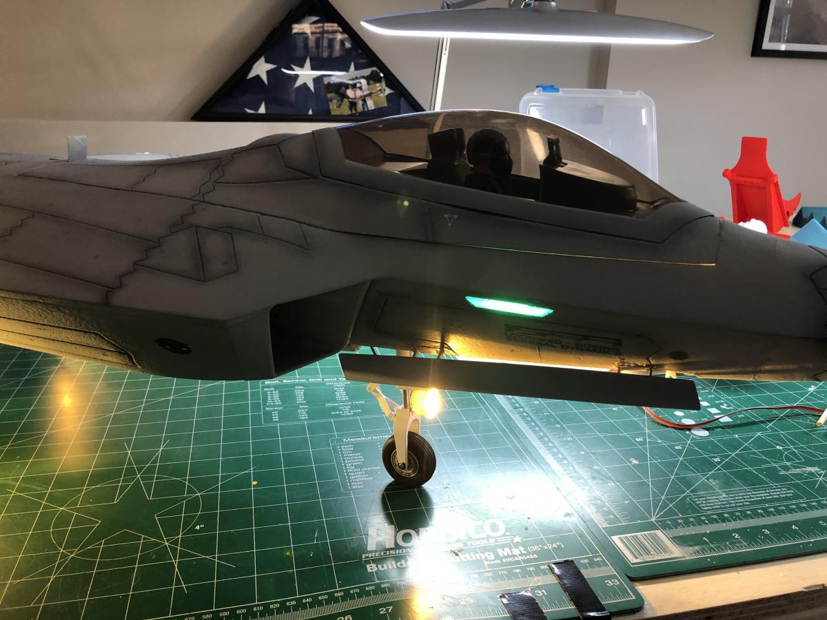

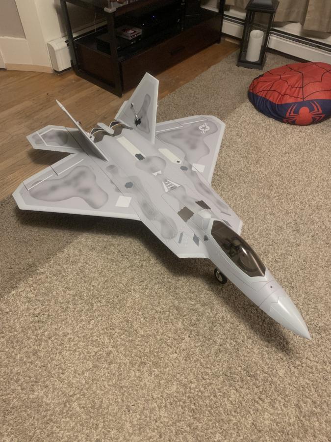

      8S rebuild Crashed prior to Jet Jam 2019...
      Jeremy Solt Light kit
      3D printed wheel covers
      Landing gear lights
      Repaint /Weathering
      Callie Graphincs.

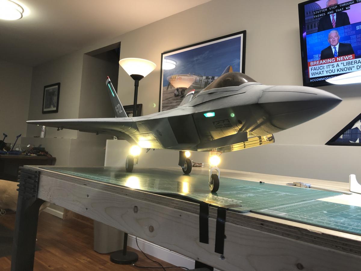

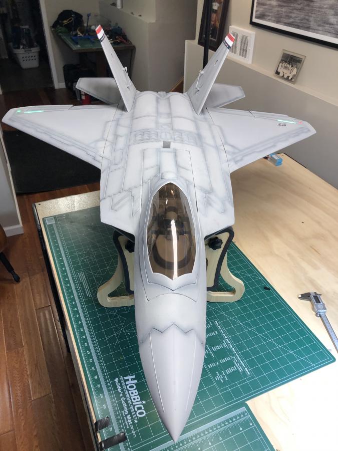

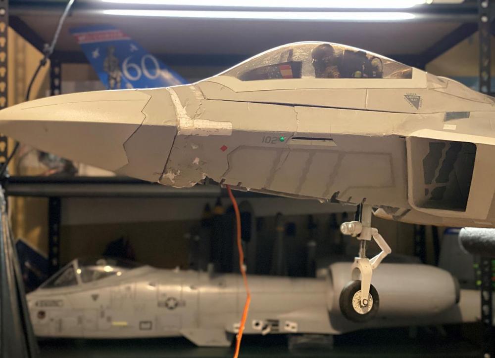

        Landing gear lights
        Repaint /Weathering
        Callie Graphincs.

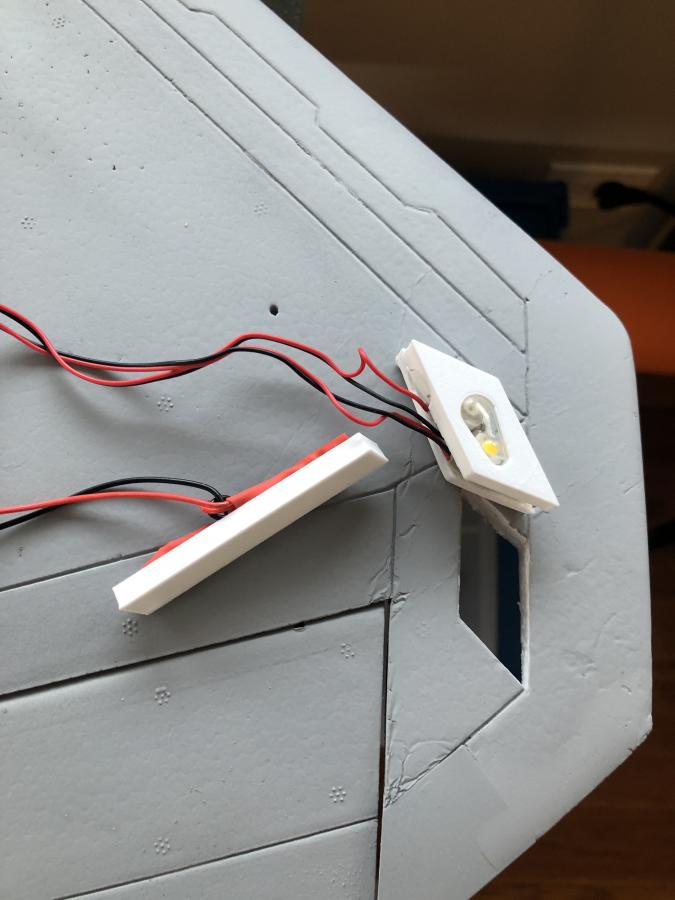

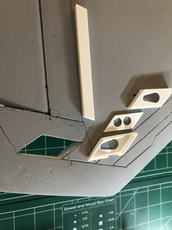

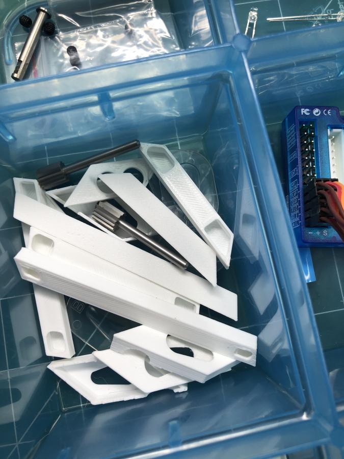

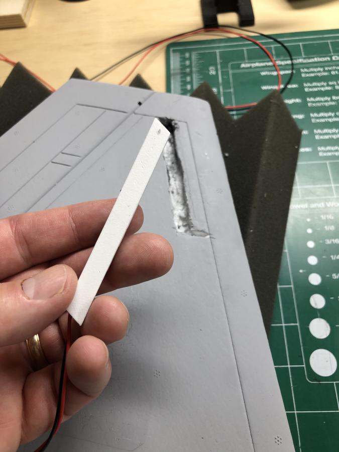

        great work there. any chance we could get some close up shot of how you mounted those landing gear lights..
        thanks

          Sure.... I bought 2 more mounts for the nose gear and slightly modified them( sanded a part off) then hysoled them to the doors... I will take some pics tomorrow! :-)
            Landing gear lights
            Repaint /Weathering
            Callie Graphincs.

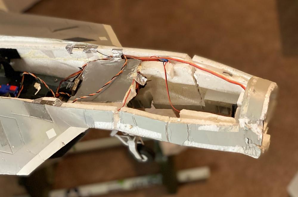

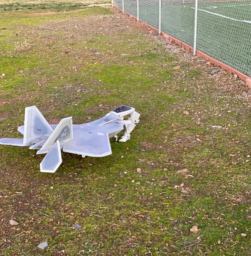

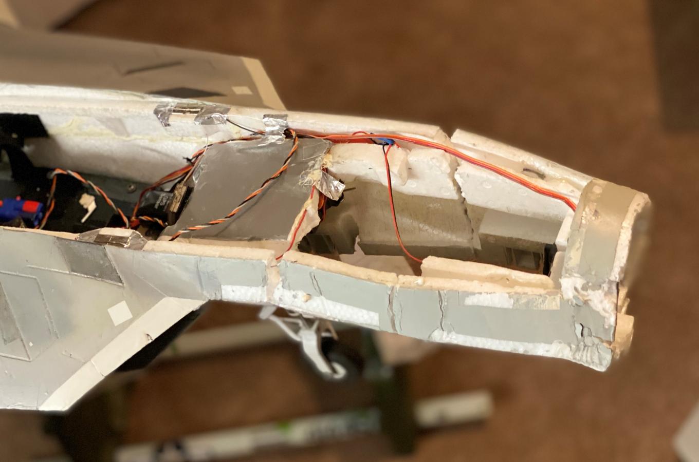

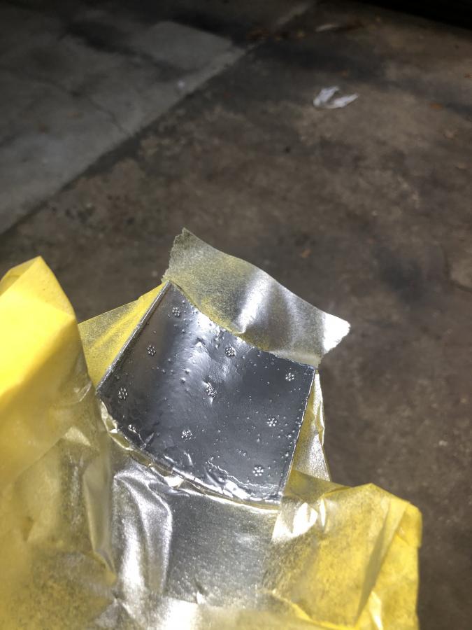

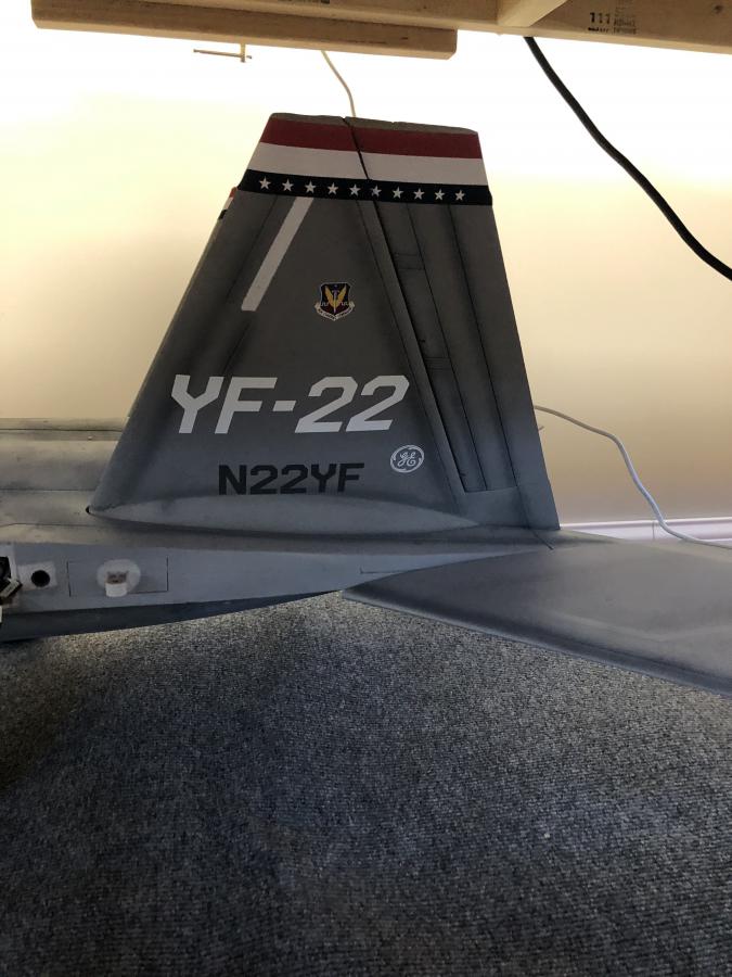

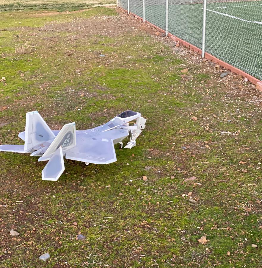

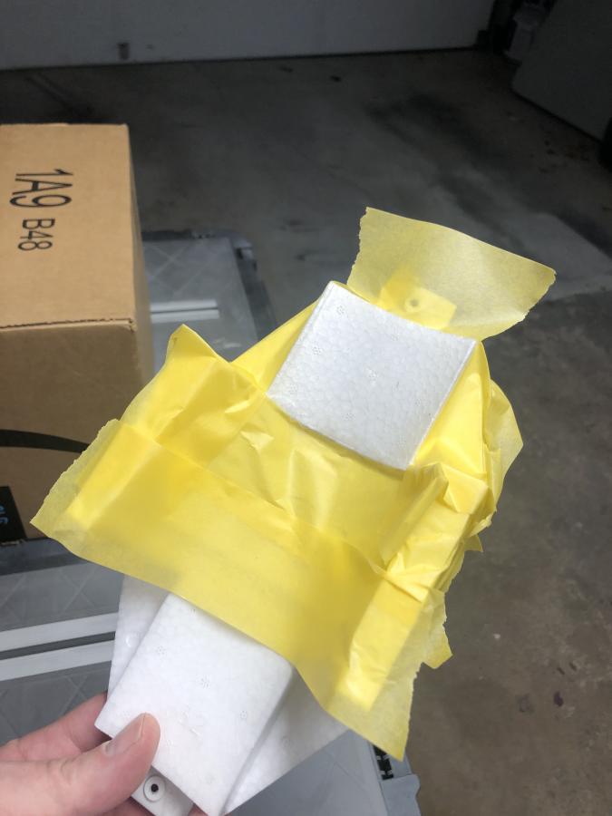

            Good job! I did the exact same mods to mine, then crashed... I rebuilt it with only 1 nose gear door tab needing to be replaced. Was good for a year or so, but I ran my batteries too hard and lost thrust while turning on final. I opted to put the gear up and belly land in a field. Only issue was I lost sight of it while it was about 50 feet above ground. People that saw said the actual tuchdown was great... but it bounced into a chain link fence.
            Its almost completely rebuilt again for a second time... My jet is one from the initial shipment, Which I think yours is too?

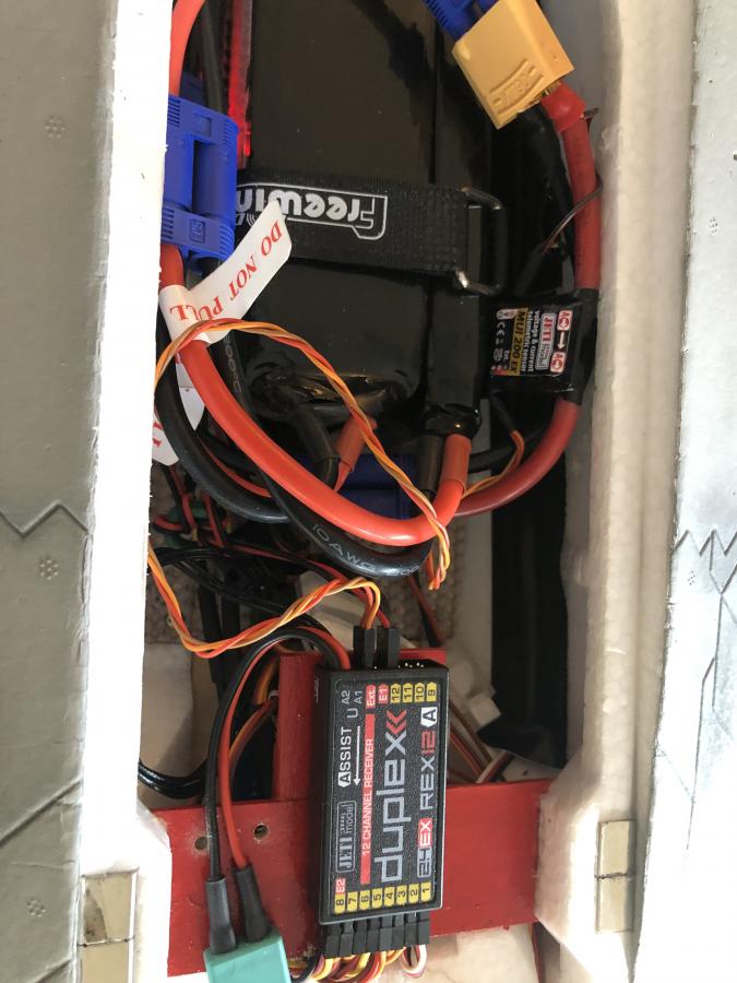

                      #3290
                      I have a pair of CNHL Black series 65c 5000mah 4s to make 8s in series on my 90mm f-22 and fit and weight is perfect. Click image for larger version

                                  Originally posted by Av8er278
                                  I ordered two CNHL 4s 5000mah 55c. That way I can use same batteries in my 4s funjet. They were back ordered on black series batteries. Also are you guys using gyro on this plane? If so which one?

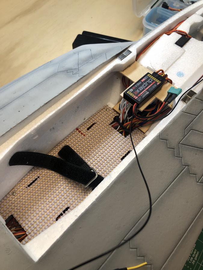

                                  I use a Jeti Rex7A RX. I use the stabilization to take the “bumps” out of the flight from the wind. I assigned the gain on a proportional knob so I can adjust on the fly depending on speed and wind if need be.
