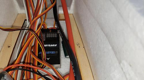

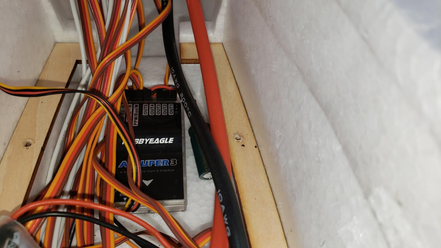

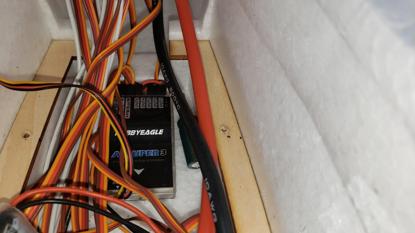

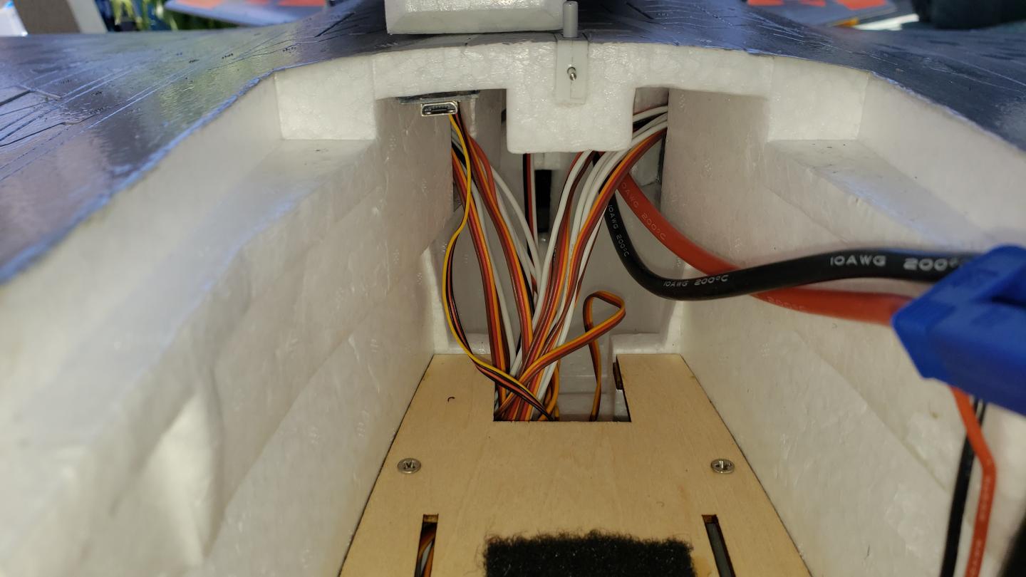

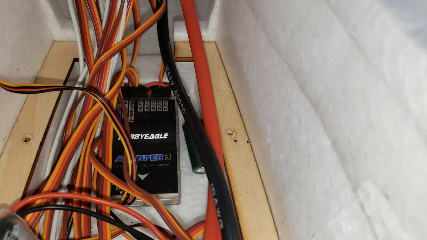

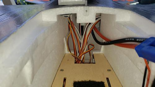

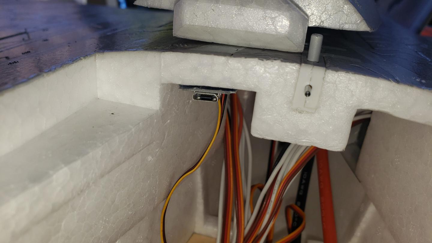

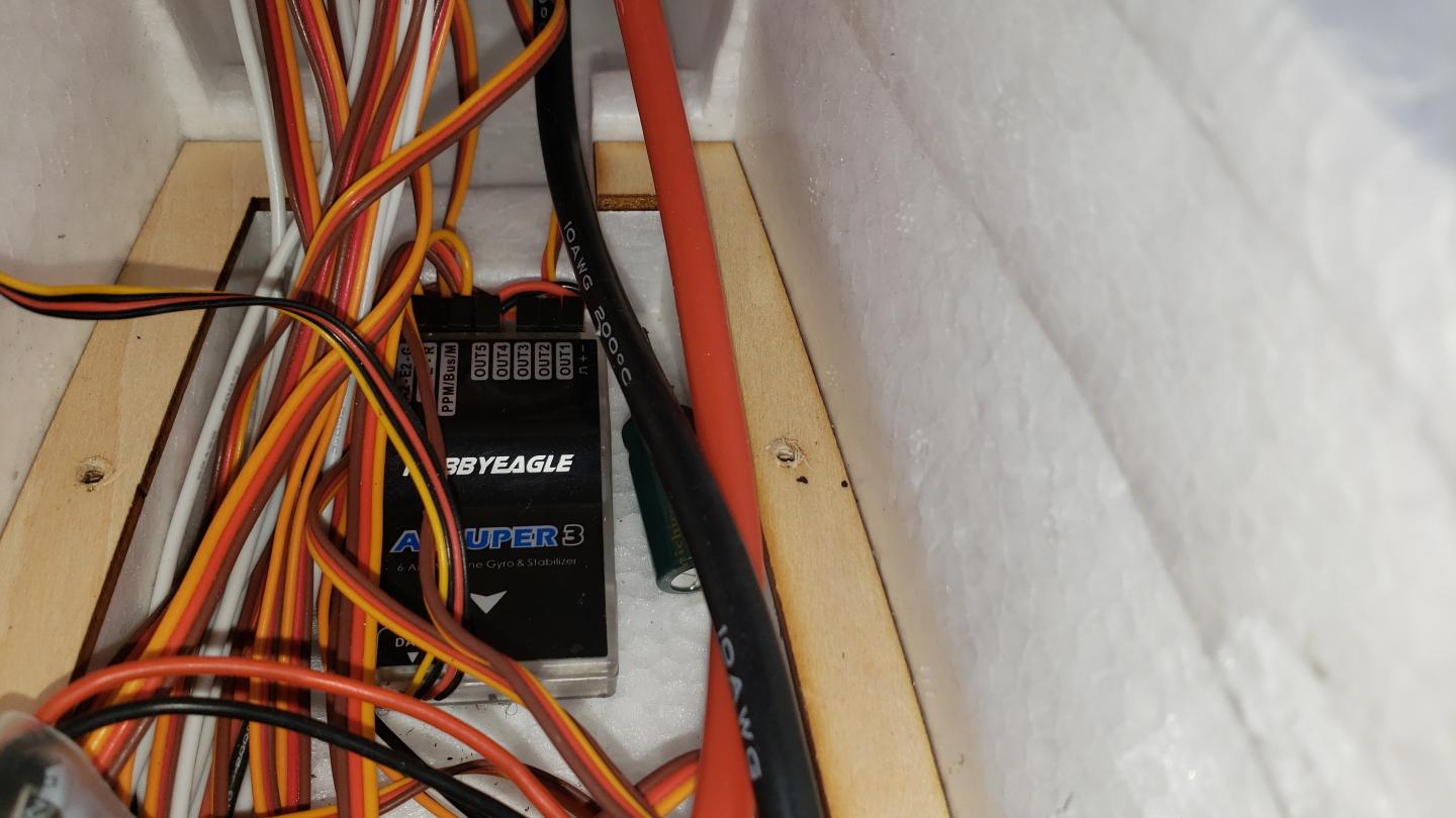

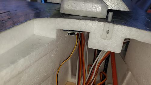

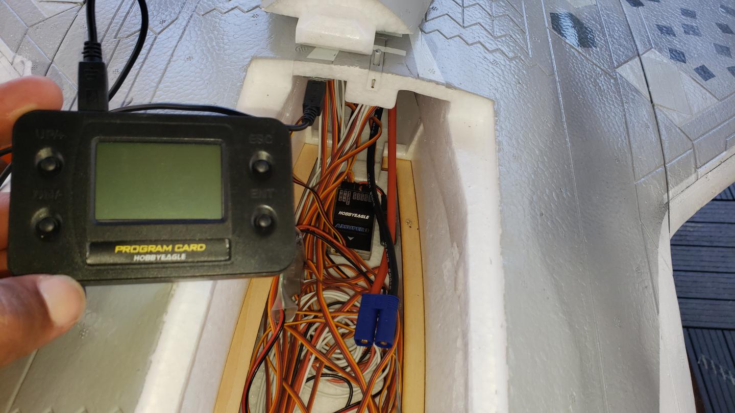

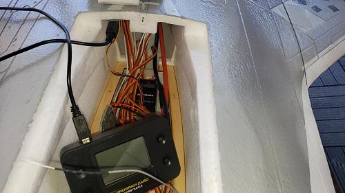

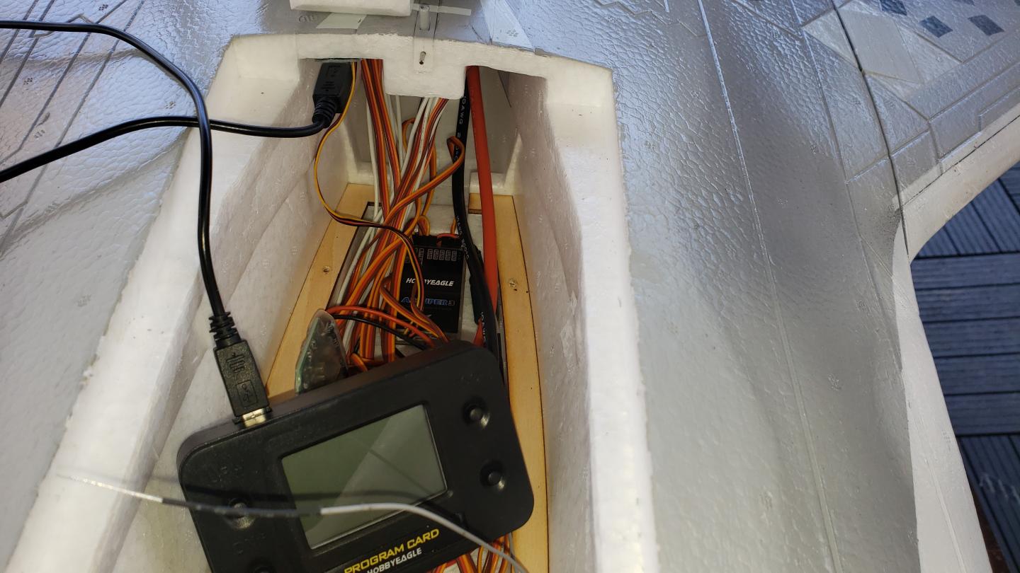

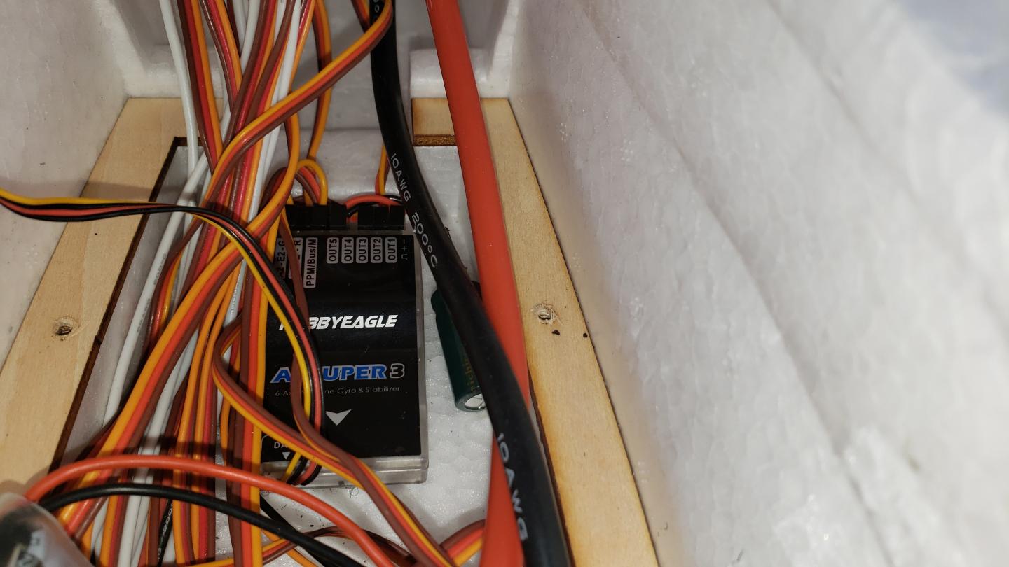

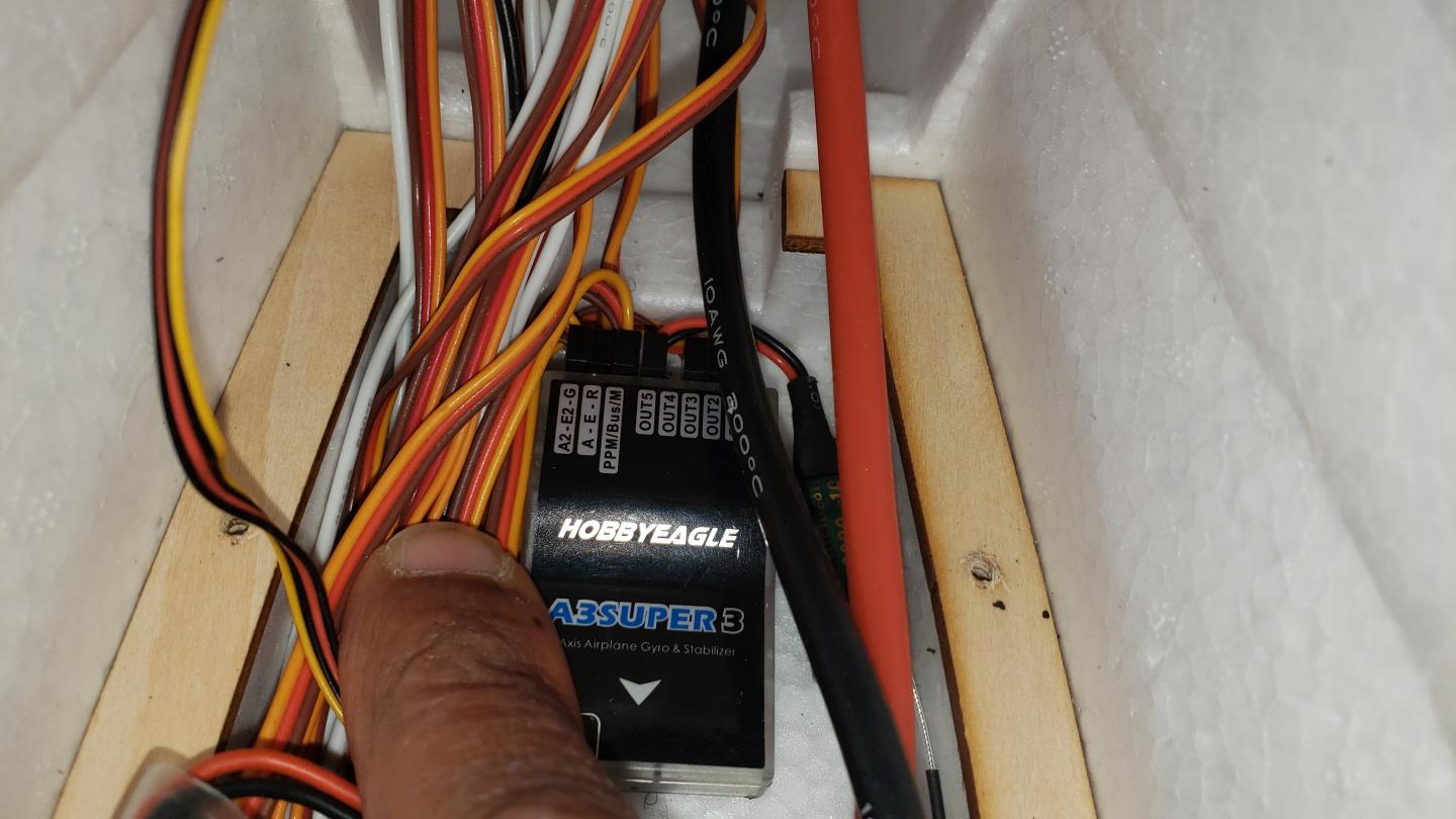

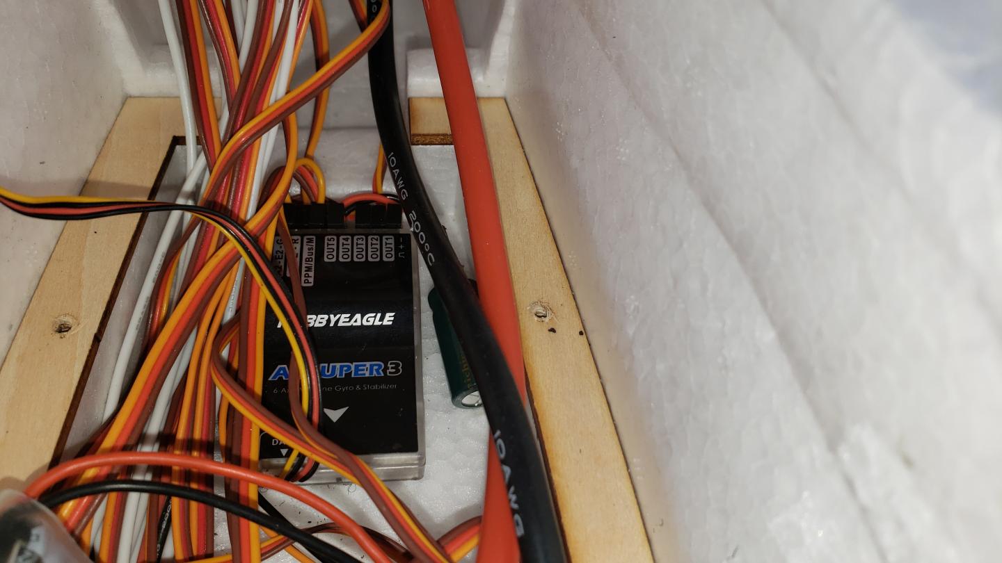

                  I just wanted to show how I put in the Hobby Eagle A3Super3 in my Raptor. I have had no issues. I have my gain on a knob and 3 different flight modes on a 3 way switch on my Futaba 8J so I can adjust it remotely. It's not needed but it does make this bird all that more enjoyable to fly under less than ideal flying condition. I have a A3Super3 in all my larger EDF's and it just performs well. I also show where I have the connector lead. Since the Gyro is under the battery tray it's out of site but I can still connect to my program card or PC if need be. Enjoy.

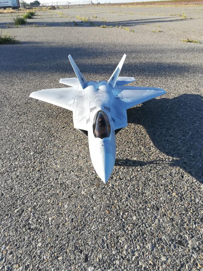

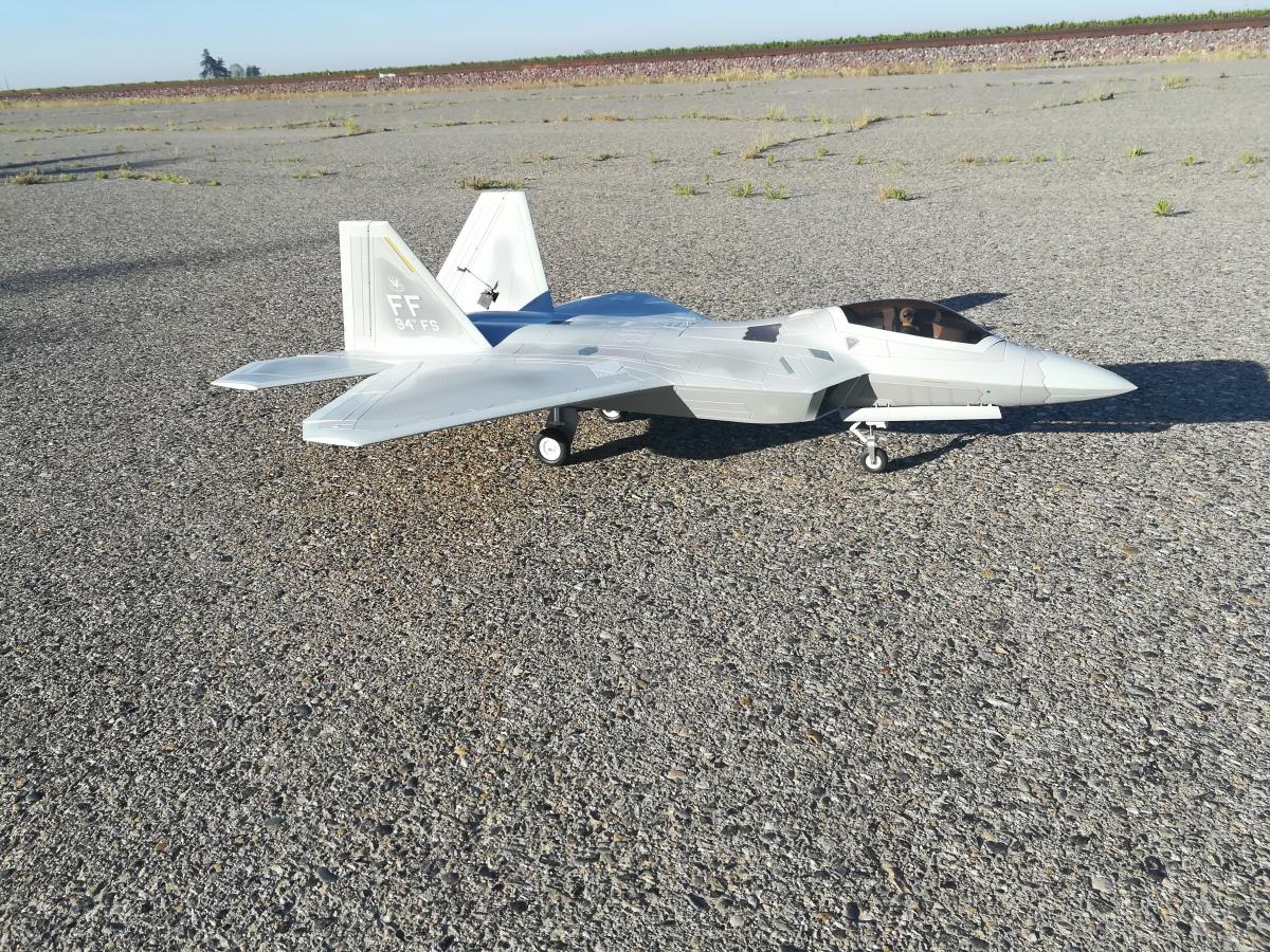

                            Finally caught a break in the weather and got the grass runway prepped for EDFs. Maiden +2 on the 6S Raptor.
                            Thanks to the developement team and Motion, it was another stress free EDF experience.
                            She has a very wide flight envelope and is just a joy to land. :Cool:
                              #2294
                              Congrats! :Cool:

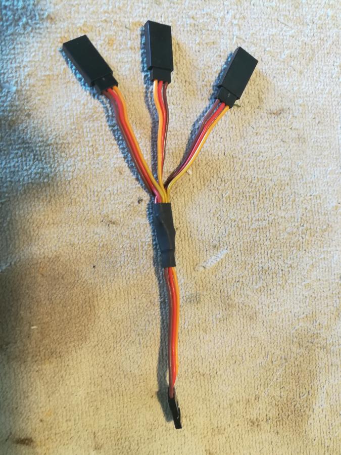

                                      Didn't know you could do that?
                                      I just plugged the mains into a triple Y harness and plugged that into my RX, then plugged the single landing gear lead coming from the blue box into the Y as well, this way the nose gear has the delay for the doors but still goes up a little bit slower than the mains, looks awesome when you rotate and hit the switch, gear goes up right away.

                                        I would be very interested in that myself as I don't have any triple y harnesses. I could probably solder one but changing the time delay would be the max.:Cool:

                                          I get my triple Y harnesses from MRC, I bought 10 of them last time and only have 2 left, I have found them to be very useful.
