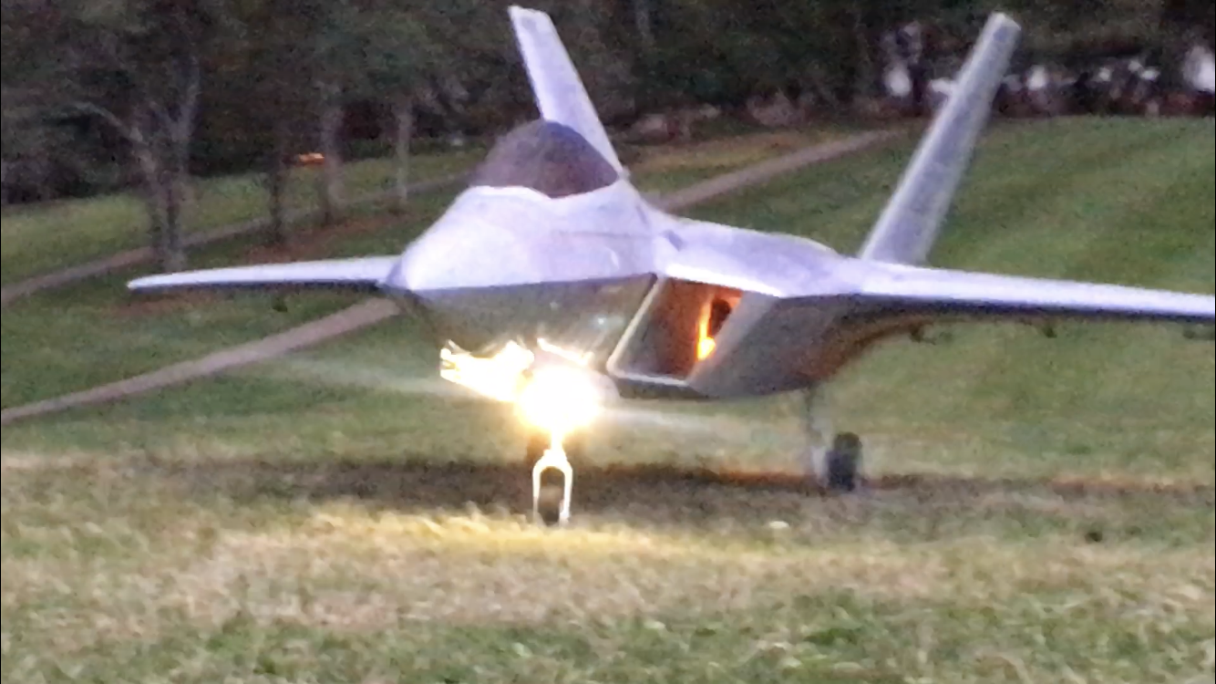

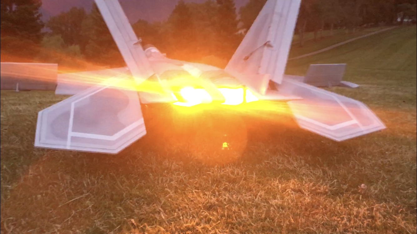

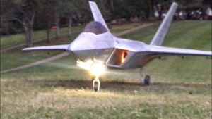

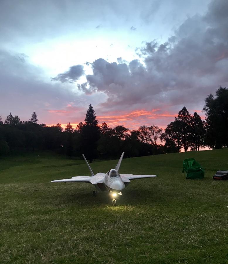

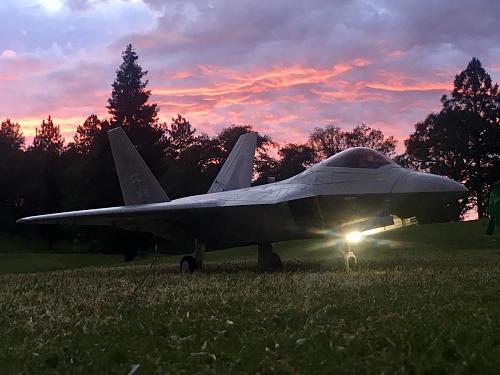

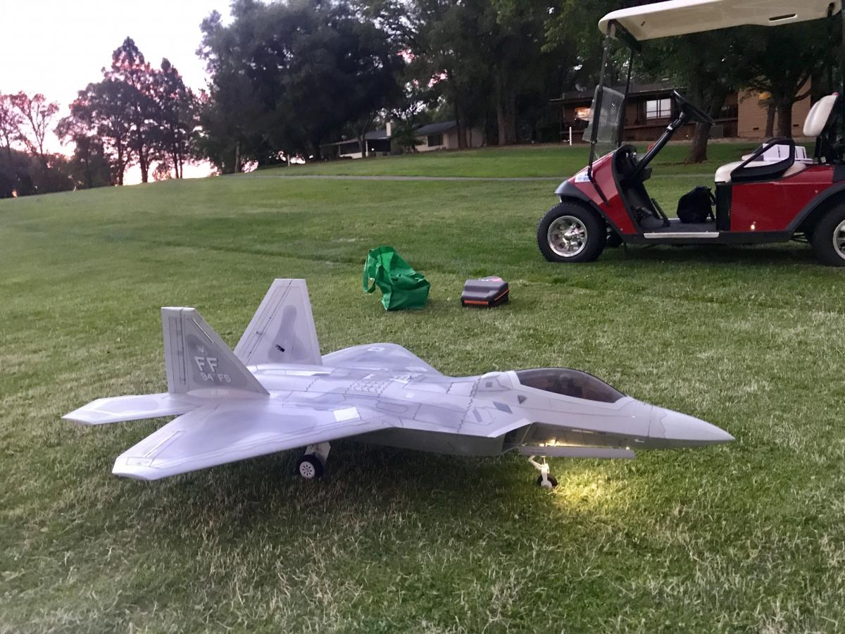

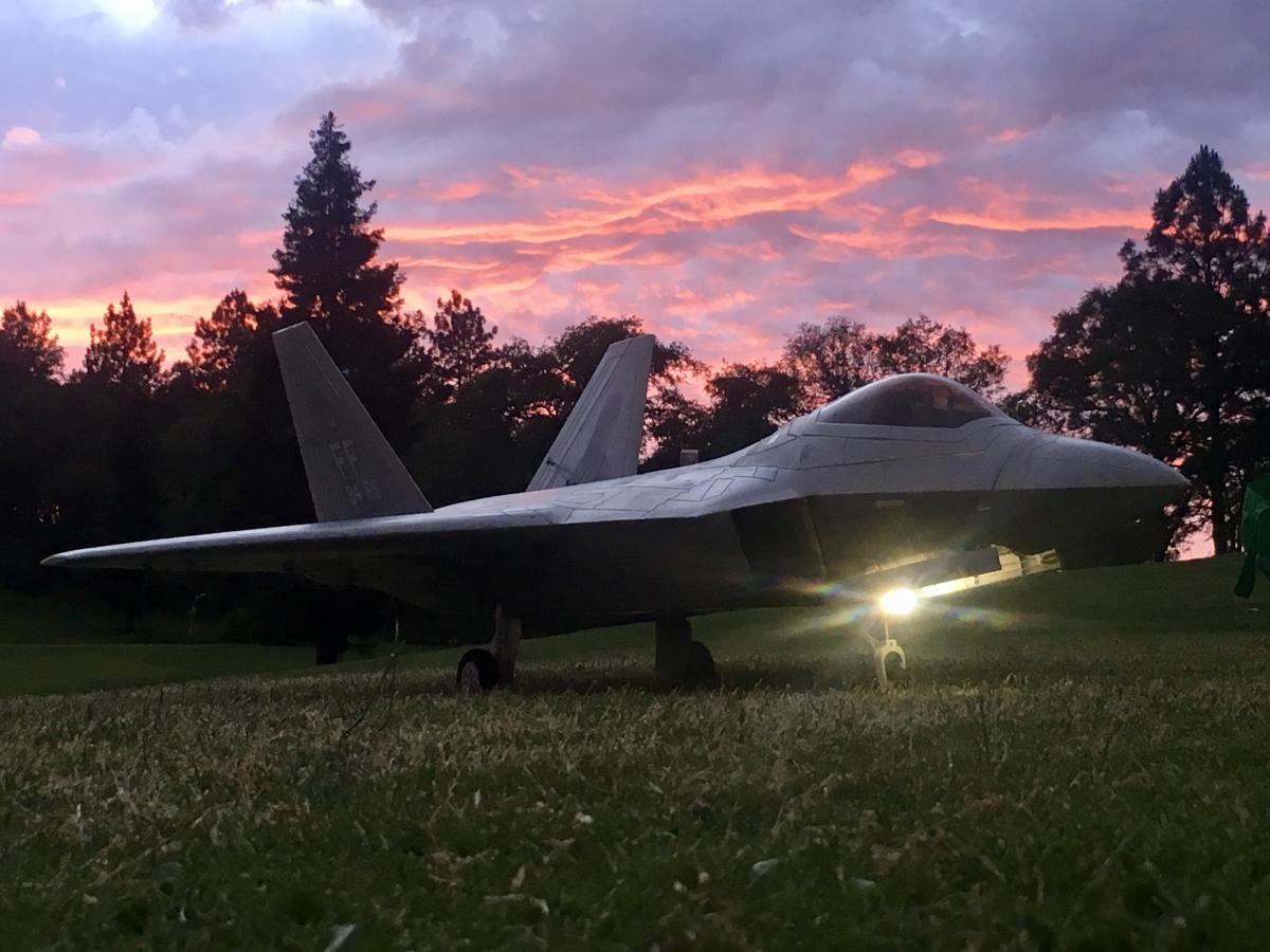

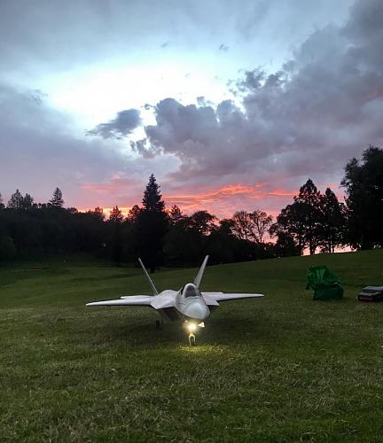

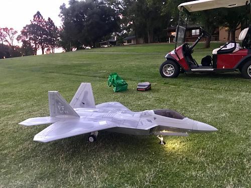

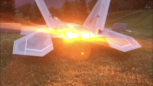

                    Too cool of an evening not to post. Unfortunately the camera lady was throwing a ball for a dog... next time I’ll have her record. She made up for not filming by taking the majority of these pics, including the RC Geek "Centerburner" with aluminum ducting tape while on her stomach ;)
                    For the people that ask about flying on grass strips; this is the lowest the grass has been cut all season and I am currently running the 9 blade outrunner on 6s. The plane does great! Even with the smaller nose wheel and larger batteries than usual.

                      Nice dusk sunset shots!

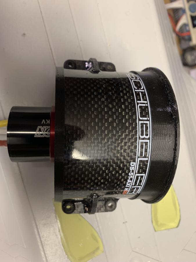

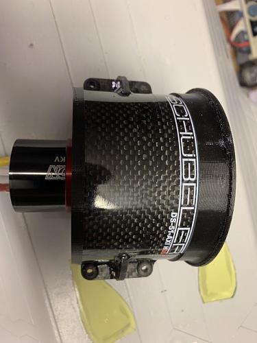

                              After approximately a dozen flights with the 6s fan, I’ve installed a Schuebeler HDS Fan with a HET 700-68-1400 motor. The motor can take 8 or 10s. While 8s is fine with low Amps, 10s is awesome. Here is a ‘Hatcam’ video of one of today’s flight. Top speed according to my Multiplex GPS Sensor was 238km/h (147mi), no signs of airframe over-stress. Note that I’ve closed the two ‘cheater holes’ on the bottom.

                                That adds some horsepower! :Cool:

                                      Going from 6s to 10s is a rather significant jump. Definately feel a huge difference in power. Must be awesome.
