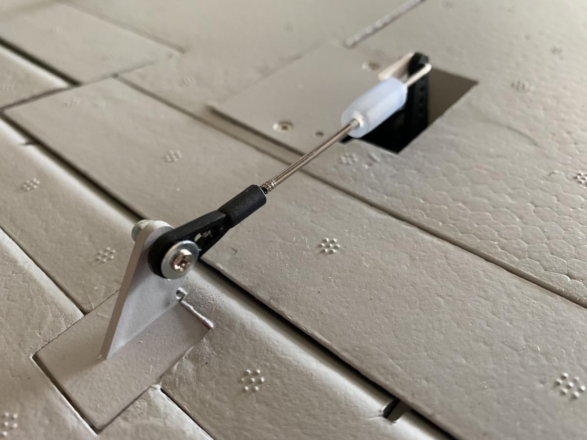

                              I also did this
                              metal washer under the screw and over the plastic.(so the clevis cant pop off the ball and fuel tubing over the plastic clip for good measure

                                The added safety of the washers and fuel tube are excellent ideas.
