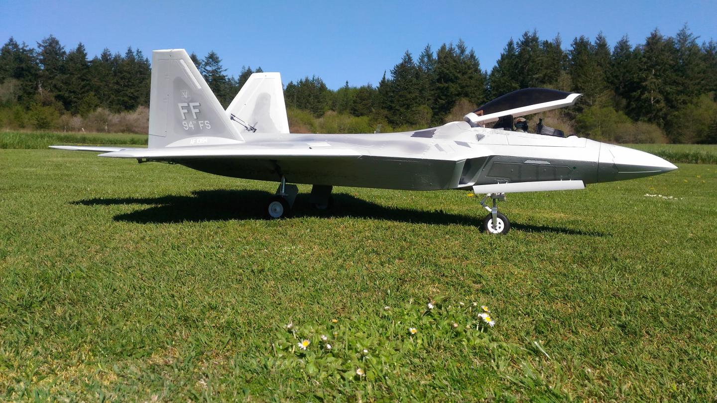

          Alright, I am going to level with you guys . We RC guys,at this level, have two hats. The builder of the plane and the flyer of the plane.Today the builder of the plane blew it in a major way, me, and the flyer of the plane, me again, did everything he could to compensate for the builder. Here's a shot of the plane before the maiden. Twothirds of the stress we feel on the maiden is due to wondering if we overlooked something and onethird is due to wondering whether we can react fast enough to compensate for the other twothirds!! Anyway, thought I had everything covered but on takeoff, to my horror:Scared: realized that I had not set the ailerons to factory settings like the other surfaces, and had way too much throw on the ailerons and not really enough,by the book, on the elevators. It was a struggle to maintain control and the flaps made it even worse.:Scared::Scared: Long story short, I crashed on landing. Had to do the "walk of shame". Tore out one main gear and bent the foam pocket for the nose gear back and tore away part of the port inlet shroud. Several other minor issues. Already fixed most of the problems but the nose gear might be a challenge. Wish you could buy separate ailerons without buying the whole wing. Any way, I see from parts orders on this and many other MRC planes that people tend to just quietly order replacement parts, me included, without admitting they crashed or damaged one so I had to come clean. Luckily, none of my mods were effected.:Cool:Click image for larger version  Name:	P_20190420_153717.jpg Views:	0 Size:	268.2 KB ID:	191193
            #2265
            :(:(:(:(:(:( It will be OK, but my heart is with you Bro...…….. :Cool:

                Ah Brad sorry to hear that my man. Ugh. I know all the work you put into her before the maiden. I guess the one positive is that it's not a total loss, that you can have her back in the air with a part or two....I feel your pain brother!!

                  Thank you, Thank you,Thank you for the kind words my friends. I'm over the initial shock and now thinking of how to move forward. Parts vs fixes. Amazing how one dumb oversight can make the difference between sad and happy landings. I may have to wait 'til I've paid for the shipping on the P-38 and the P-51 before more parts can come.
                            That's a huge drag Brad- sorry it happened but glad it wasn't worse. Two things come to mind:
                            A checklist can be really handy, especially with a new model about to be maidened. Write down what's been done and what's left to do; just jotting stuff down can be helpful in avoiding missed items. That said, mine has yet to leave the ground so who knows what I've missed...:Thinking:
                            Regarding the damaged nose gear mounting area, I wonder if this would be an ideal opportunity to move it back to the scale location (~3.5"?). F106DeltaDart has been working on that with his, maybe he can chime in.

                                          Hey Tom, I'll be interested in what F106DeltaDart comes up with. I'm trying to avoid replacing the fuselage....mainly because I would have to do allot of wire routing for the formation lights and reinstalling the ones below the cockpit. The starboard aileron is pretty beat up too but MRC doesn't sell replacement ailerons......just the whole wings as a pair.
