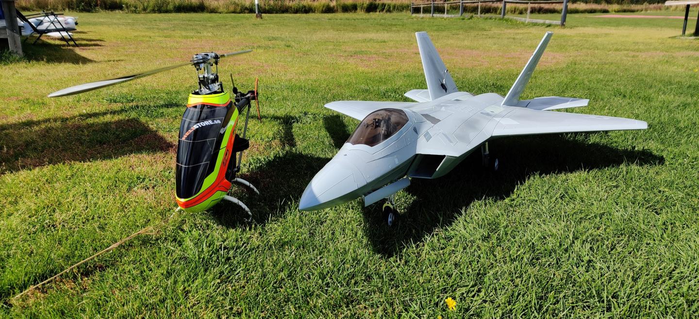

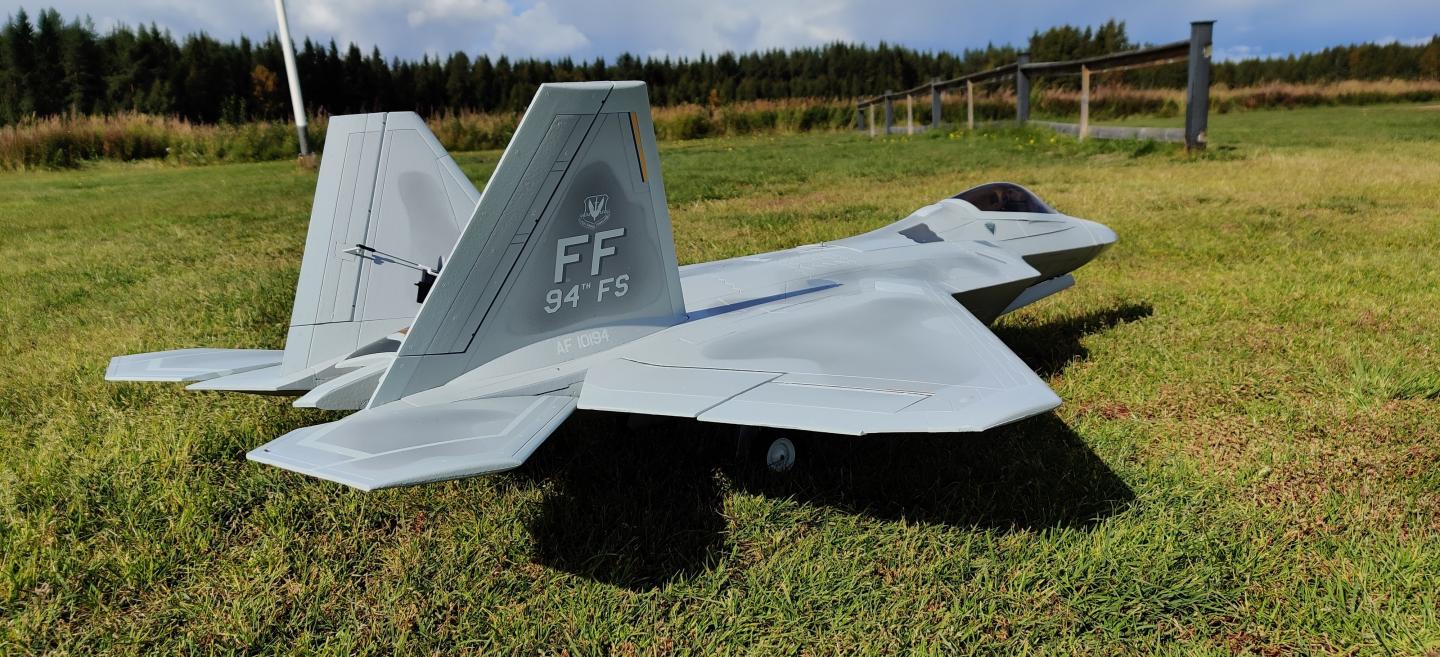

                  • This was from late this summer. We have entered the cold winter and I'm looking back and getting excited for the next summer. Any idea what fun i can mod this or make better this winter? It's the 8s version i might add. Click image for larger version

                      • Paint the servos to match the plane, add lights, add TVs, do programming for full span flaps, ailerons, tailerons, crow and rudder airbrakes.

                          Man I would love to see the flight videos of this beast. It sounds like a fun machine

                            Thanks for the tips i sure will do. I just bought a V-bar controll and planing on using the V-plane setup, I'm not sure I can progra all surfaces. Anyone flying vbc and vplane?
                            I love going at medium speed forward and push nose upp, and then thrust full power vertical, and then pull forward stick forward. Looks exactly like the scale one and i get goosebumps, haha
