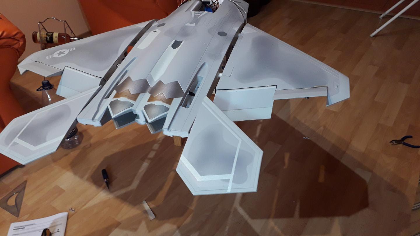

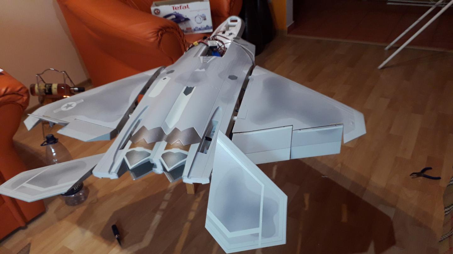

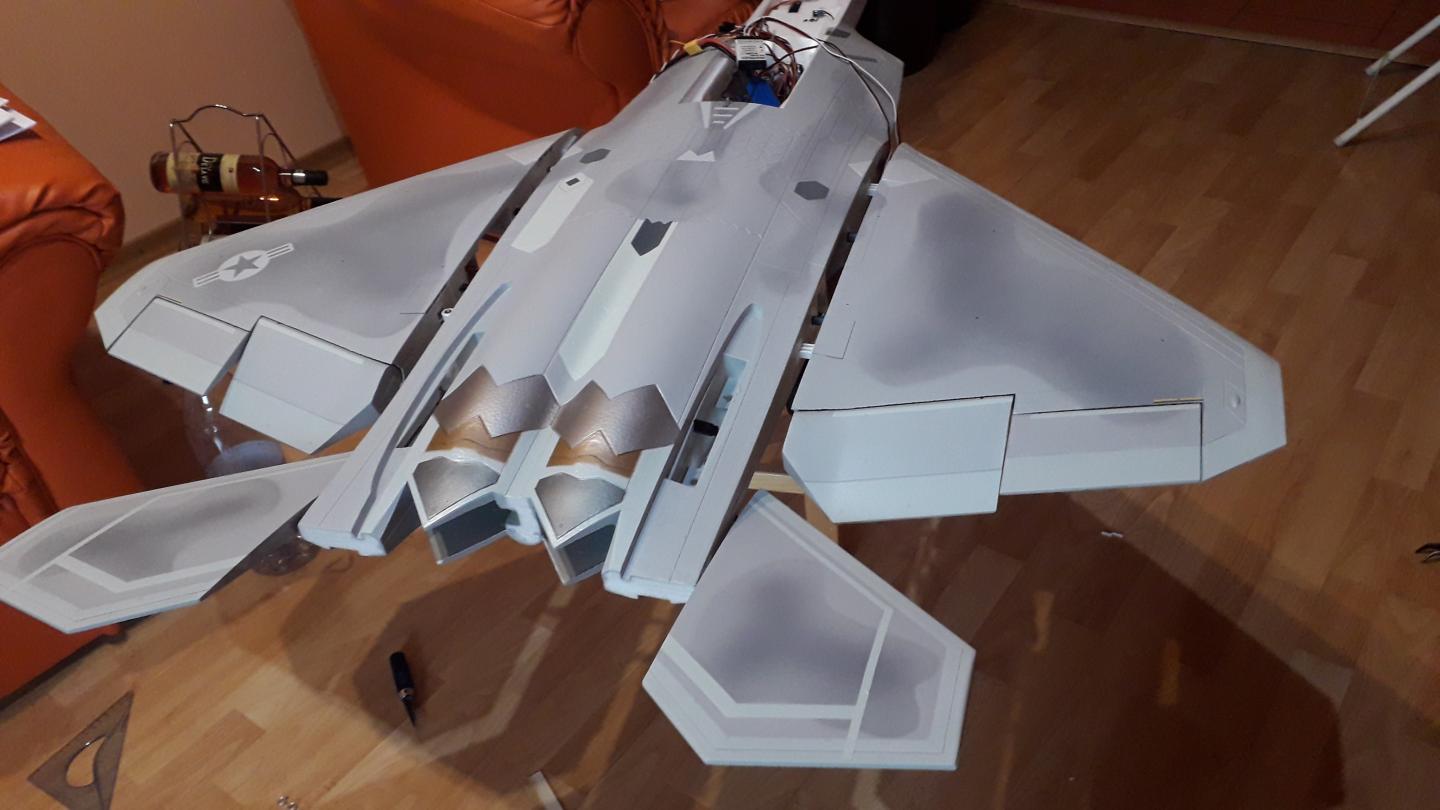

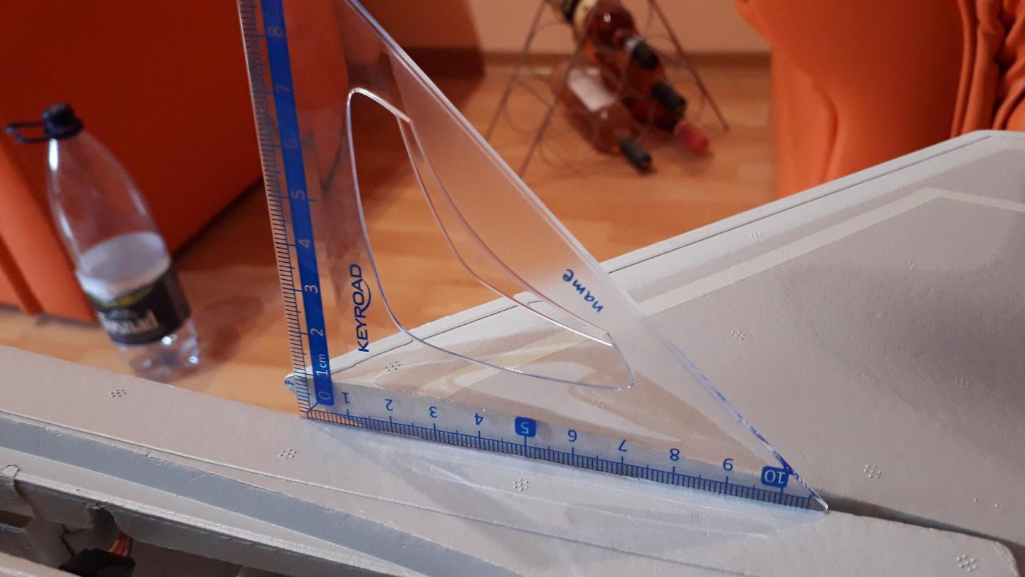

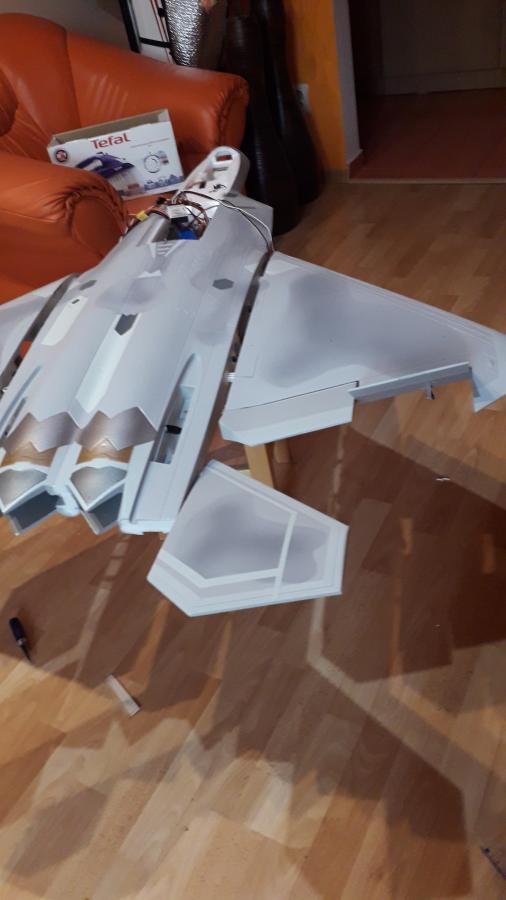

                        #3131
                        Tks Evan, I made today some mix for my plane like in the pictures. It is almost like yours but for the crow without rudder, no ch on my actual receiver, but i guess will be no problem. It is the correct setup for the elevators? In my opinion seems too much. On the other hand, Evan, can you tell me what values do you have to your mixes? I 'm interested about how much elevator do you have for the full flaps? and for the crow too.
                        I made these mixes: take off, flaps 40% and all surfaces at 50% travel; normal flight 90% expo 90%; and if the throttle>50% all the travel are reduced automat at 50% (in my mind at full speed i don t need much travel)..landing flaps 65%.Aftter my batteries will arrive i have to make the cg and after that the maiden.
                        I will keep informed!! :)
