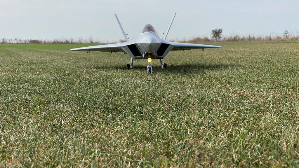

                Today was a beautiful day at our field! I made the maiden, 2 flights! First with the CG exactly where it is recommended by the factory, tail heavy, flaps and elevator down, not good setup at the end the plane stopped in the bush, but in one piece!!
                Second flight battery moved forward, much better, but when i wanted to land, flaps in position without elevator, and the plane drops down, so at the end i landed without flaps.I will make some tests in the future to see what it the best choice. Over all nice plane and easy to fly! Click image for larger version  Name:	WhatsApp Image 2020-10-03 at 17.14.59 (2).jpeg Views:	0 Size:	210.4 KB ID:	278575

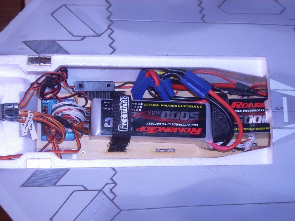

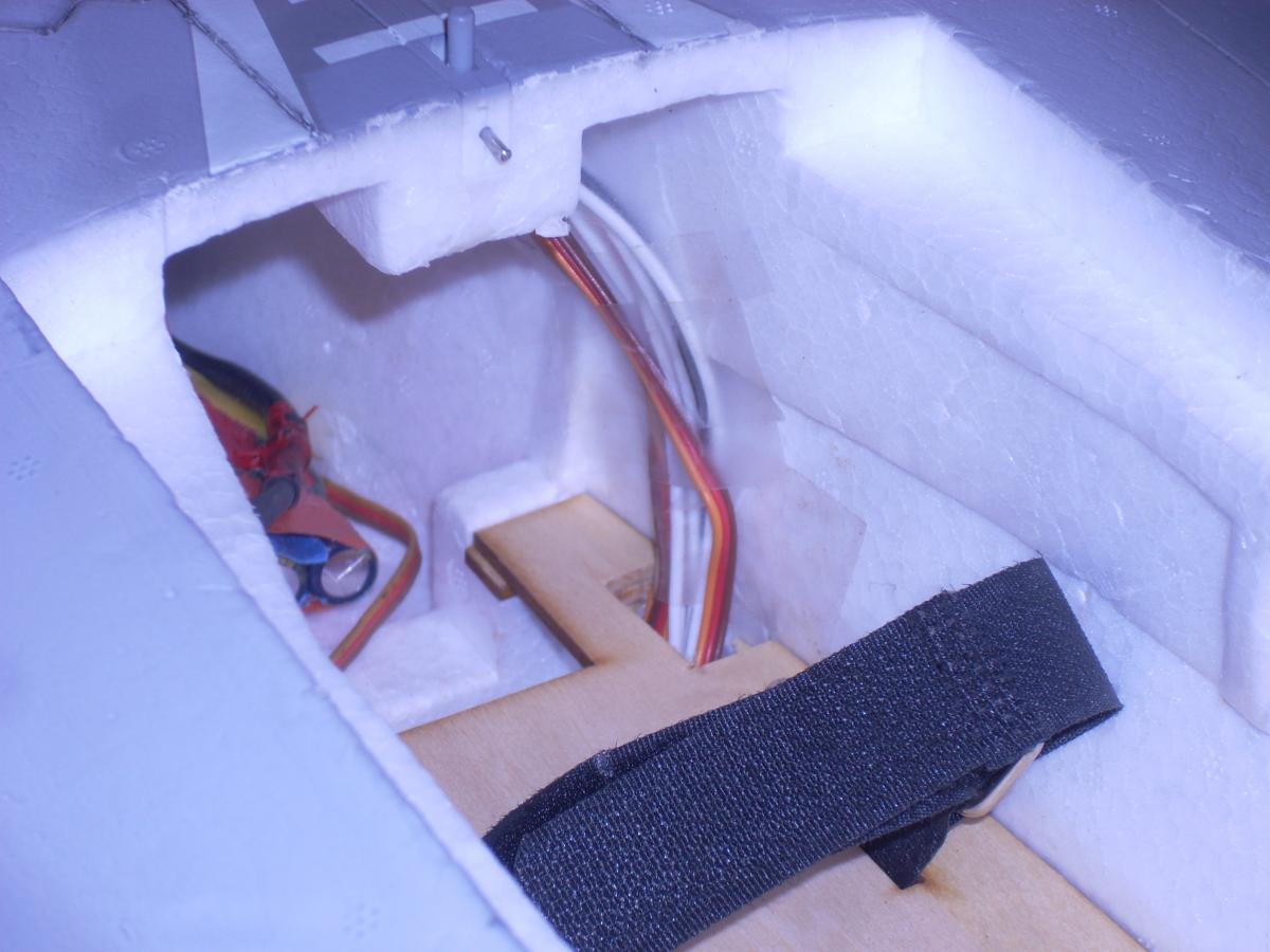

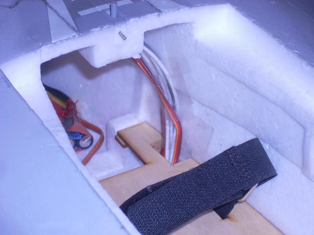

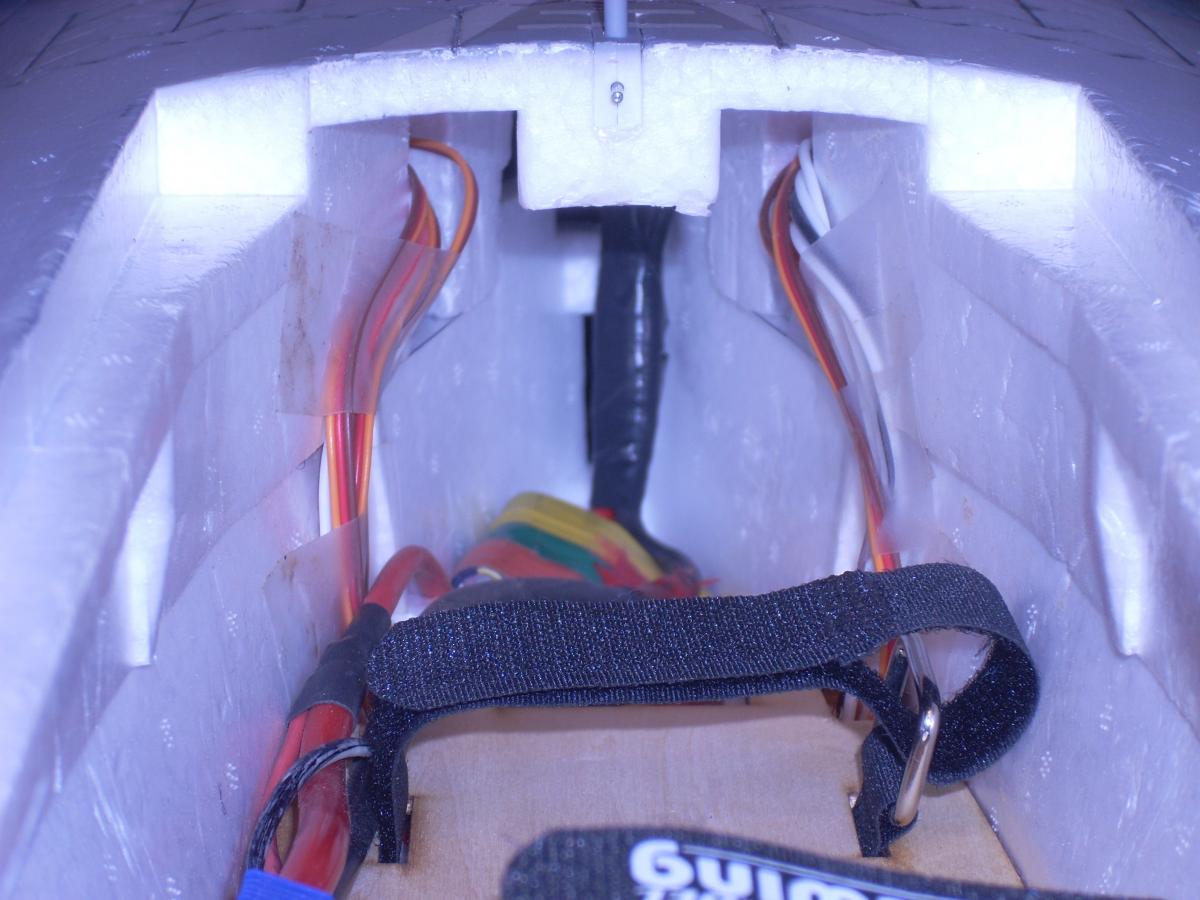

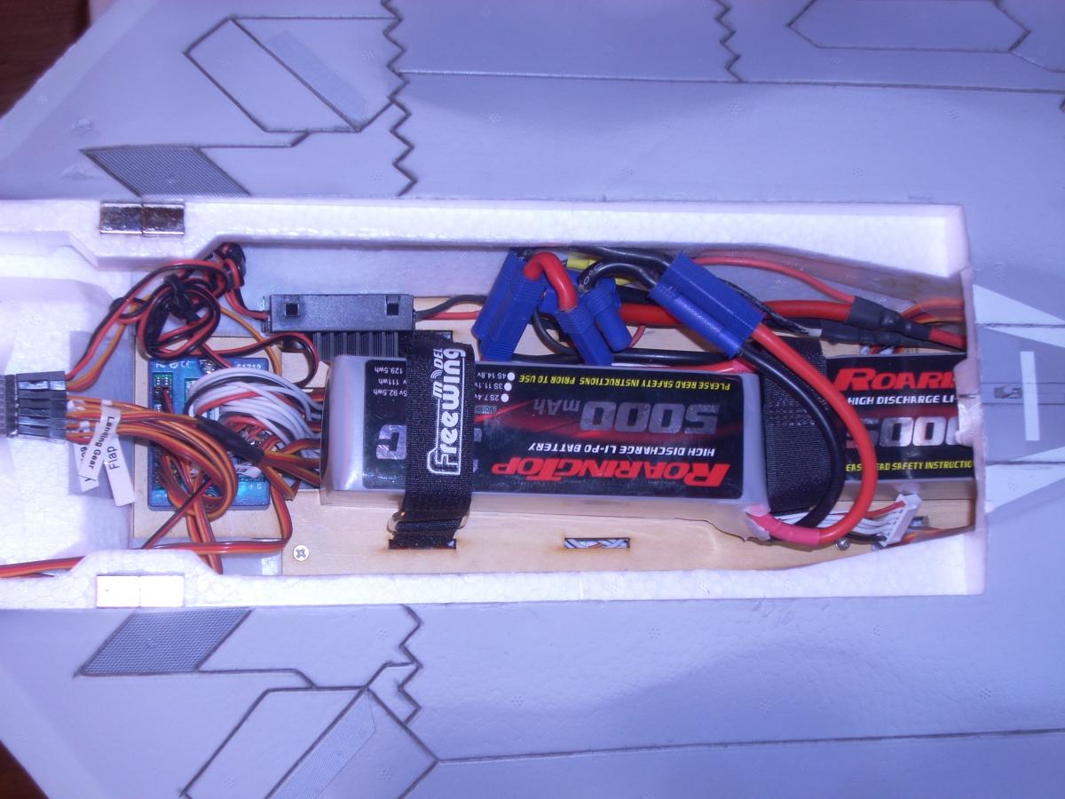

                                Anyone have experience with converting the 90mm f22 to a 12s edf? Battery placement for correct CG?
                                Thank's
                                  • 5416
                                  #3236
                                  Yes, easy with the huge battery area in this.
                                    #3237
                                    I use a pair of RoaringTop 6S 3700 in mine for 12S (pic is just a reference I used before I got my 3700 packs). Moved all the wiring off to the side so I could slide the rear pack as far back as possible. Works great and CG's fine.
