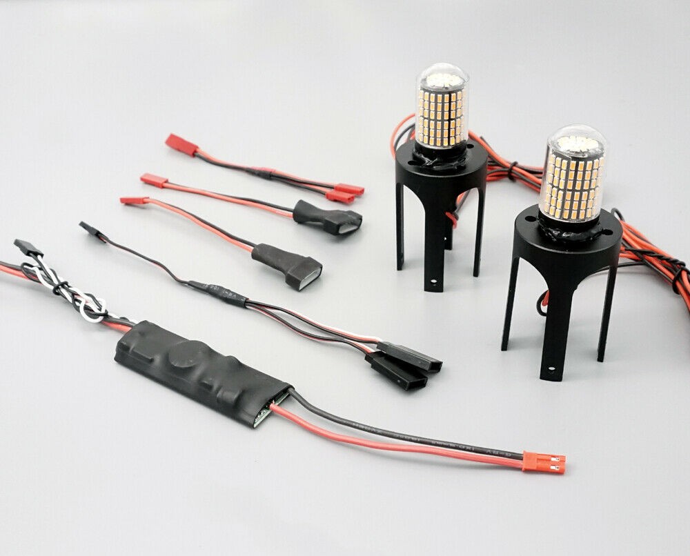

                                  Ordered a Spektrum AR8020T receiver today. I needed a 8 CH 6 CH not enough. Also where do you plug the afterburner in? Got one coming.

                                      Thanks gooniac33 I was just courious cause you can change speed of flaps and didn’t know if you could with gear. Also I ordered a 8 ch spektrum receiver didn’t want to trust the lemon receiver I got and wasn’t sure where to plug in the afterburner I ordered from you. Can wait till it comes to install.

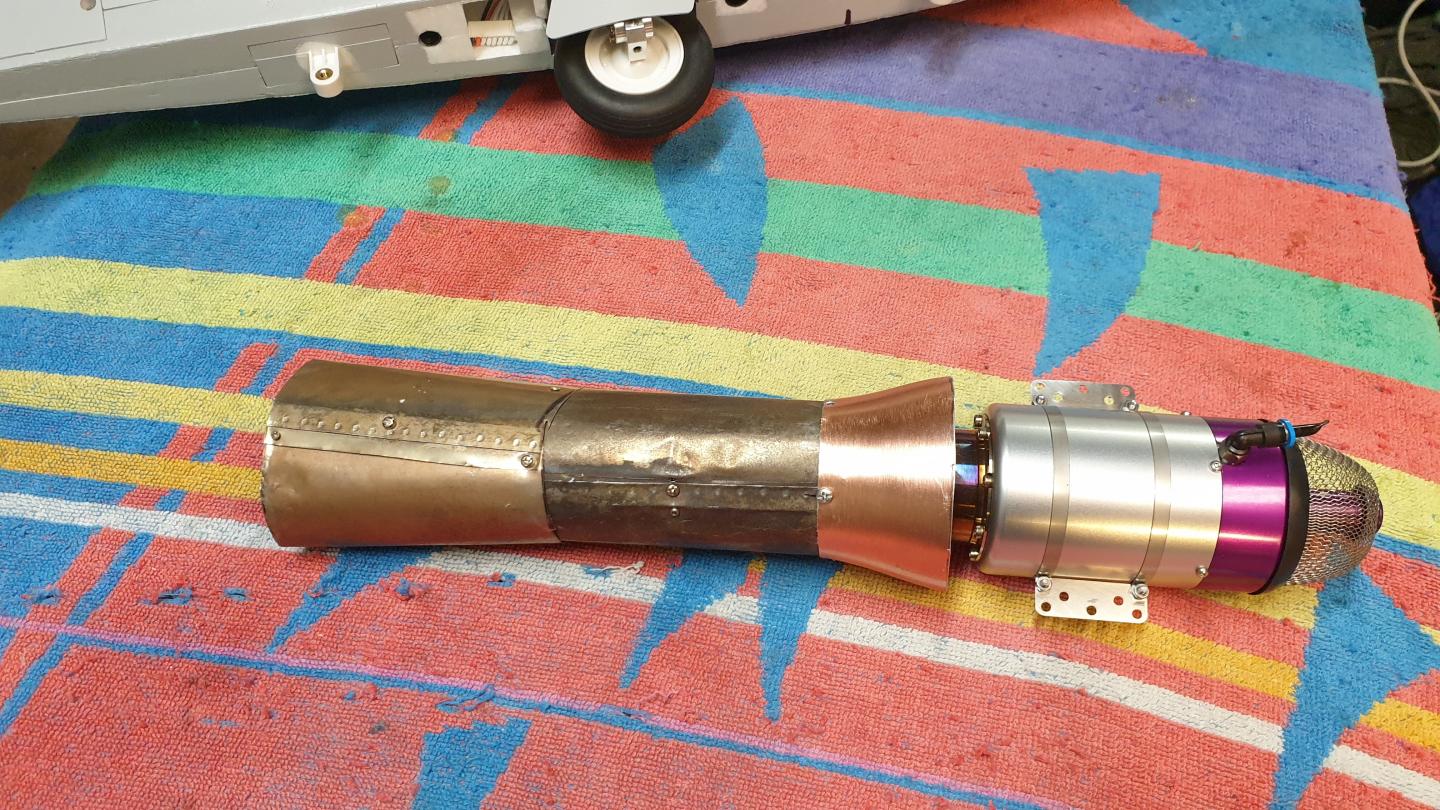

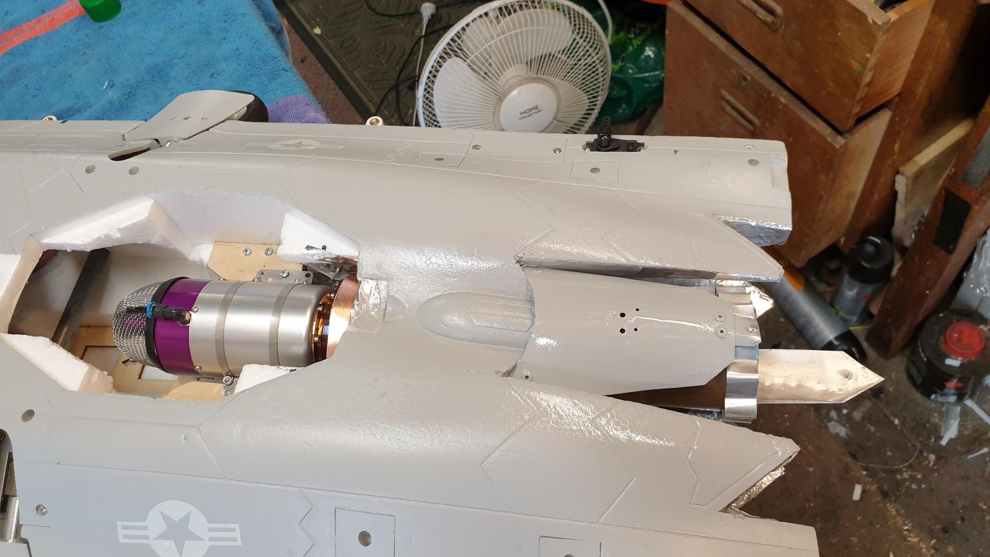

                                        #3379
                                        Hi guys, I'm doing a turbine conversion on this jet ATM and was a little worried about the static balance of the stabs, ie, the stabs themselves were very tail heavy. I added some lead inside them towards the leading edge so that they were very slightly nose heavy. Other aircraft that I have that use full flying stabs always recommend this, but no mention in the F22 instructions. With my Flexjet Pro, it actually comes from the factory statically balanced, so just wondering if anyone has any thoughts on this? Plus I'm going to add some centreburner lights on either side of my home-made thrust tube.
