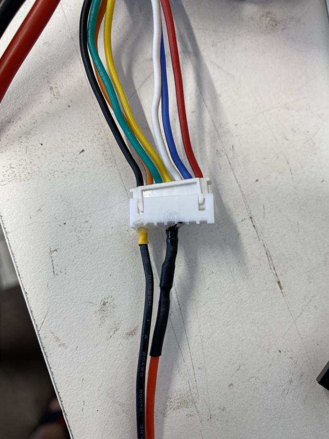

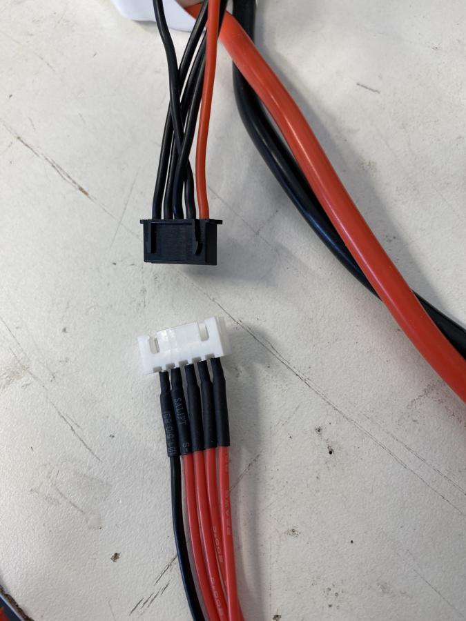

        Ok got my afterburner in with a little cutting looks good. Only problem now is it came with the balance plug for 6s battery I’m using two 4s batteries. Do I copy the same with positive pin four in from left?

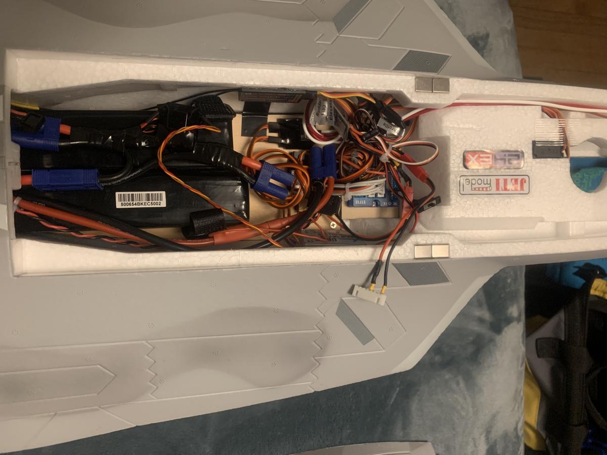

          #3484
          Here is what I have
          • Gmack908
            • Jan 2021
            • 80
            • United States
            #3485
            Originally posted by Av8er278
            Here is what I have
            You can push it out and move it. You only need two wires. Should look like this if attaching to one 4s battery.

              #3486
              Thanks Gmack908 I had a four cell balance plug so I just resoldered it on an copied the same pattern. And it works now. Wow you got lots of wires all over the place hehehe

                Haha I know. Believe it or not they are all zip tied and organized. I have so much telemetry sensors on here and a real pitot so there are air hoses as well. Hard to get it all in there.

                  #3488
                  Sorry I have been away from the site for a while and am just catching up on the thread now. There is nothing wrong with removing a little materiel to get the burner to fit. so long as there are no rough edges or foam sticking out into the airstream you will be fine.
                  I hope you got the emails that I sent. take a look at this video that shows the proper way to do this with the (2) 4s packs. If you want I can send you the battery balance adapter with the notch in it for the 4s pack. I think I may have forgotten to make the notch for the 4s balance lead... I make them all myself and over time stuff kinda blends together and I can forget. Even without the notch it will fit though... I have reverse voltage protection wired into the connector but it is still good to NOT plug it in the wrong way! See below... and if need be let me know how to get in contact with you via phone. we can work it all out.

                    #3489
                    Thanks Ray I got it going now. I used a hot wire to cut out foam. And I had a four cell balance plug and just copied yours. It works great now. Also put aluminum tape inside not sure I needed it but put it in.

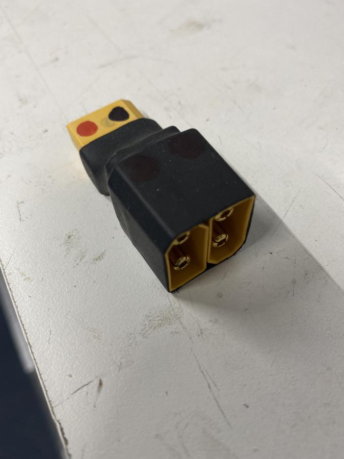

                      #3490

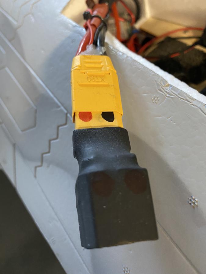

                      check out the video and make sure to always plug in the burner to the battery on the negative side of the connection. the adapters I make have reverse voltage protection so I will still send you one. if plugged in wrong it will save your battery but some other circuits may not like it! So be sure to follow the negative side of the series connection...

                        #3491
                        Thanks I watched your video and I’m pretty sure I’m doing it right. I changed my plug to a XT-90 plug with different type of Y harness.

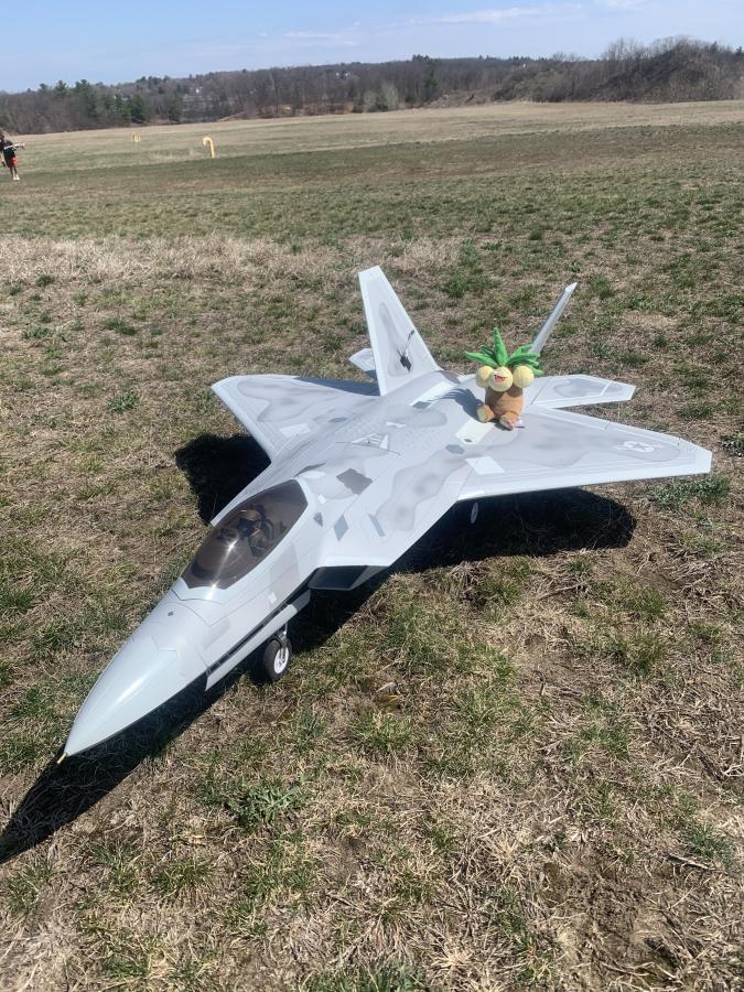

ID:	308708 6 flights on off rough grass at club field with 8s f-22 and flying great! Biggest thing I can recommend is to make sure you loctite all the grub screws on your retracts. Keep having mine loosen up.

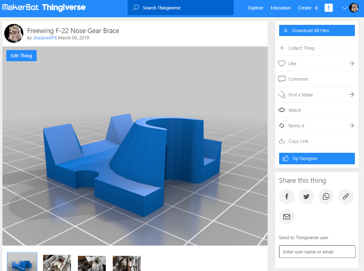

                                          #3500

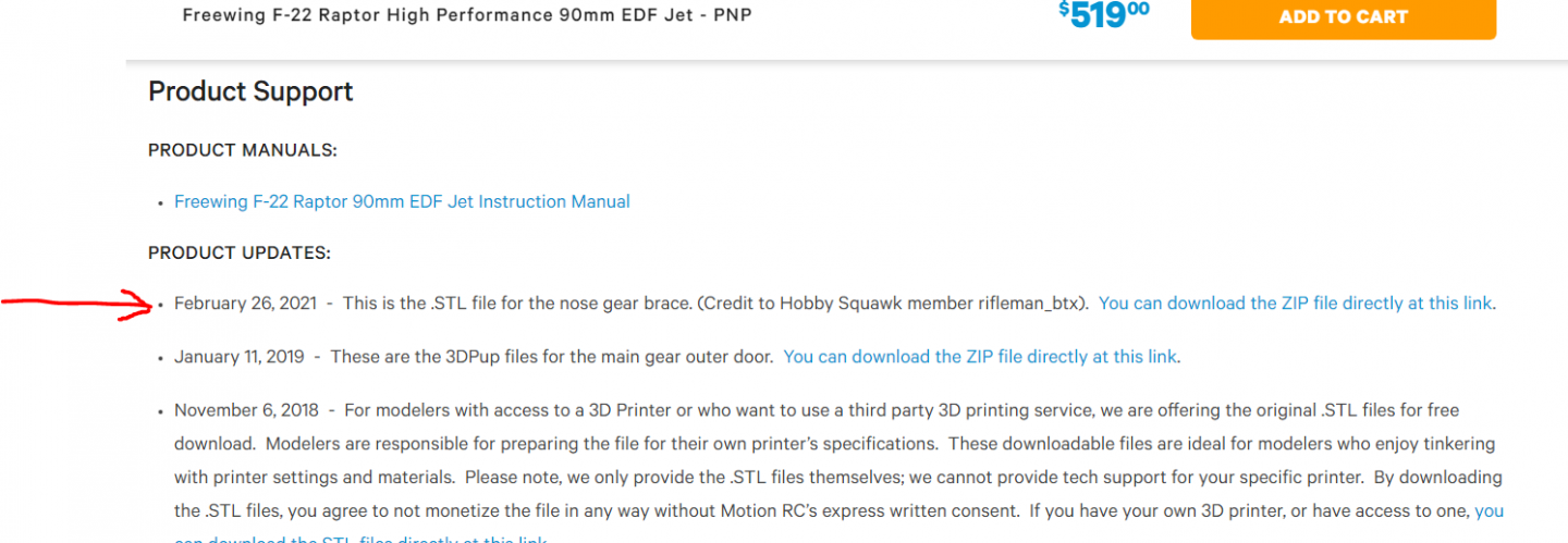

                                          Not sure if anyone from MotionRC is on this thread, but I'd like to point out that the 3D printed F-22 nose gear brace you have hosted on your site is designed by me, not Rifleman_btx. I wasn't even aware it was on the MRC support page until a club buddy of mine pointed it out to me today at the field.
                                          I'm not sure how it happened (perhaps because he shared the link on HobbySquawk?), but the design is mine. If you download the file, the readme even says "Designed by ShadowVFX", which is my Thingiverse alias.
                                          Anyways, just thought I'd bring that to your attention. You can continue using the brace on your support page. But, I would appreciate it if the credits could get updated to the correct person. Thanks.
