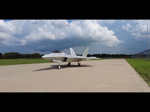

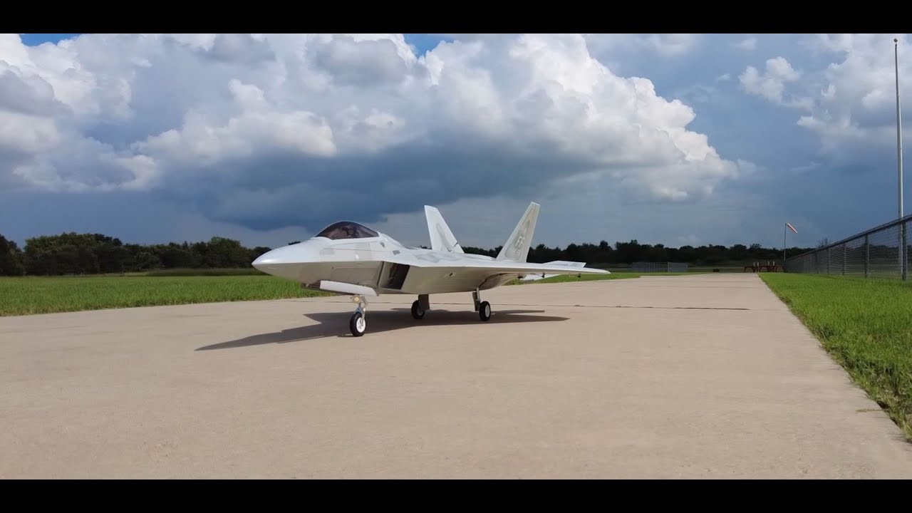

                                    Well today I got mine to 135mph. Plenty fast for me. Really love this jet.
                                      Nice! Is that stock setup?
                                        #3679
                                        It was the outrunner and I swapped with the new 9 blade inrunner fan and love it.
                                          They can be really exciting at high speeds.
