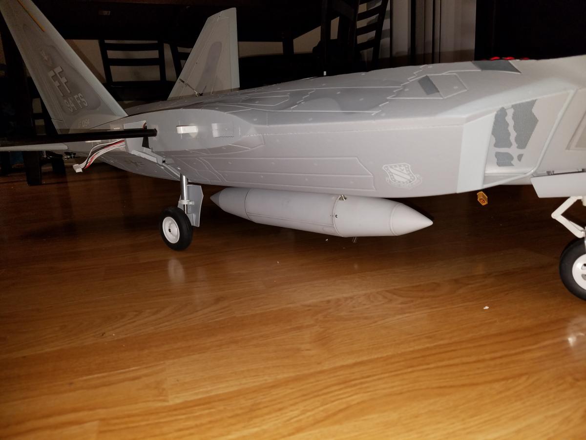

      Hi guys!
      I just finished my conversion. It's 10.5# AUW with the external tank and a K-55. Engine is way too big, but it's what I had so...
      Anyway, what do you think of the weight?

        #3703
        Should be good.

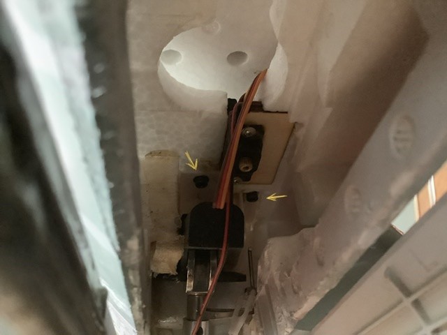

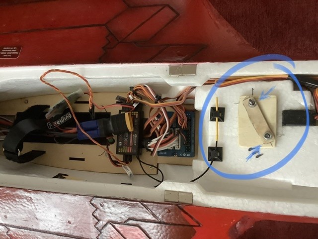

                      Sometimes a gyro might be helpfull, but most of the time, the Raptor flies fine without. In my video, the gyro was switched off.
                      I recommend an enforcement of the front gear. The plastic part that holds the gear servo unfastens rapidly in the foam compartment. …at least in my plane. There are two holes prepared for screws. For the hole under the servo compartement you‘ll need a flat head screw. Underneath the cockpit I glued a piece of plywood for mounting the screws.

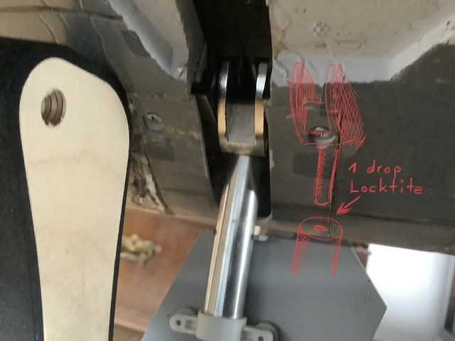

                      The two rear gears were also modified. The retract gears and the wheels are connected with a 5cm bolt that is fixed with two grub screws on each side. After take offs or landings on grass the bolts will unfasten, so that the plane might suffer unexpected steerings. I added a drop of Locktite to the bolts. (You can still disassemble the gear if necessary)

                        #3711
                        I can't picture what you are trying to describe...

                          Currently the head of the screw collides with the gear, so I will buy a flat head screw tomorrow.
                          @Evan D: Better?

                            #3713
                            I see. Thanks. I thought you were talking the main gear since you said "rear gears" and then "retract gears and wheels". Do you fly off grass?

                                  #3716
                                  That‘s what I did for the rear wheels.
