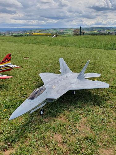

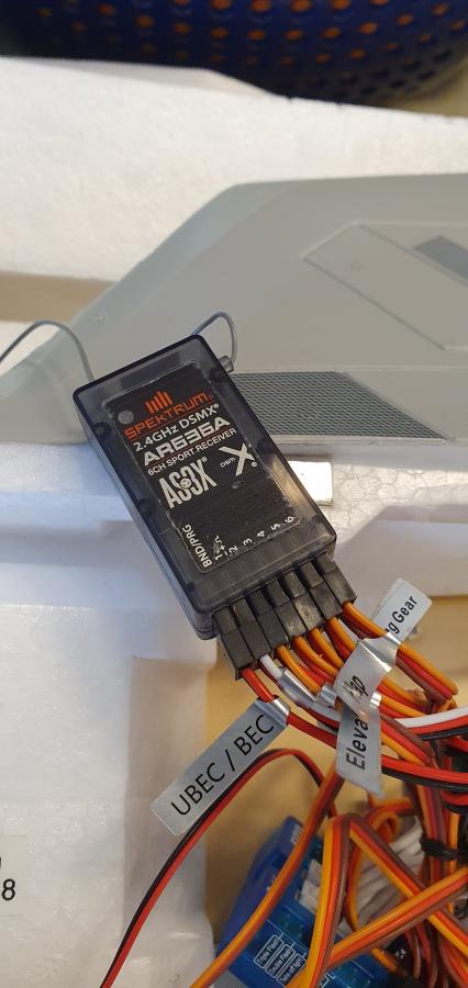

                      Hi, just got my F-22 90mm and I have Spektrum AR636A.
                      Is it possible to get that file to download?
                      Kind regards
                      Timo

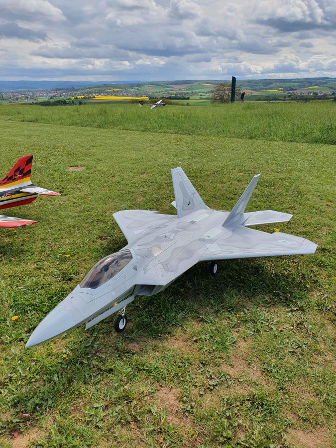

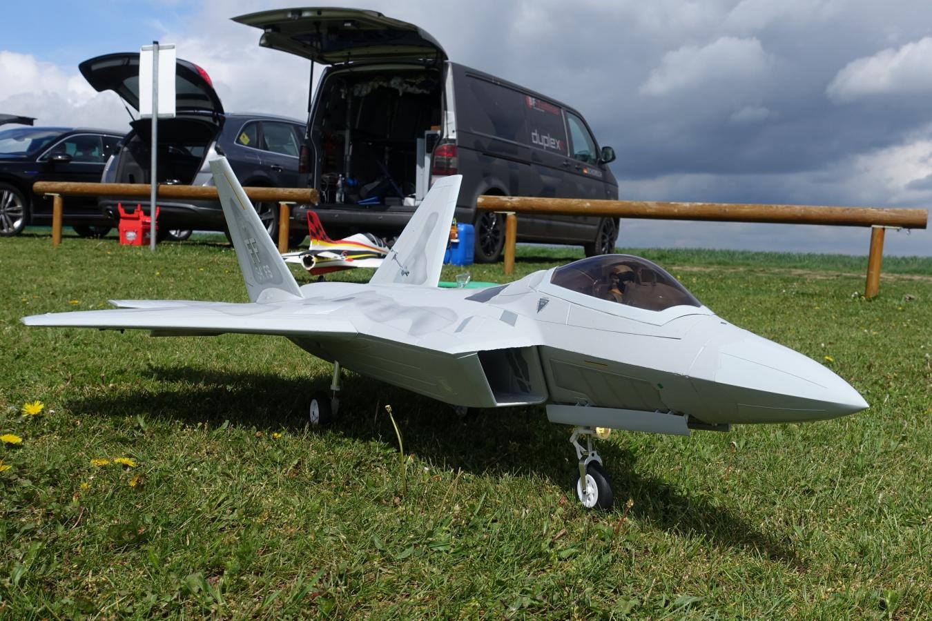

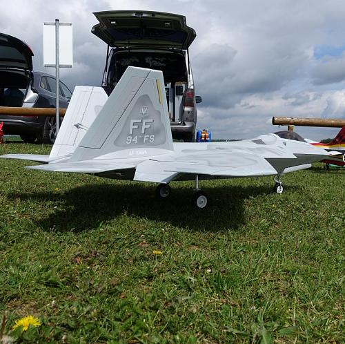

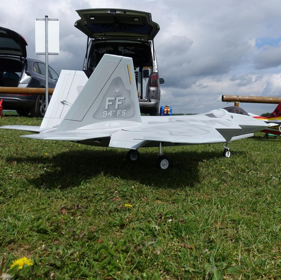

                      • Hi Guys, maidened my Raptor this morning🤗
                        what a great Jet, love it 🤩
                        had no issues at all❕, she flies between the Avanti and my Phantoms, more to easy Avanti I think
                        got my Raptor brandnew built Dec20 w/9b inrunner from upgraded stock for 6s, w/o flaps got quickly airborne
                        flew w/6.2Ah and 890grams velcroed just backwards on the end of wooden support
                        EDF took 120A on the ground, landings like Avanti style, does not require flaps, it was quite windy w/20-30km/h
                        set-up as per book
                        I trim on flight phases, normal, start and landing
                        did require less elevator and little right aileron
                        and little down for flap engagement
                        but shortend all gear springs by one turning as I fly on gras, coloured the rudder servos in light grey and took the inner elevator servo horn hole plus started loctite on critical screws

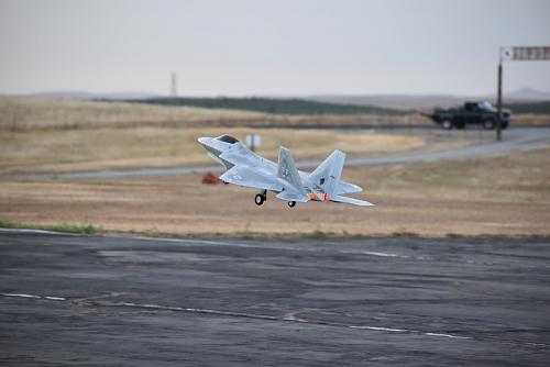

                          • Had my thunderbirds raptor out today with the 3D printed TV setup. Our resident drone pilot got some cool footage of it flipping around, the first minute or so of this vid.
                            This airframe is great for it. Even if the packs for this flight were a bit tail heavy lol.

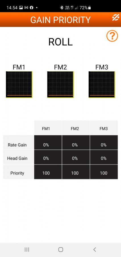

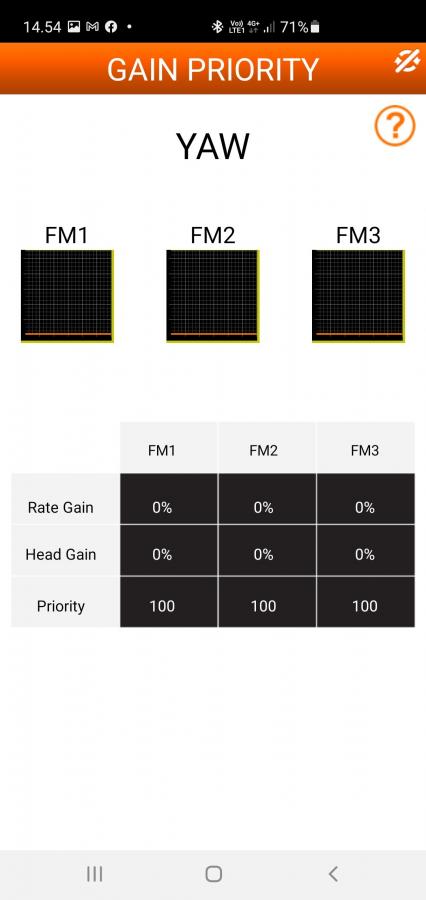

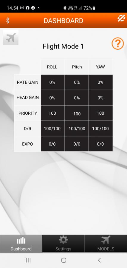

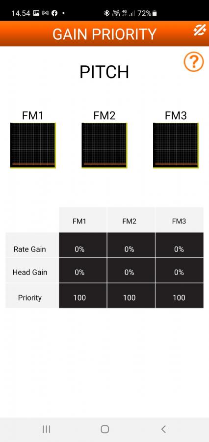

                                      • Can someone help me with the values for programmer?
                                        • Originally posted by Tilehtin View Post
                                          Set one flight mode up with 25% all round and one with 40%. Can usually crank yaw gains right up. This plane doesn't oscillate easily in my experience. Go from there. I haven't pushed the gains too high because it flies so smoothly anyway, but I reckon you could go pretty high. I run ~25% gain on frsky.
                                          For stick priority I like 160% - so, at 80% stick throw the gyro is completely dialled back. ​
                                          Always have a flight mode with 0% gains you can switch back into if needed.
                                          Use rate gain, not heading hold.
                                          I leave dual rates and expos alone in the Rx. In theory it helps the gyro perform better but it's marginal gains at the cost of convenience.
