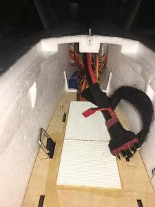

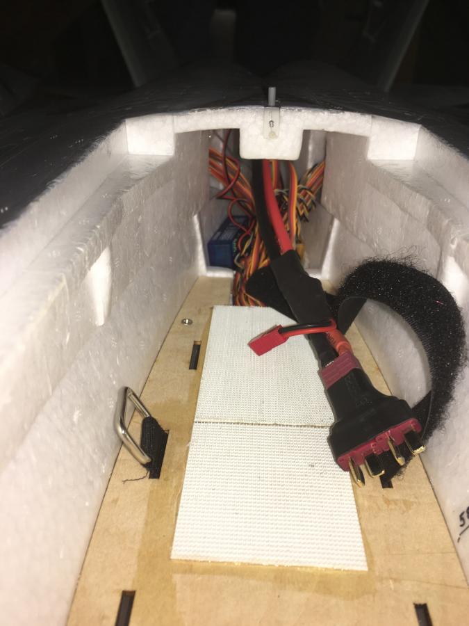

                                  PS, I usually zip tie the BEC wires to the battery wires to make it neater too... This is my F-18 but you get the idea.

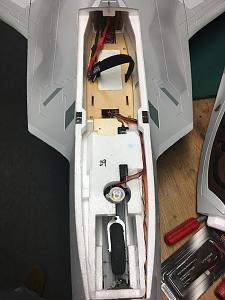

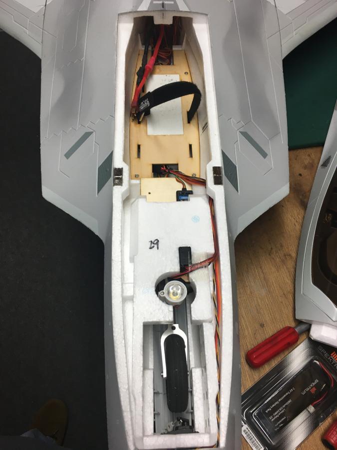

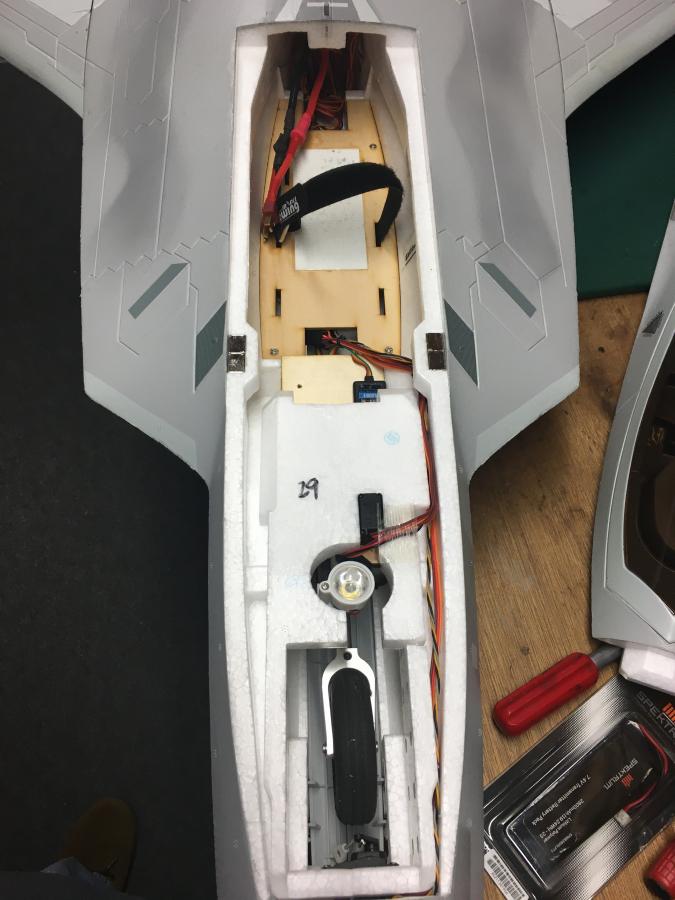

                                          ​​ I have my F-22 out as I’m rebinding all my often used (70 of 97) aircraft to a new(er) DX-18 I bought. I was wrong in that the receiver is back behind the battery area. I do have the MCBe under the battery tray. Here’s a pic.
