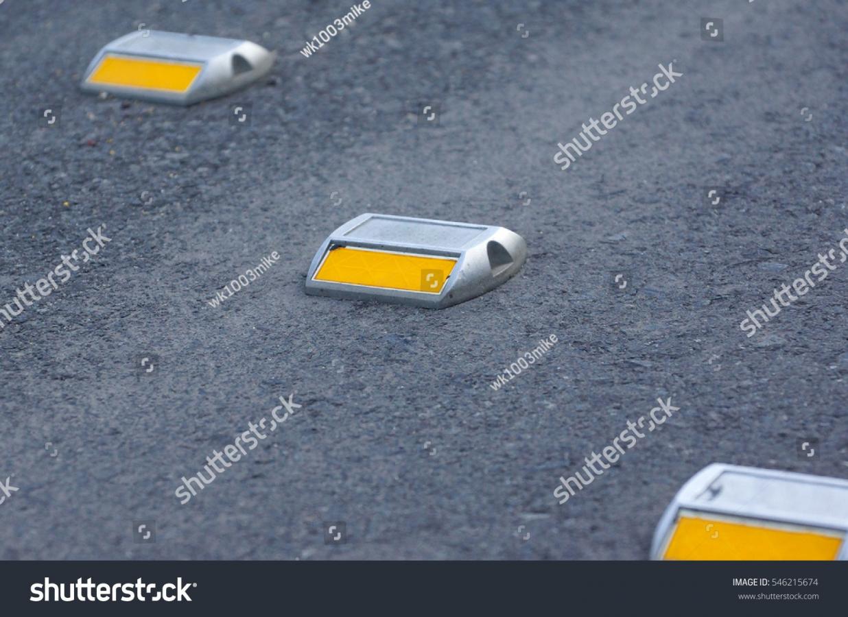

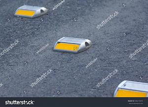

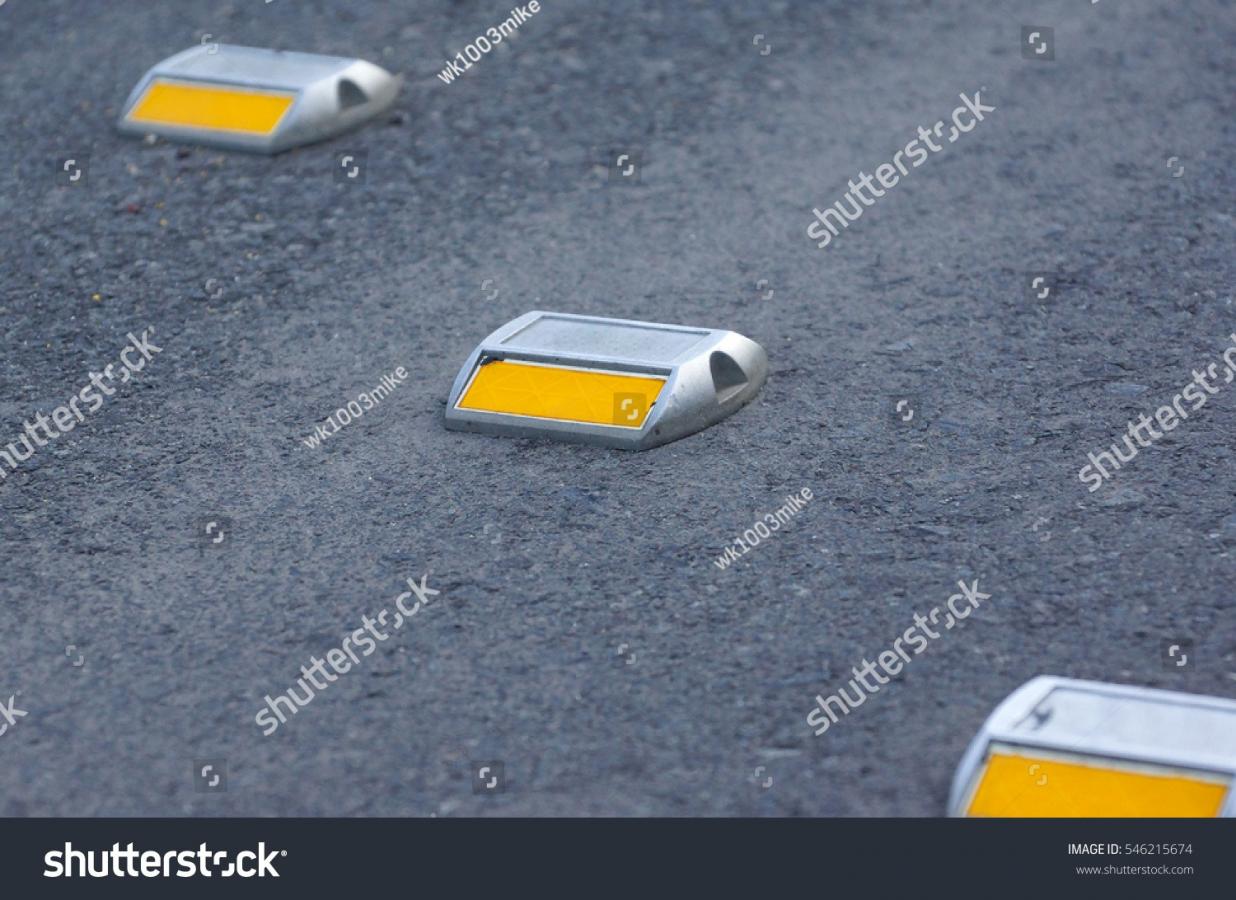

ID:	270894Probably can guess the answer, but has anyone attempted to retrofit the F-4 trailing link gear to the F-22?
                                  I have been flying from a closed road and unfortunately hit reflective "bumpers" in the road for night driving doing so. They're not as pronounced as the above, but similar. I've snapped three main gear pins so far and also messed up a couple of wheels also (it's pulled the axle into the wheel; in one case cracked the wheel's rim). It's caused a bit of rash on my wingtips and I'm getting tired of dealing with it.
                                  The trailing links should deal better with this type of shearing force and also probably soak up bumps better in general. My main gear springs are very stiff.
