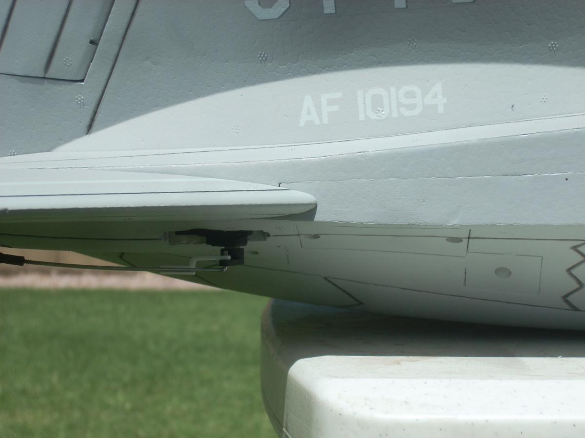

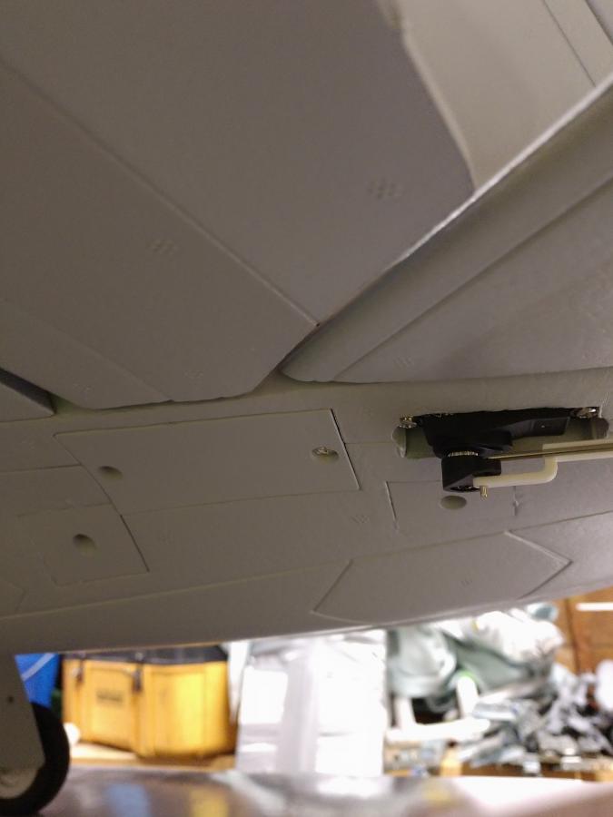

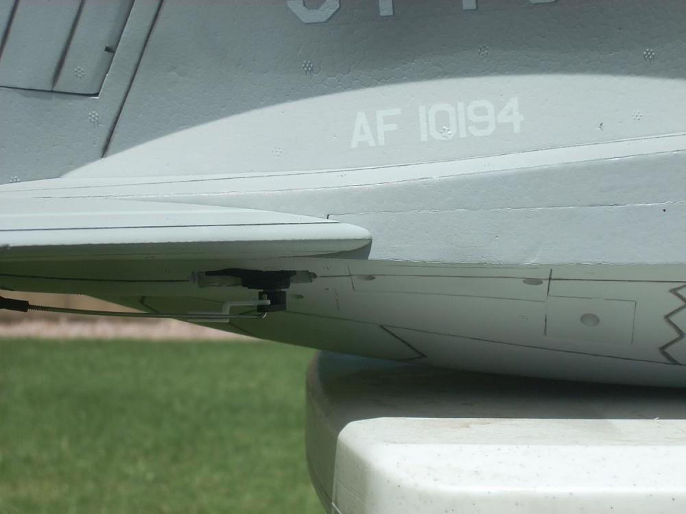

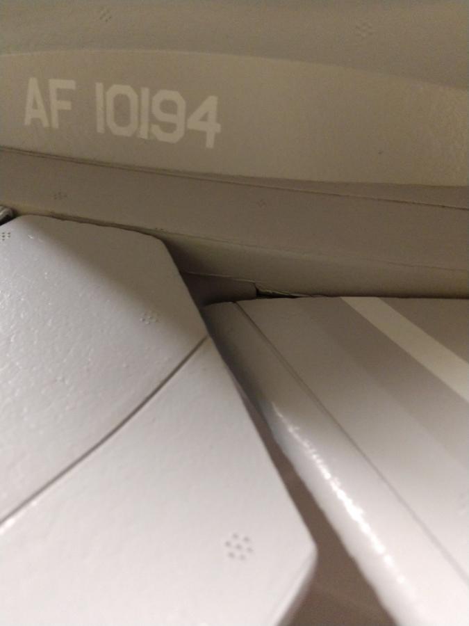

                      Going to maiden tomorrow. To be clear on stab 5.5mm setting, could someone post a pic of neutral setting. Pretty sure I have it set correctly, 5.5mm down from the straight line above on fuse. Picture in manual is dark in my manual and hard to really reference it. I am sure it is close enough but I would rather not fight a way out of trim plane...
                      Thanks.
                        #3011
                        A lot of people get the elevon neutral setting confused in the manual. I added some text to help. There is a glue seam line in the fuse that people think that is where to measure from. It's not that, it's actually the bottom edge of the fuse foam.
                              So I contacted motion to verify this and they told me directly to measure from the seam of the fuselage.
                              This is where the confusion is.
                              I'll upload a picture of how I am setup in the morning.
                                • 5385
                                #3015
                                The person you talked to is wrong, it’s from the bottom edge or lip.

                                    Here's my neutral setting. Note that the distance is 5.5mm up from the bottom of the fuse side, and not measured from the foam seam in the middle.
                                    Click image for larger version  Name:	DSCN5509.JPG Views:	0 Size:	67.2 KB ID:	258481

                                      #3018
                                      Thank you sir, thank you very much!
                                      I was measuring from the top as I read that somewhere but seen conflicting info. Probably still be flyable that way but I would rather not. Thanks again...

                                        Here is my neutral position. As i stated before the book and the person i talked to at motion were just WRONG. No two ways around it! However it was an easy fix. So no big deal.
                                        Click image for larger version  Name:	F22 Elevator 2.jpg Views:	0 Size:	37.7 KB ID:	258538Click image for larger version  Name:	F22 Elevator 1.jpg Views:	0 Size:	33.3 KB ID:	258539

                                          #3020
                                          The manual is correct once you have understand what it is saying.
