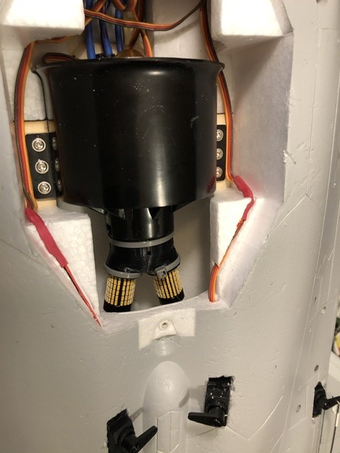

        I now have installed the thrust vectoring nozzles. Pins are holding them in place until glue cures. I used non-foaming clear Gorilla glue. I do not want these to come loose. I am now waiting on servos and control linkages to complete. I used Tamiya titanium paint for edges and a dark metallic silver for the middle of the nozzle.

          Pretty clean, would love to see them operating when you get it it running!

            Me too. Are the gears out of the airstream?

              Yes the gears are not in the airstream. They are off to the side and the nozzles have air streaming around the gears to allow smooth airflow at the side.

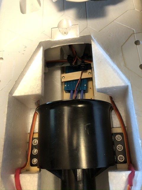

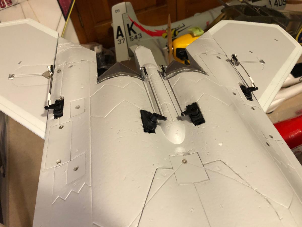

                Here are a couple of photos of where I’m at installing the vectored nozzle set. After cutting out the fuse openings for the servos, ( I will glue them in place with Gorilla glue) I proceeded to lengthen the servo leads and wanting to have no connectors to allow me to pass through foam and then forward to receiver area. Notice not he’s in fan lid to allow servo leads to pass. I then taped the servo leads to the side of the front intake with packing tape to minimize any airflow restrictions or cause turbulence. I then wire tied them to the wing spar before passing them on into the battery area.

                      Be careful, it is possible the servo could be moved by air pressure on the petals. I suggest pinning them some way.

                        Thanks for the advice, I will do that

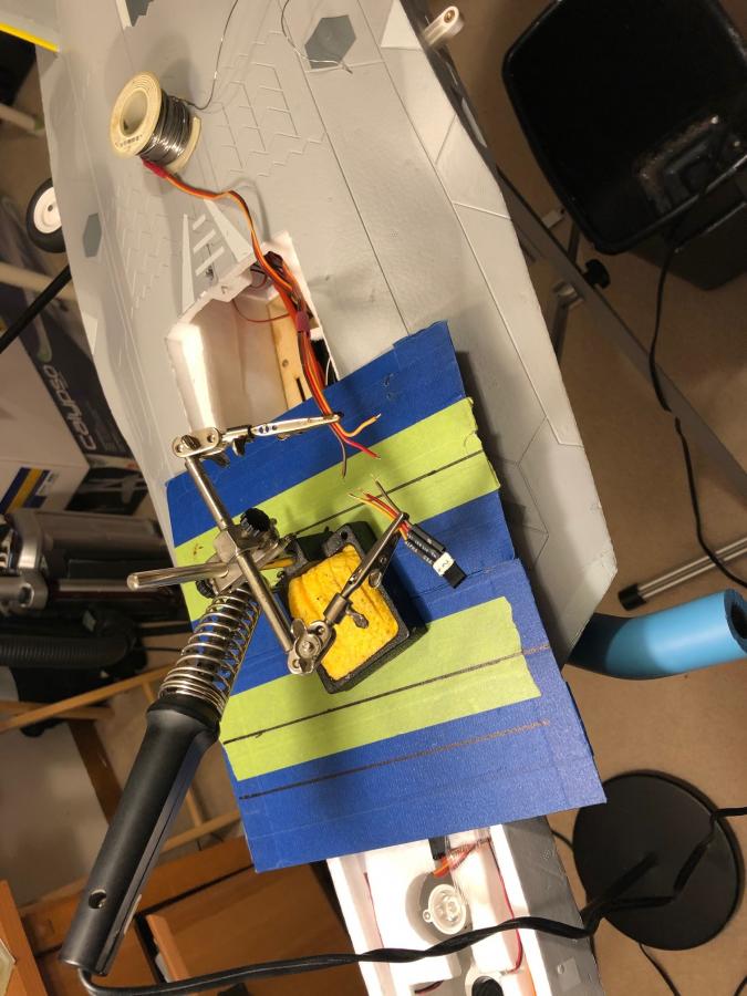

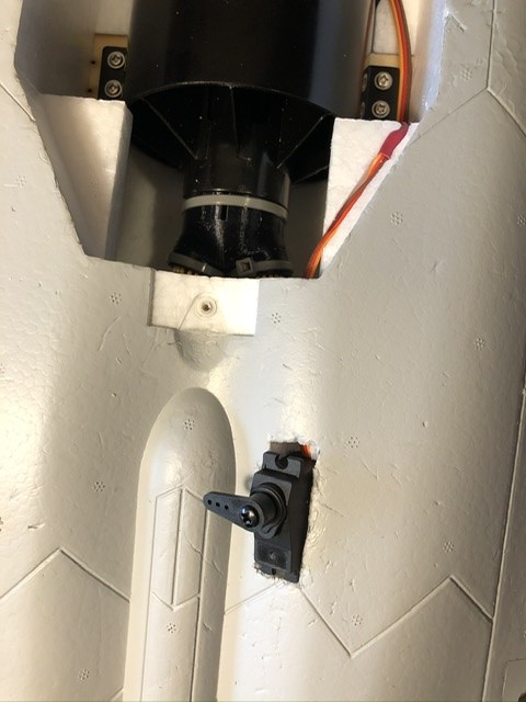

                            Here is my soldering station on top of the fuse while attaching connectors after pulling wire through fuse. Second photo is the finish set up. I used good old Z bends to attach push rod to servos and ball links at nozzles

                              Looks great, you’re going to have a good time with the TVs​​​​​​.

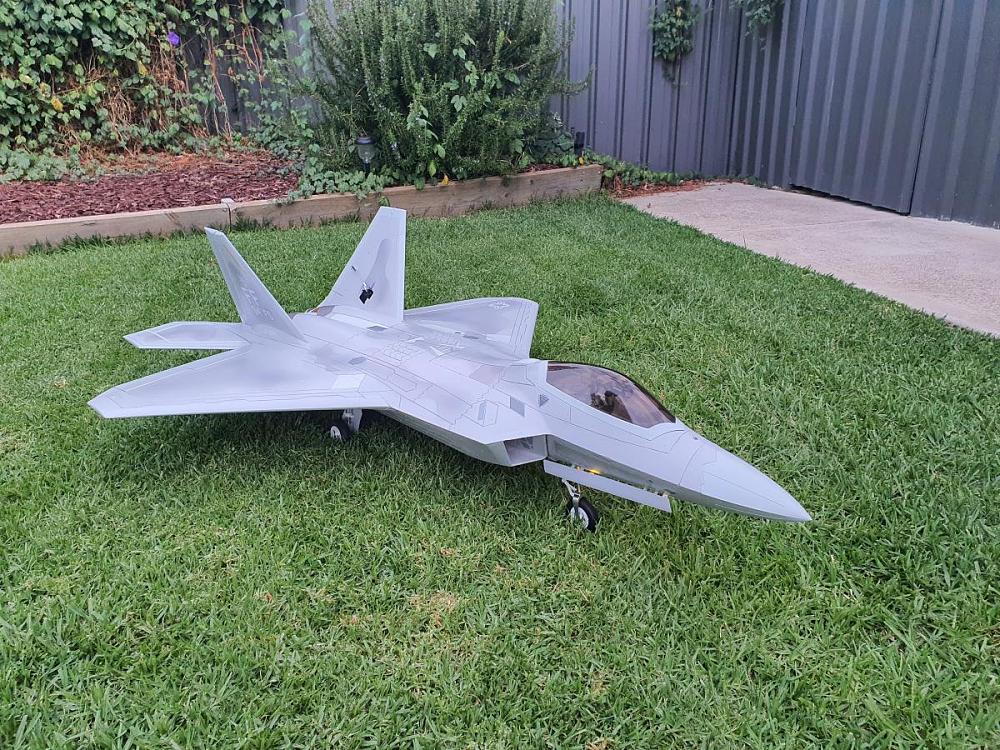

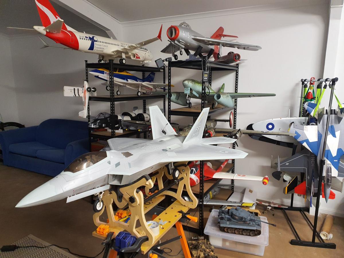

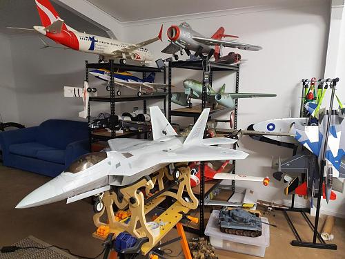

                                  Finally joining the club! This is one of those builds that goes together so quick you're left wondering "what did I forget?"
                                  Assembled with an afterburner and a tuned S6R before dinner. 3D printed a nose wheel brace and will probably detail the cockpit with the 3DPUP bits and pieces.
                                  I'm not much of a modern jet guy, but this thing is pretty easy on the eye.
                                  Here she is getting to know her new roomies (one of whom is going to have to give up their spot on the rack). Triple check of the preflights tomorrow and should get out for a maiden this weekend.

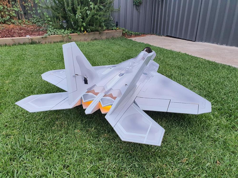

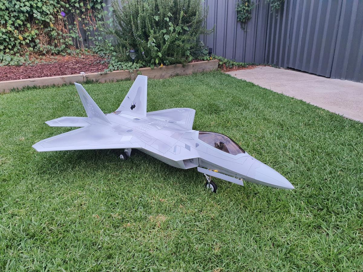

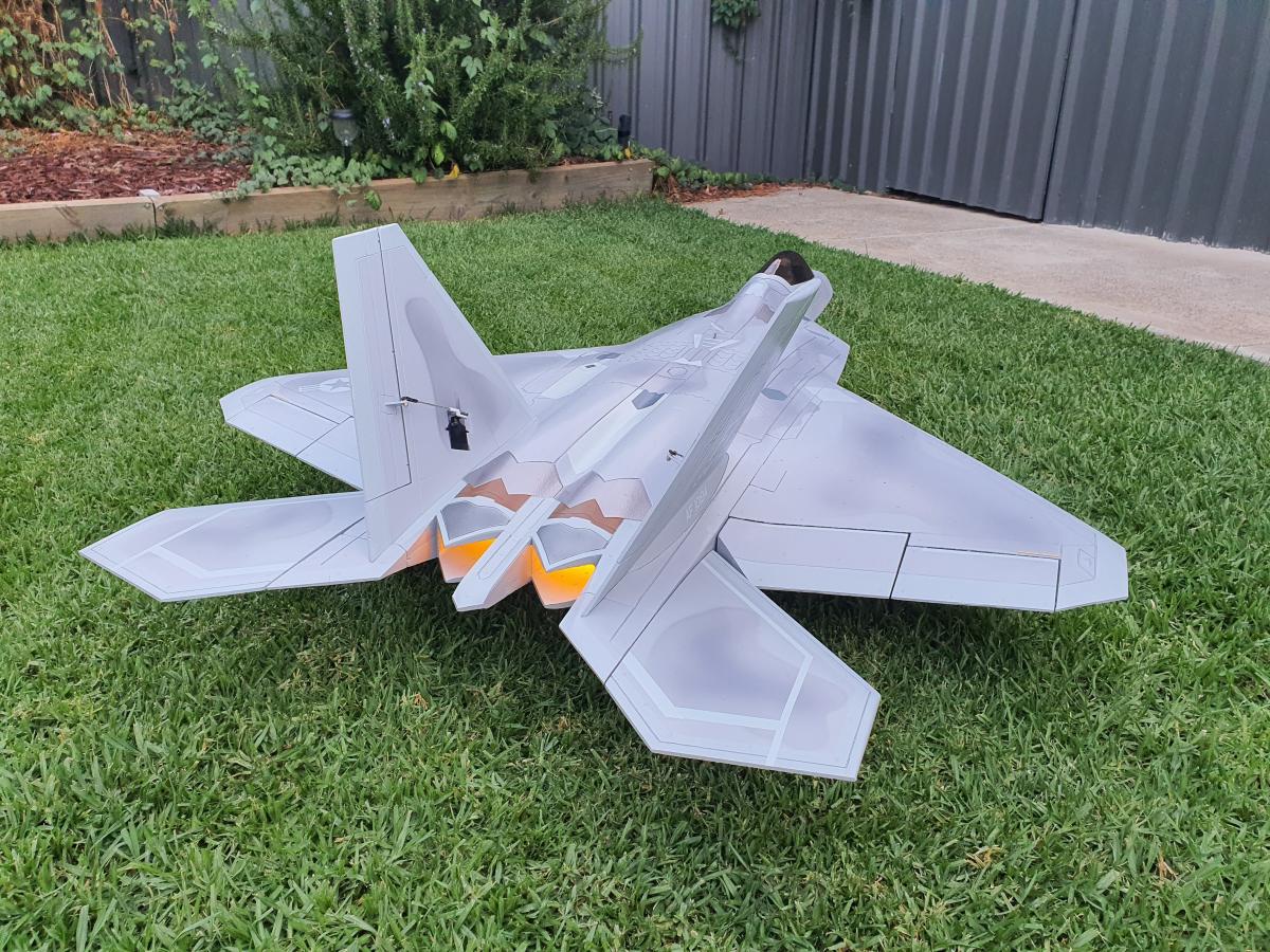

                                      Chased out the panel lines with a dark lead pencil and got a few coats of clear on her today. The panel lines arent really intended to weather the plane, it's more akin to a pinwash (learned that from painting the heng long tanks!) to make the detail pop a little and make the jet seem larger than it really is.
                                      Centreburner is a 'cyclone' from RC Castle. Much love to the community members who make the afterburner kits (I have them on my jets too!) but stateside shipping and the current aussie dollar rates against the USD are killer. The cyclones are great units for the price - nice and bright, neat flicker effect and a button on the controller to calibrate the throttle axis.
                                      I would have maidened her tomorrow AM but the battery in the ute (like a truck but built around a sedan - see pic) is dead flat. So, fingers crossed for sunday. In the meantime, cleared a nasty clog in the 3D printer hotend to pimp out the cockpit.

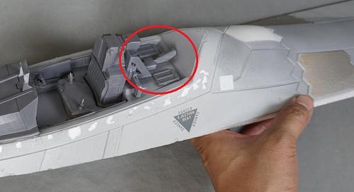

                                        #2919

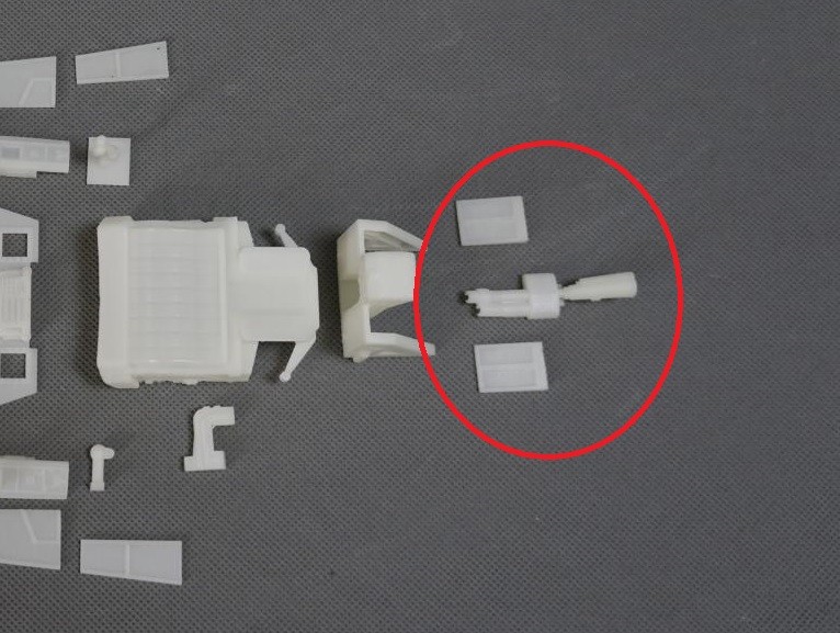

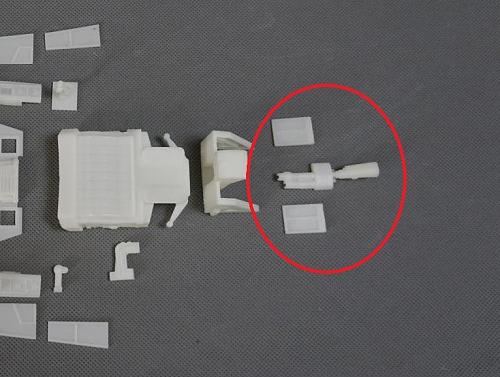

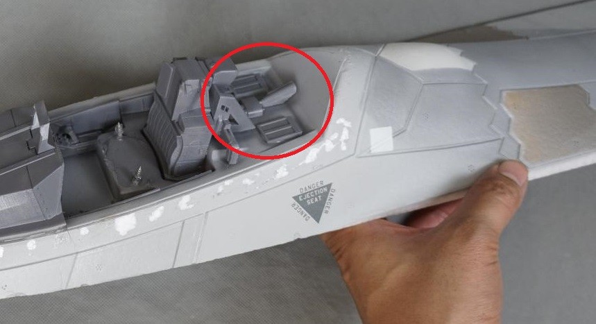

                                        Can anyone advise where the STL files are for the bits behind the seat? They dont appear in the .zip file on the website.
ID:	249723Click image for larger version
