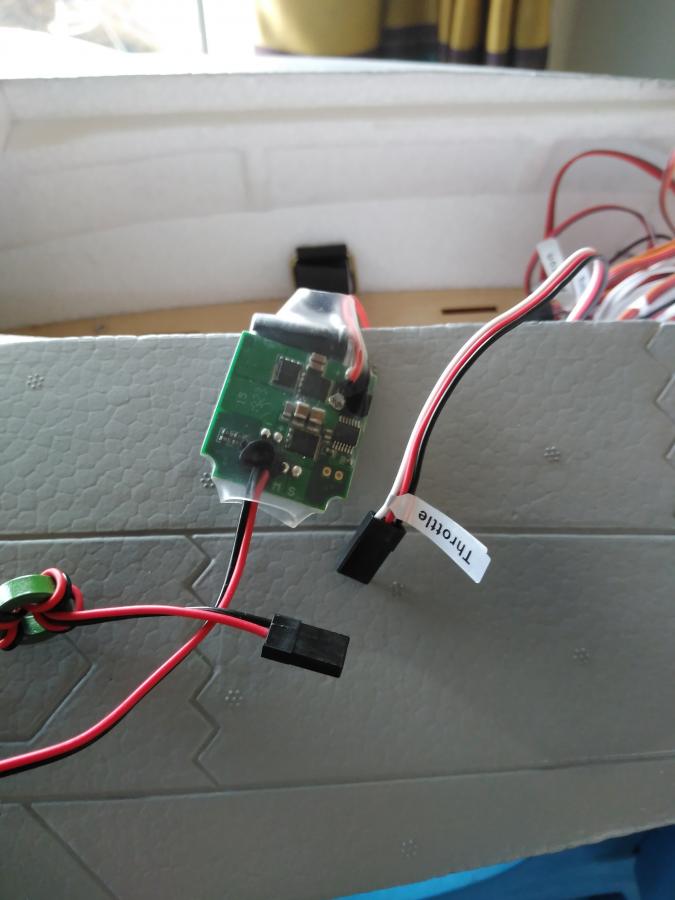

      I need some help on my F22 build .I have two wires .One has throttle on it and comes from the bottom of the fuselarge and the other comes from the battery lead and has the circle magnet thing on it .Anyone tell me where the are connected to .the wire with throttle on it does not come from the blue box but under the fuselarge
        The one labeled throttle goes into the throttle slot on your rx. The other is the external BEC and it powers the rx. Plug it into any open slot on your rx. You can use the bind port if needed (after model is bound.)

          These are the two wires

            OK thanks JamesonC

              Sorry to be a pain. I am using a futaba R3008 SB .I want to plug in a Hobby EagleL3 gyro so with channel 1,2,3,4 and 5 & 6 for retracts and flaps and channel 7 for the gyro can I plug the external beck wire into channel 8/sbus channel

                Yes, the BEC doesn't need a signal so it can plug into any unused slot.

                  Thanks guys. I had the same question as above a while back for the F22 and appreciate whoever forwarded me this thread :-) On the flip side, I only have an 8 channel receiver, hence all the servos took up all the ports and the only port left available for the BEC was Bind/Aux2, hence lost that port for my giro. Doesn't matter that much anyway since my receiver is an Admiral with the gyro configuration switches built in.

                    You can also use a Y to hook the BEC to the receiver if you don't have an empty slot.

                      Thanks connected it to channel 8/SBUS channel .All working fine .Learnt something today .thanks everyone 😀
