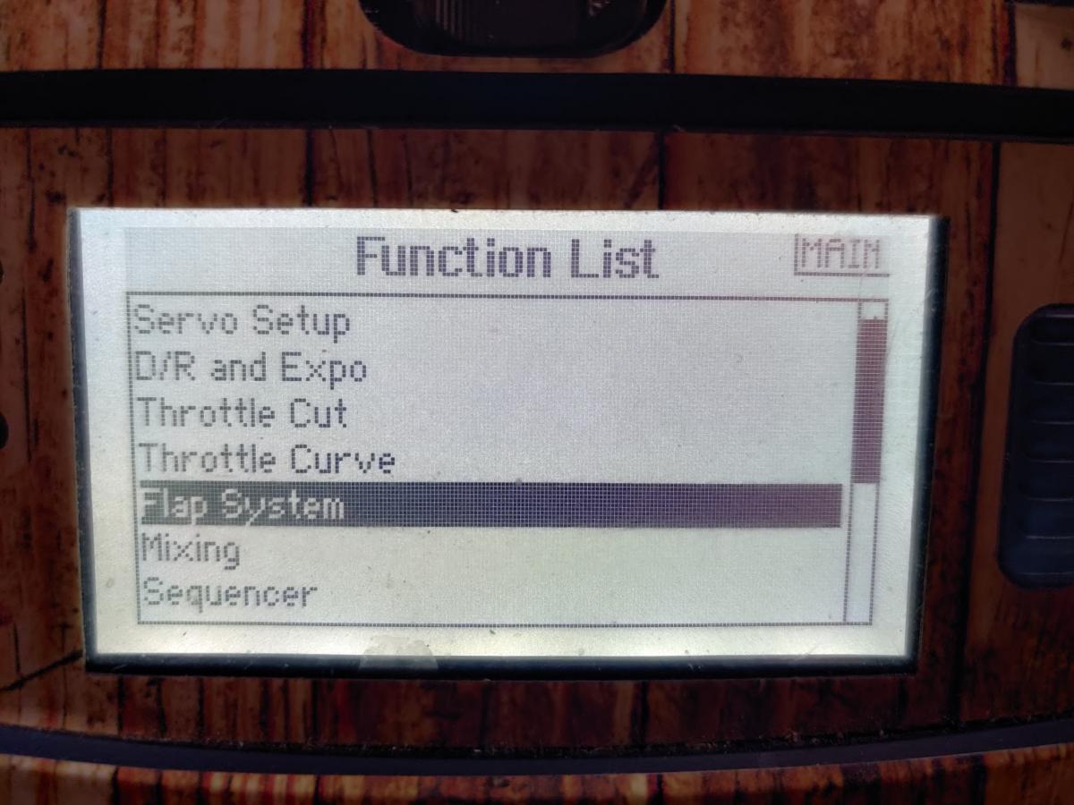

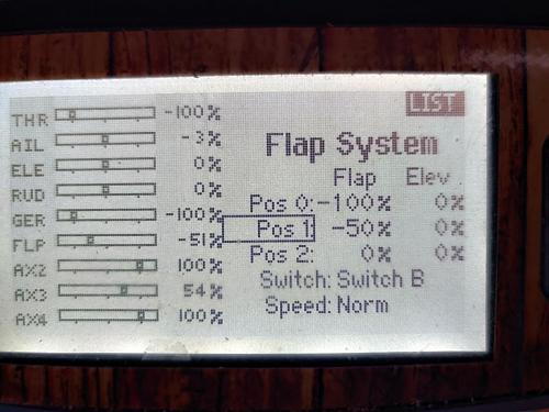

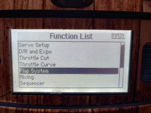

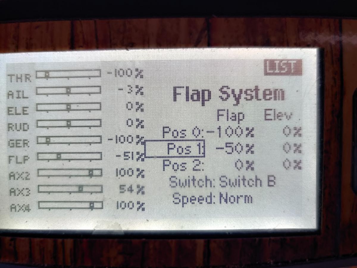

    Hey Jag_Dieppe , You have to turn your flaps on from the function list. Then you have to un-inhibit and set the switch you want to use (2 channel or 3 channel up to you). Then you have to play with the values per position.
ID:	238234Click image for larger version
    Hope that helps
    • Hi James, the Flaps are on in the function list. I have similar configuration as per your picture, but my values are positive as oppose to being negative like yours. I still get no response.
      However, can you answer this question for me :
      ....If when I power up the plane, receiver and transmitter and all work fine except I get no response from the Flaps, and then while all live I unplug the Rudder connector from the Receiver and plug the Flaps connector instead; shouldn’t the Flaps move when I move the Rudder stick ? …..or same scenario using the Elevator port ?
      In my test above, the Flaps never move regardless of which port I plug it into the Receiver……all doing this while live. Is this an indication of something ?
