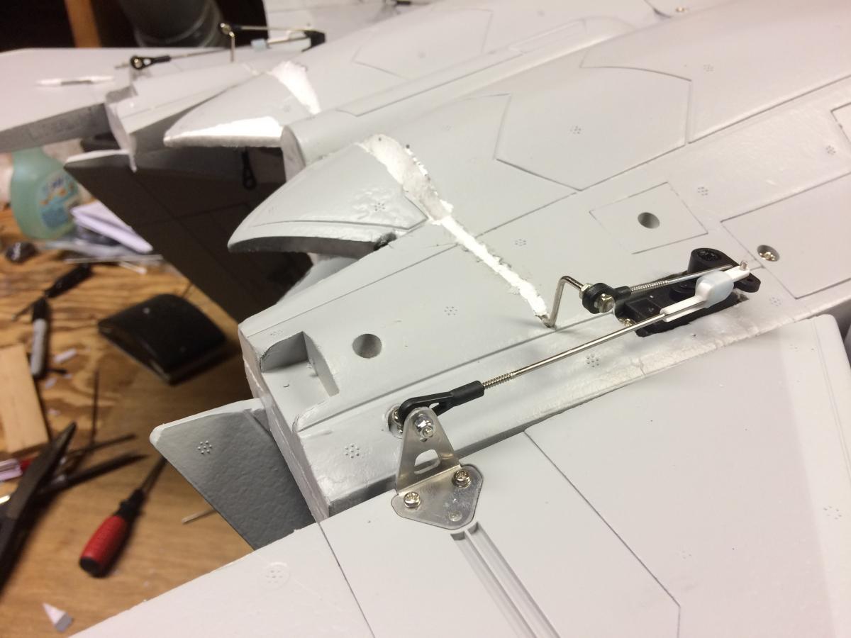

Originally posted by Gary9648 View PostI’m looking for instructions concerning installing the trust vectoring parts that Jeremy Solt has on his plane. I bought the plastic parts from Andrew O’luaghlin. Excellent workmanship. No instructions. Would like to know size of servos, ie. torque and if metal gears needed. What push rods used. Also how to connect this up to receiver. It looks like I need a reversed servo as well. Due to set up. Do you need two channels for mixing or connect with Y servo lead. Any help would be appreciated. I assume this has been covered here but I can not find it. Thanks guys
gary webb

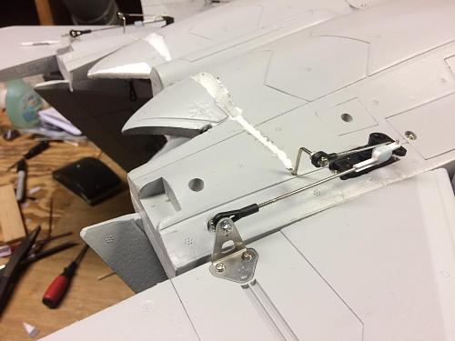

I was the first to put TVs on the F-22 but did it without 3D printed stuff. I made torque arms and linkages to the existing stab servos so no extra servos were needed. Since I fly with tailerons I also get roll out of them.
Video- https://www.youtube.com/watch?v=0UtXjl_rg4c
