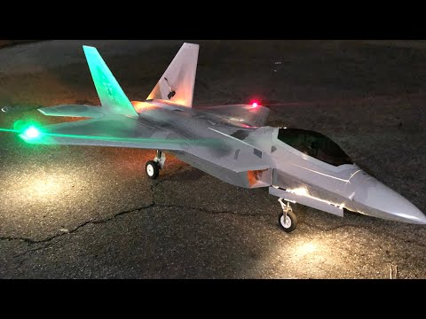

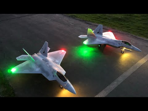

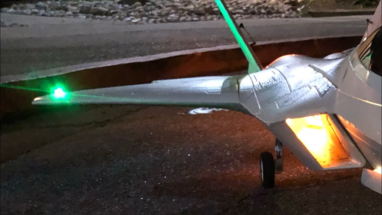

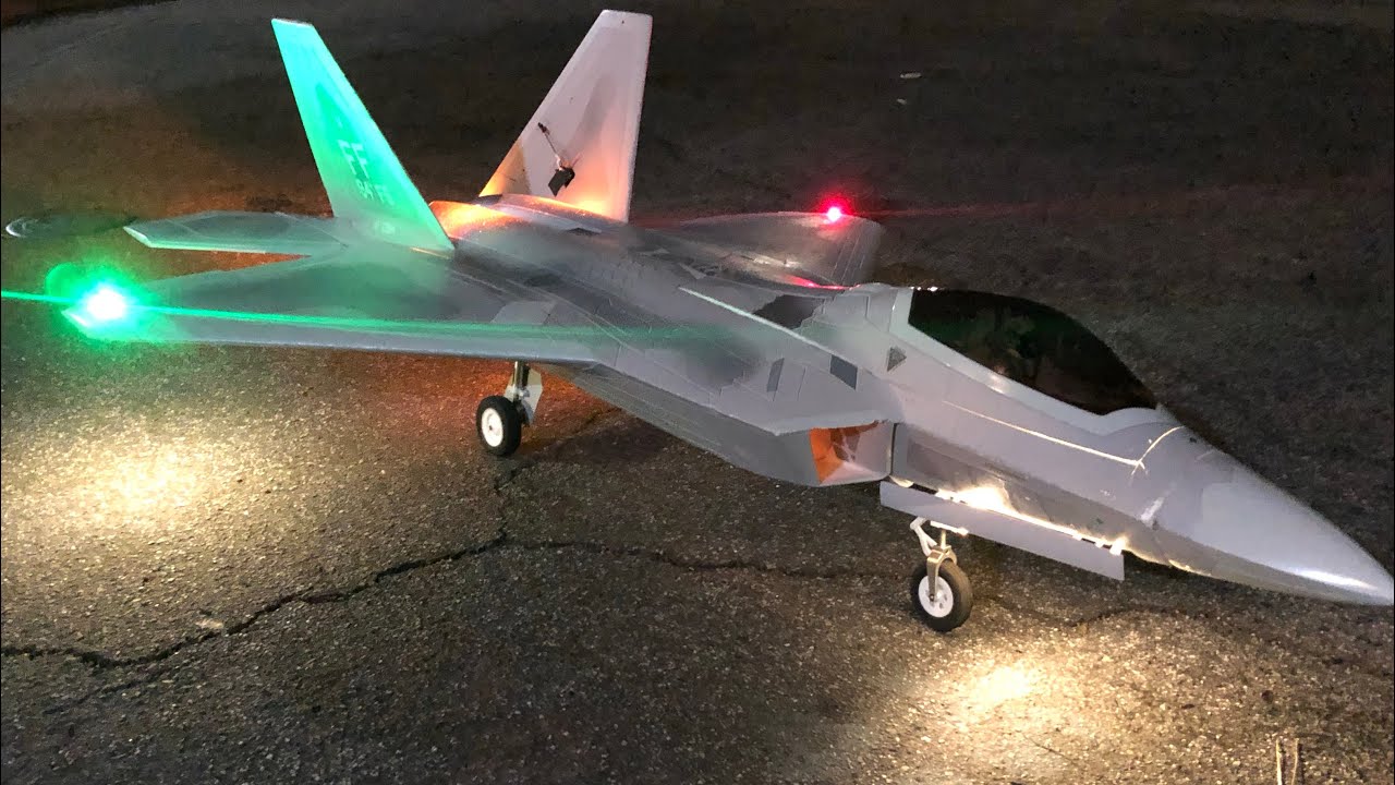

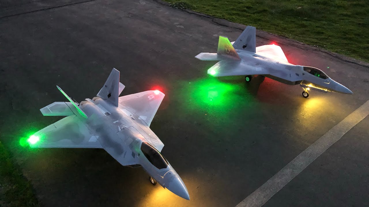

                  Finally got some more flights on my F-22 after a couple months of her just sitting there lonely... A friend helped by adding some LED lighting to the plane! Here is a short video of that and a couple flights...

                    #2789
                    gooniac33 The new lights on your F-22 take this bird to another level...I'm really liking it. Going to start the build on mines soon and would love to add these lights. Care to share with us which lights and/or covers you used?
                        Looking good! Thanks for sharing :)
                          These are all sold by motion! I believe these are the L-39s and they plug into the wing boards and blue box for power! I didn't use covers over them but I am sure they could be made.

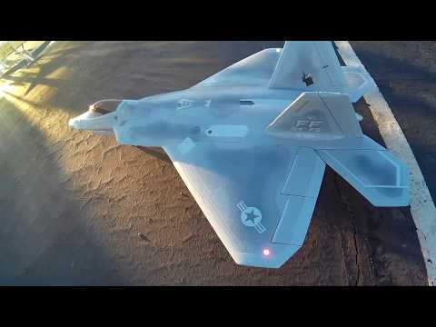

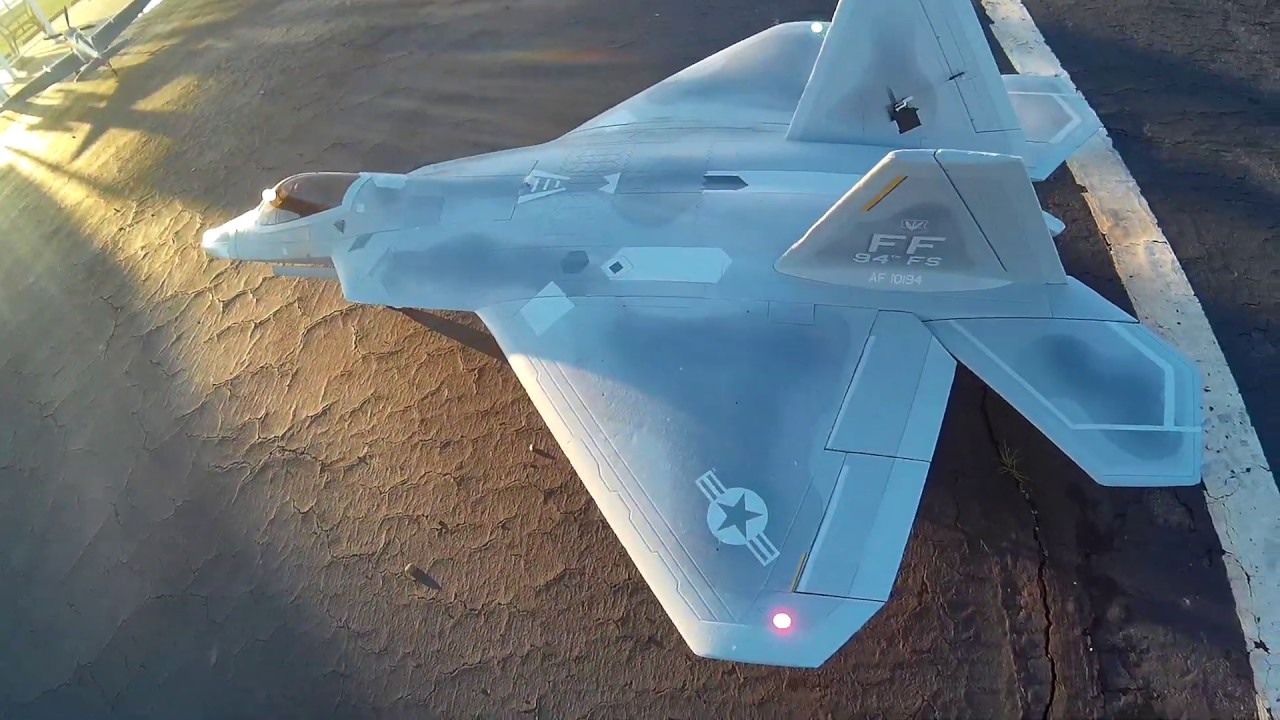

                            Thank you!! Here is one of the flights from saturdays flying... more to come...
                              Great work, looks really cool...
