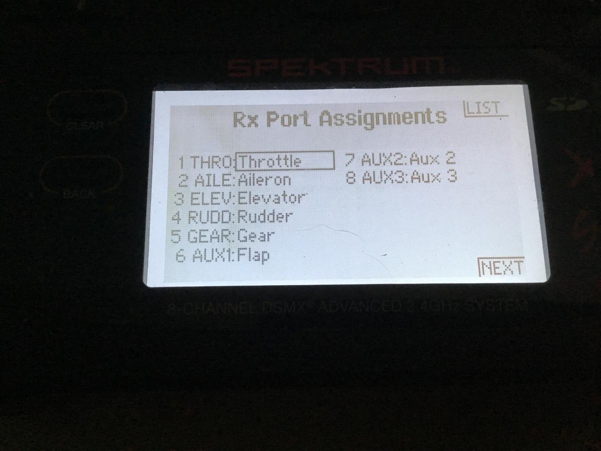

                                  I acquired the Admiral RX600SP 6-Channel DSMX Receiver for the F22 Raptor plane. My transmitter is the Spectrum DX7s ver 1.03​. The receiver has:
                                  Port Servo
                                  Aux2->Power from battery, otherwise nothing works
                                  Throttle->Throttle
                                  Aileron->Aileron
                                  Elevator->Elevator
                                  Rudder->Rudder
                                  Gear->Landing Gear
                                  Aux1->Flaps
                                  All work fine except the flaps do not work. My Wing Type is setup with "1 aileron, 1 flap" and the tail is "Normal". The Switch Select is setup with Trainer: Inh, F Mode: Inh​, Gear: Gear​, Flap: Inh​, Mix: Inh​, Knob: Inh​. I tried setting up Flap to Aux1 instead of Inh, but it does not give me that option. It only gives me the Inh or Aux2 options, and as stated I cannot connect the Flap servo to Aux2 because of the power connector. It has to remain on Aux2. In the Flap System function, I do have Sw: Flap set. I have been working on this for days to no avail in making the flaps work. Can you assist ?

                                    • Jag, can you post a pic of your receiver as it is in the plane? I don’t know about admiral receivers, but typically with dsm2/dsmx units the power plugs into the bind port, which would free up your aux2. Aux 1 may be gear, again I don’t know about admiral units. I think on some lemonRX units it is.
                                      edit: disregard my ignorance please, I just looked at that receiver and see the bind port is the aux2 port. My apologies. I don’t think there is a workaround, other than maybe putting the power in on a y cable with some other channel.
                                      • I have a DX8G2, and the only other thing I can think of is channel assignments. I’m surprised it didn’t work straight off with flaps in aux1.
                                        • If you go into system setup, and channel assign, do you get a screen like this? And does aux1 say flap?
