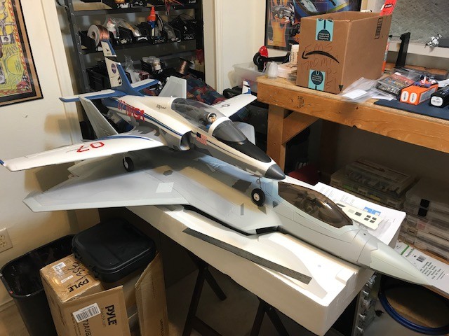

            Jeez, this thing is big!

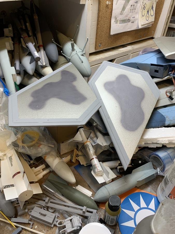

                Chasing that enigmatic Have Glass sheen seen on the F-22, I think I’ve come to something relatively close. The problem is that the metallic crystals in the paints currently available are too large and give to much of a reflective flake effect. I’ve tried Modern Masters Matte Mettalic from Home Depot as a straight paint on attempt but if was too silvery. After attempting to put dull coat over it, it just turned to gray so that was out. Next up was Liquitex Iridescent Medium overcoat. Even with different variations of thinning, it just appeared as too glittery for my taste. Finally decided on Rust-oleum Metallic Satin Nickel as the base coat and Mission Models Have Glass Gray FS36170 as the final colors. The Satin Nickel still looks too silvery but it does look close to what the full scale looks like from certain angle and so I’m going to run with that. Plus, it’s going to give my F-22 some “bling” effect when next to all of the other F-22’s out there.

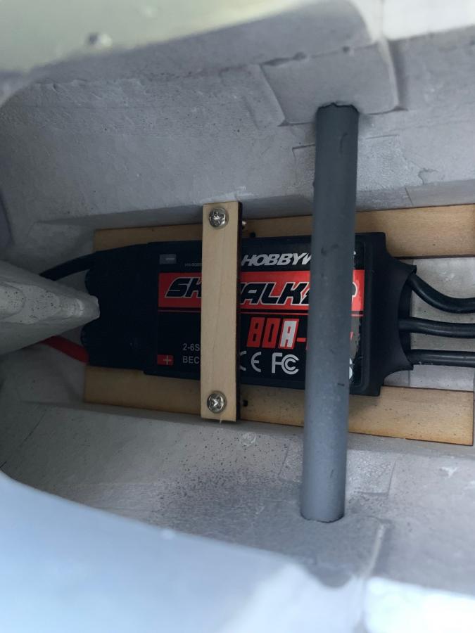

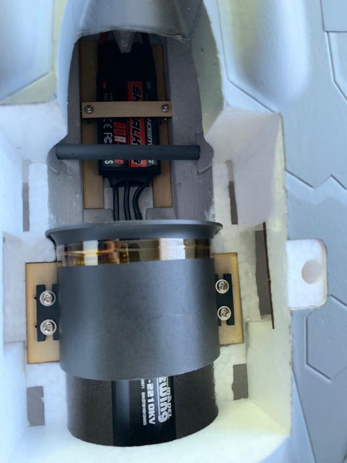

                      Build question: Where does the extra 2 inch piece of plywood belong? I also opened a ticket with MRC and will update here if I get an answer from them first.
                        #2651
                        Did you get an ARF+ or PNP? Typically that piece holds down the ESC.

                                #2655
                                I just posted my photos on the F-35 thread regarding Fan and ESC maintenance. These are the F-35 photos shown as reference below. The plywood strip is used to strap down the ESC with 2 screws.
