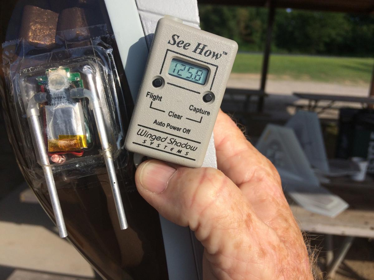

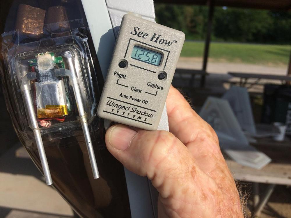

              I have the same setup except a Talon 120S ESC. I can verify the 125mph, attached is a pic after I flew mine with a pitot system.
              Click image for larger version  Name:	IMG_2312.JPG Views:	0 Size:	119.6 KB ID:	213705
                  Yeah I remember reading you had a 1680kv motor in yours too. It actually caused me to swap out the 1400kv that was initially going in. I have that motor now setup with a different 12 blade fan ready to try in the F-15.
                  I can’t wait to ring it out a bit. That flight was basically retrimming and getting the feel for it. Coming out of a turn I pushed it to WOT for about 150-200 yards. There were no dives except to land and I was already configured for landing at that point
