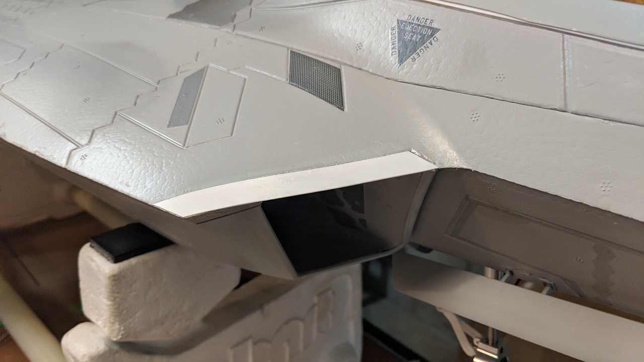

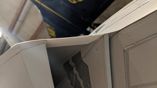

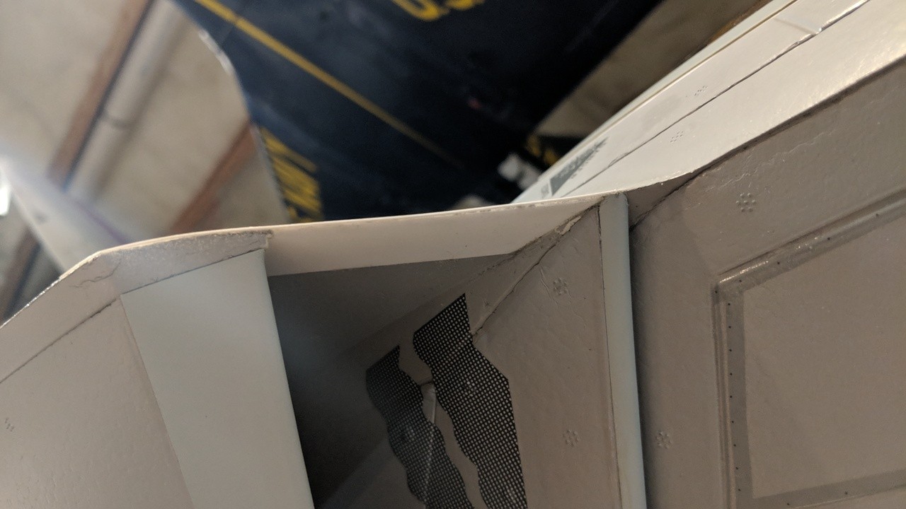

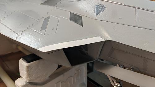

          Intake upper edge inner and outer Styrene strips added to mine because I know I will inevitably damage that thin foam edge if I don't.

                      Now that this is done, we all know this area will remain untouched throughout its lifespan. If you didn't, it'd get dinged on it's way to the car.
                                The carrier in my trailer would not be kind to the thin foam edge. I am less concerned about it now.

                                  You got a link to what you used?
                                    #657
                                    It is just Styrene sheet stock I got from my local hobby shop. Comes in different thicknesses. Commonly used by model railroad enthusiasts. I used about .040" on the inside and some .020" on the outside. Recessed the foam to fit the pieces flush with a brand new xacto blade, glued them to the foam with FoamTac and then CA'd the leading edge joint shut. Sanded smooth with an emery board (nail file) and badda bing! I will paint them later. I will be working on hinging the canopy frame next. Still trying to sort that out and whether I will use a servo or the F-15 dive brake actuator to operate it.
