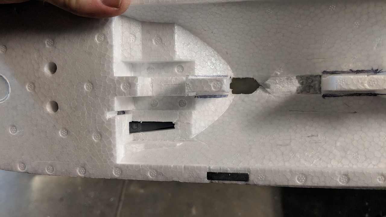

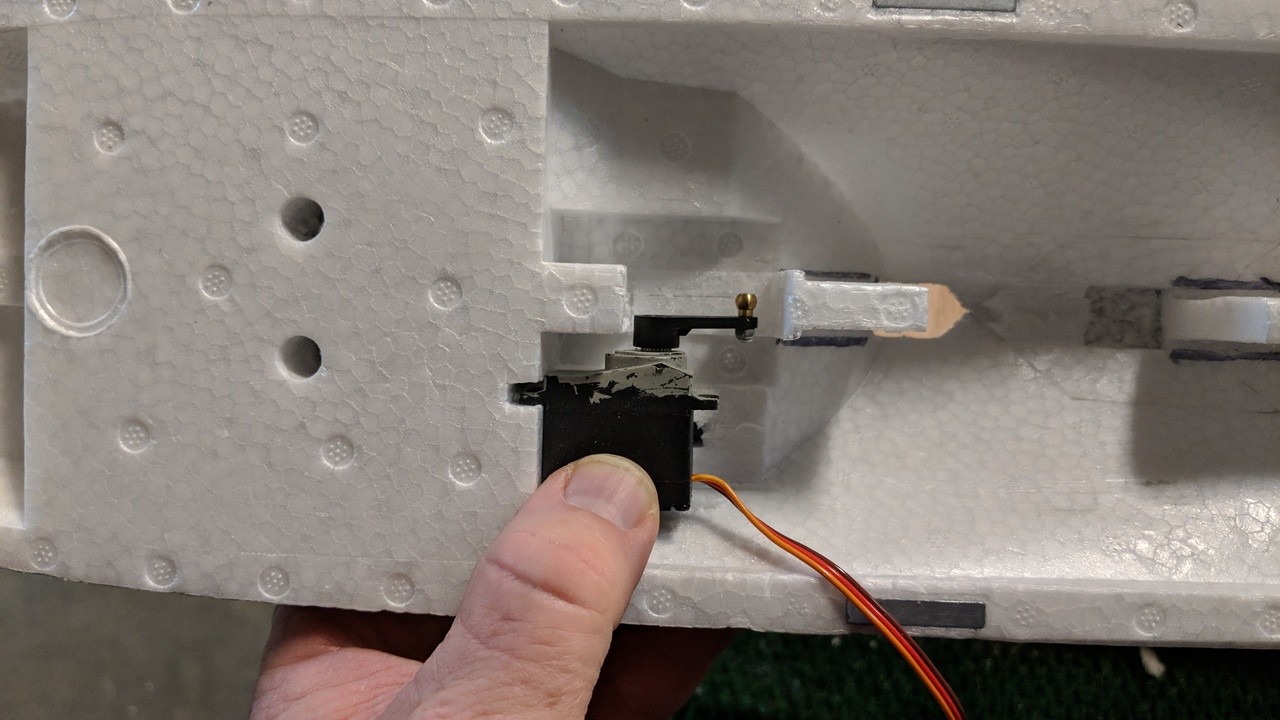

                Need some "eyes on help". On last F22 flight the left side nose gear door departed the plane just as the plane rotated. Right side closed just fine so finished the flight a landed. Didn't hurt the door at all as they just snap in but the left side pushrod and clevis were no where to be found. Servo and horn along with right side linkage are fine. I probably have enough parts to build a new linkage but it would help I knew the proper length to start with. Thanks for any information.

                  I have mine on the bench. The linkages appear to be the same. I feel sure if you make another to match what you have left, it will work.
                  edit: they are the same. 51mm, clevis pin to hole in control horn.

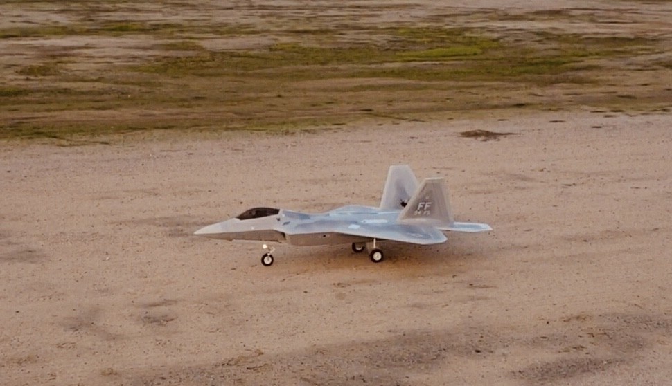

                    Really loving this plane. I took the Raptor for a spin today. Here are the F22 flights:

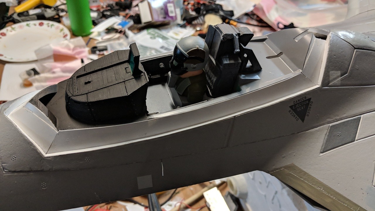

                                Finished trimming around the cockpit with 0.010" thick Styrene. Also got the servo mounting sorted out and designed and printed a clevis to attach a pushrod to the canopy. I am using an elevator servo from the 90mm F-16 and ran my throws all the way up. I have more than 30mm of travel. I need to do some painting next and then just put it all together.

                                  #816
                                  Excellent work Steve! Can't wait to see it finished. Do you plan to have some type of locking mechanism for the canopy, or are you assuming the servo will hold it in place?

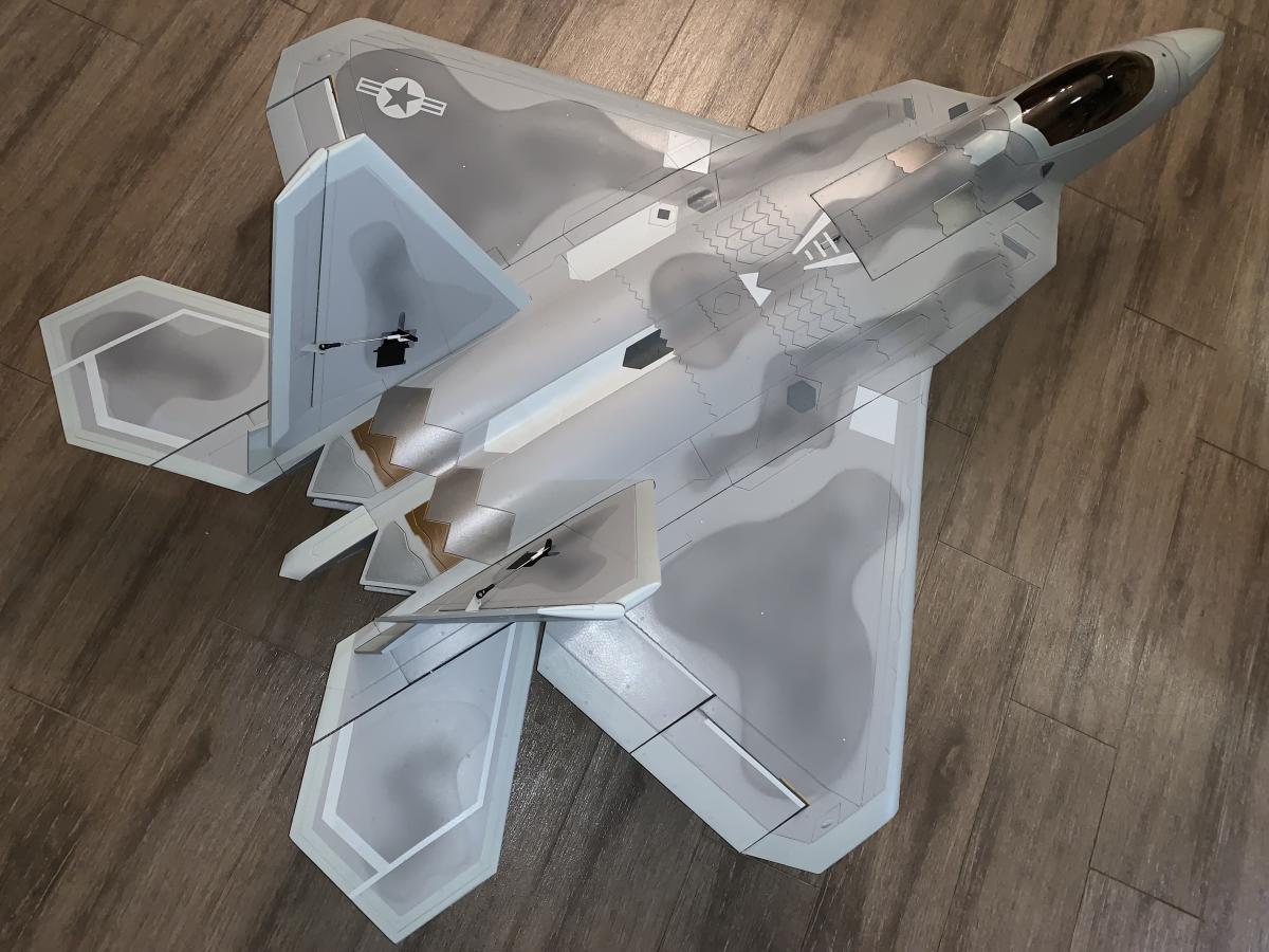

                                    #817

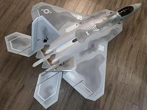

                                    Here's an idea of what the before and after looks like for my panel lines. The top, or left side of the plane, has not been done yet. The bottom, or right side, has.
                                      #818
                                      Good question Pat. Once I have it together and functioning I will be able to determine if anything more is needed. My gut feel is that it will be fine without any locking mechanism because the arm where the servo push-rod secures is a good 3+ inches from the pivot point of the canopy and it is quite strong. If I bottom out or slightly over rotate the push-rod on the servo opposite the arm it will also act as a lock. I hope to find out tonight.
                                        #819
                                        Wow! What a difference.
                                          #820
                                          Once I'm done with the panel lines I'm going to hit it with a coat of Testors Dullcote to seal in the charcoal on the panel lines, and protect the decals as well. It will also knock down the "shine" on the decals for a more scale look.
