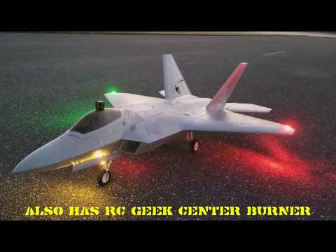

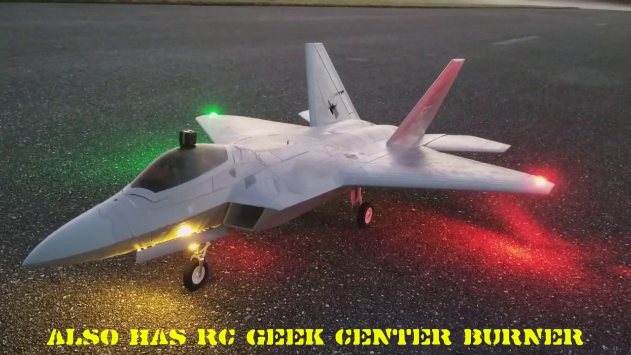

            I didn't add lights to the wings, but I did nav lights and strobes and a beacon on the fuselage. It looks pretty cool! Looking forward to a smooth maiden... A pic or two to follow later today. Happy New Year to everyone, and I hope your Christmas was blessed with joy and love and lots of family and friends!!! Jerry

                Hey Steve, which lights did you use for the nav lights? I noticed they shine up as well as down nicely. Was going to use lights I stripped out from an A-10 carcass but not sure now. Still waiting on the plane to get here so just putting my ducks in a row.
                I used a set of wing lights from a crashed Avanti and purchased off of eBay some additional 1W LED's just like them and added an extra LED to each in parallel. Each wing has two LED's, one on top and one on the bottom. I did the same for the strobes using Strobon V2's. Each wing has four LED's in it. Two on top and two on the bottom.

                                    So are the blinking ones white strobes like Steve's or two more red and green that blink? Awesome flying...almost thought you grazed the runway on that first low pass!

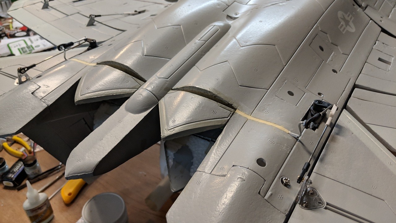

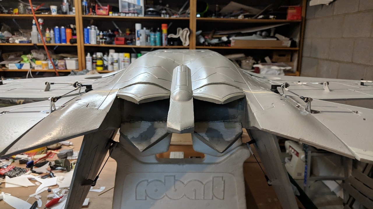

                                      Evan, your TV mod inspired me to do likewise on mine and it is awesome. I just had one of the most exhilarating flights with it. I felt so in control and just lumbered around doing back flips and Cobras. I am still feeling the adrenaline rush! Thanks for the inspiration!
