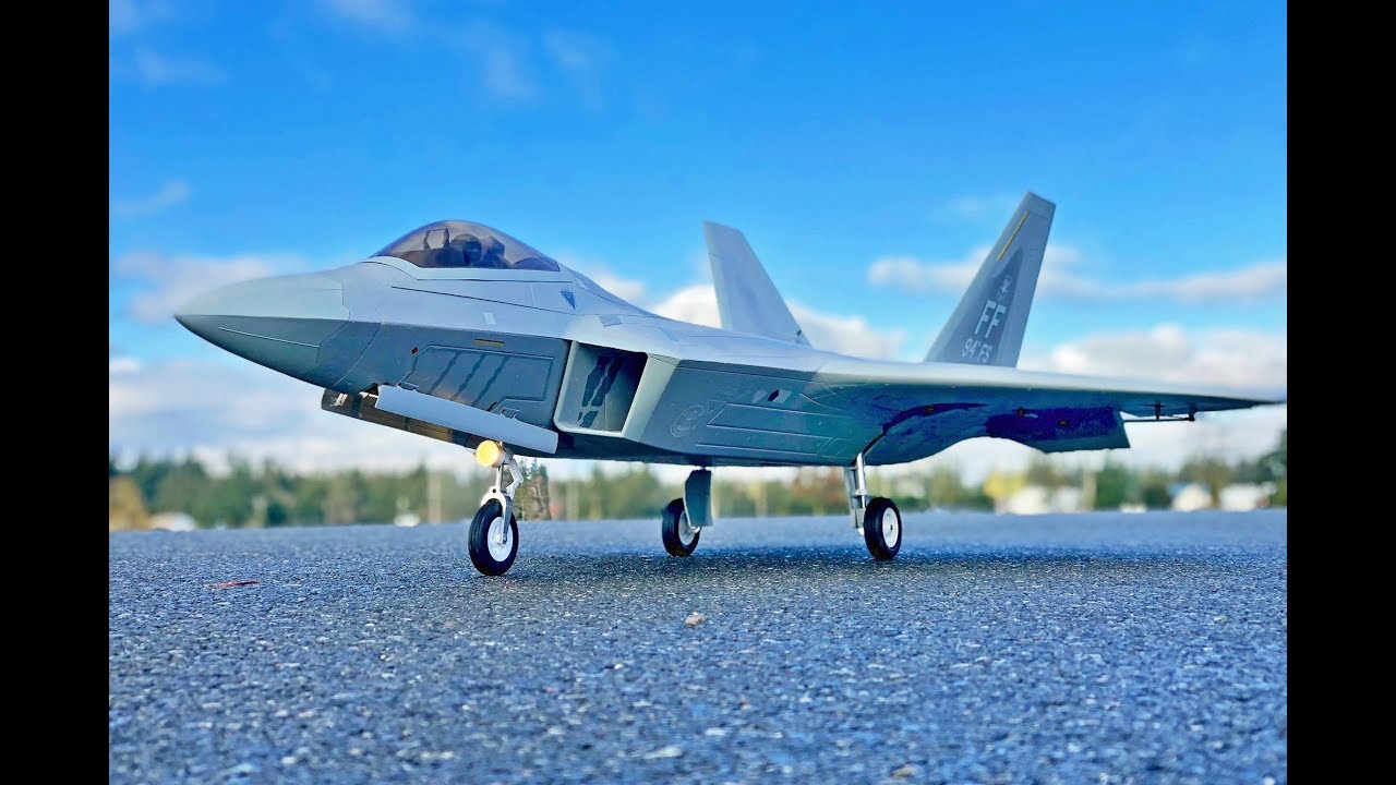

                        • Wondering what color grey you guys are using to touch up the F22? Think a primer grey would blend ?

                              • Originally posted by TRMRC View Post
                                xplaneguy kindly posted these from Home Depot a while back.
                                Tom
