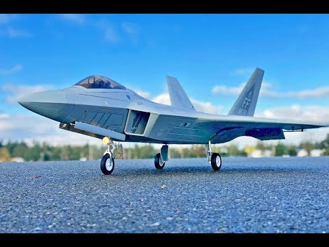

    Yeah, George just didn't like the spokes in the stock nose wheel. I swapped mine for the F-16 nose wheel and it seems fine. Others have gone further and changed out the strut and fork etc...
      #1162
      I can't believe they used that spoked wheel when they had both the F-16/F-104 nose and main wheels that would work and look so much better.
          OK, cool. I destroyed my F-16 main wheel in the crash, but I just happen to have an F-16 nose wheel in the parts bucket that I will use this time. My replacement Raptor arrives on Monday.
            Thanks for the info! My Raptor arrives this weekend and will be planning on doing the swap. Also looking at cutting some height off all the struts, as it sits a bit high for an F-22.
                    Just to echo this, I got 4 flights on my F22 today with the F16 nose wheel and had no issues with rotation.
                                        Delta, the too tall stance of the model has bugged me since I saw the first photos. How do you plan to shorten the struts?
