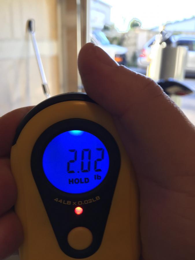

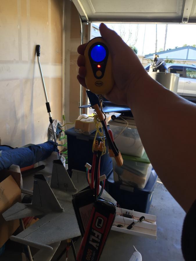

                              These are 459g each. Add a series adapter and you are 920g or more. That is not light. Look at the 8S 5200 pack at RCJuice.com
                              Youre right on the money ... exactly to the tenth decimal 2.02 lbs
                              though thats not all for safety overkill i will add a seperate 10A CC bec sourced by an additional 2s 1300mah lipo and add a 4000uF bypass cap to a spare port to resolve any sort of potential bec output conflicts from the output of the buck regulators step down to 5V, just incase one bec fails in a low heat dissipated bec via 2s independent supply across the ir drip of the stock regulator from the higher potential 8s to 5V step down would provide a nice safety net if needed.

                                50 years of metrology??? Or just lucky???? :)
                                the Hobby Star 5200 8S is going to save you 2.6 ounces and four fewer electrical connections that add resistance. And add 200mAh more flight time (probably 15 seconds max)..
                                But I realize 8S is not practical for everyone...
                                Specifications:
                                • Capacity: 5200mAh
                                • Voltage: 29.6V (8S)
                                • Discharge Rating: 45C
                                • Charge Rate: 2C
                                • Wire: 12AWG
                                • Connector: XT90
                                • Balance Plug: JST-XH
                                • Dimensions: 133x43x67mm
                                • Weight: 855g

                                  Yup your zero error weight prediction is quite scary indeed :)
                                  i never had the intention to get a bigger jet im more of a warbird Ww2 junkie but this model reminds me of a raptor flying out of PDX portland back in 2008. I knew i would have to acquire this model in to the tengarang fleet
