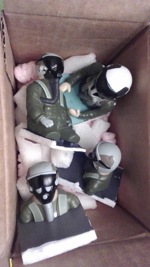

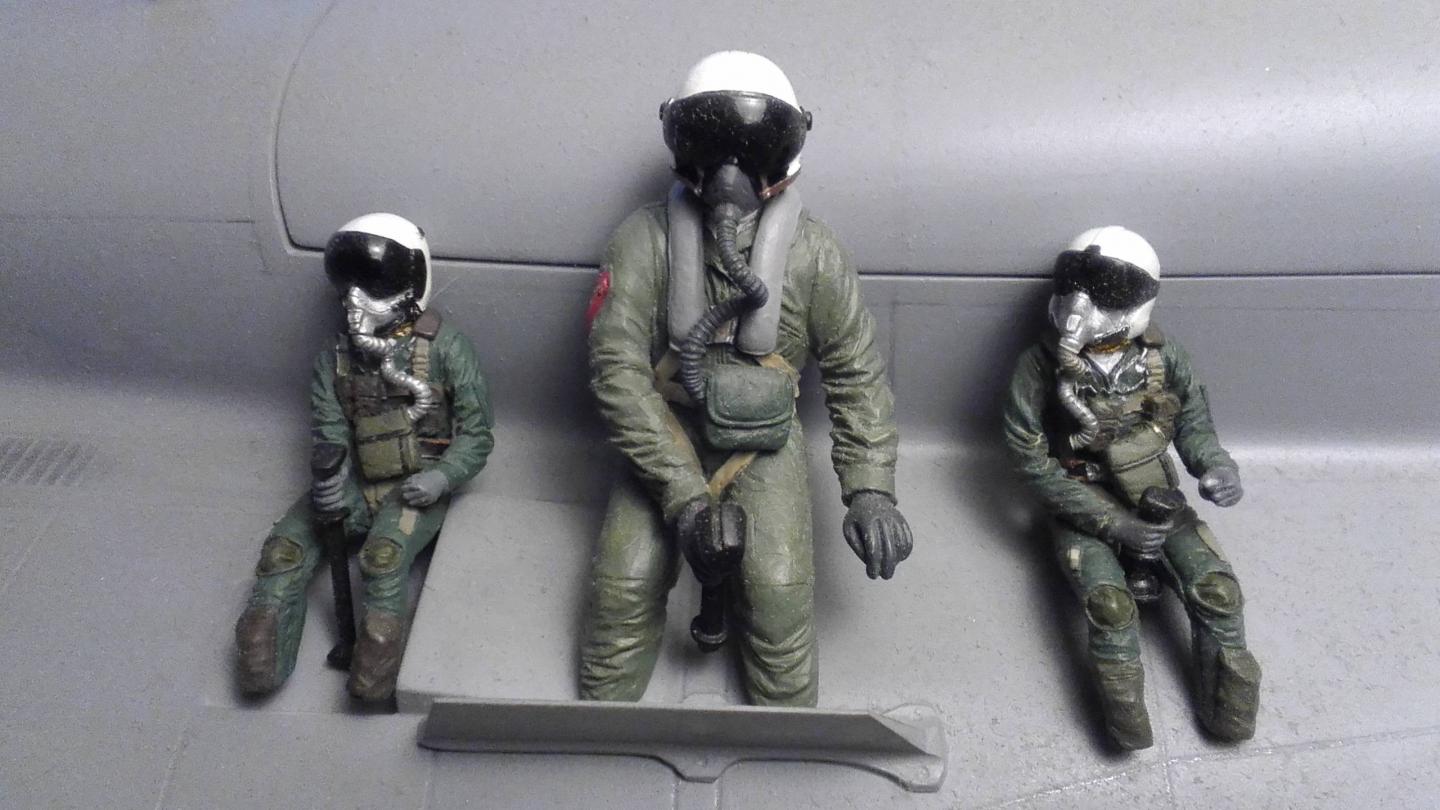

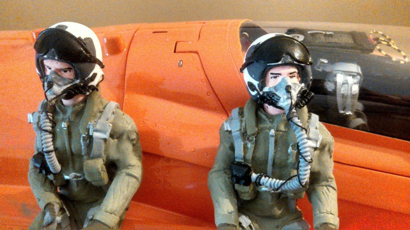

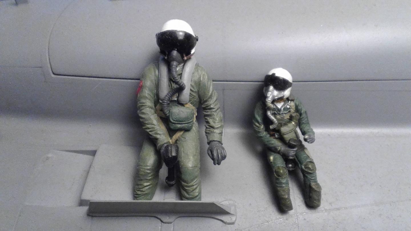

                    The 1/12 guy from JHH is the only readily available figure I know of. He's done pretty well but is only a bust, so I added the rest of him... Their 1/10 full figure (does that sound wrong?) is good in the A-10. I thought the Venom pilot was fine just as he was, but things have gone downhill since. Come to think of it, the guys in the F-4 look ok from what I've seen, though I don't (yet) have one.

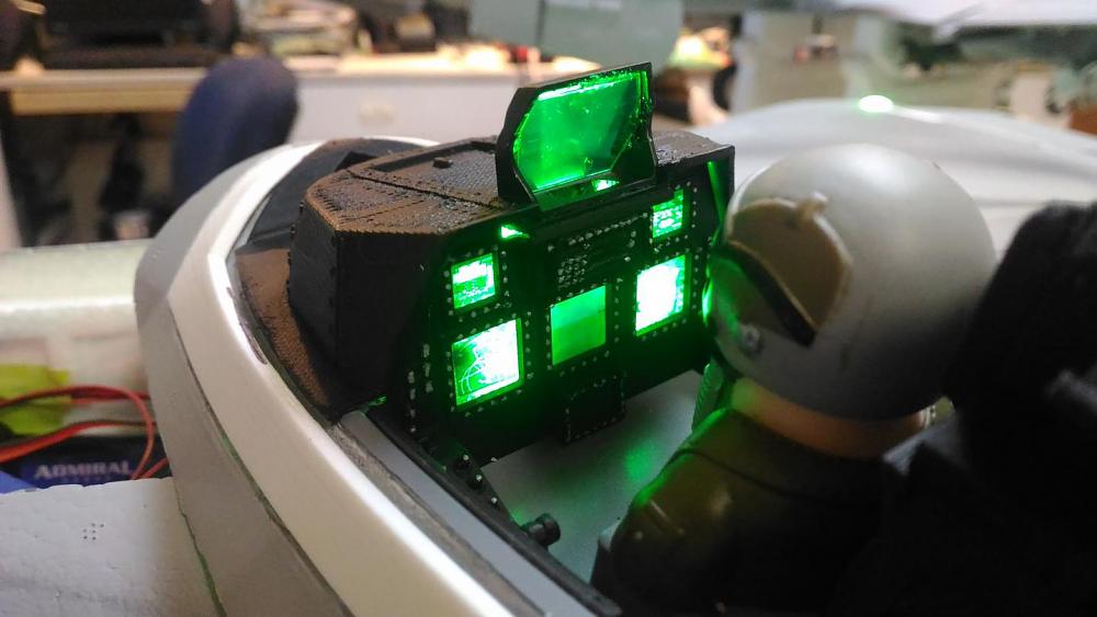

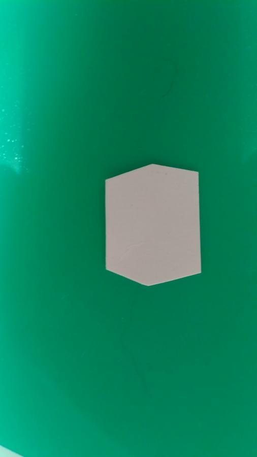

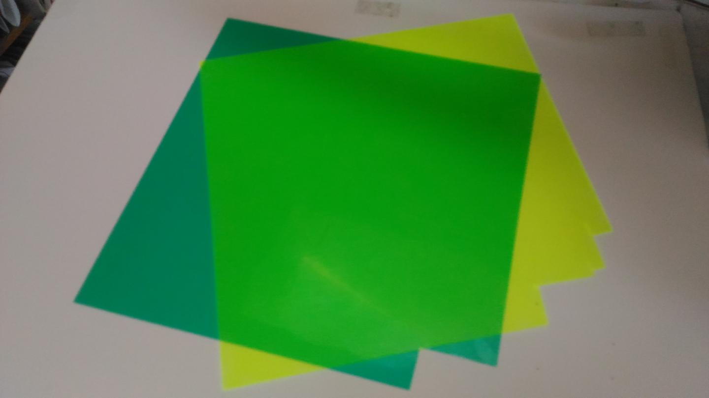

                      BTW here's the two colors of the lexan sheet I used for the HUD screen. As you can see, those two colors together look pretty close to the real deal. There is a pic of the little cardboard pattern I used to "get close". The material is thin enough to cut with a decent pair of scissors. For the light I used a green nav light I stripped out of an old carcass pointed up from bottom behind the instrument panel like Tom did except I pointed mine straight up to not only back light the panel but shine through a hole in the "dash" to light the HUD screen. I may try adding a tiny mirror at the base of the "dash" to reflect the light through the screen and forward. Hope this will look more like the real deal as I'm sure many have noticed that laser like green light visible as the real plane flies toward the camera.
                          I like it Brad! Your nav light trick sounds sort of what I did for my HSD F-16...Nothing radical in the way of scale detail, I just liked seeing it lit up when the battery was plugged in. LOL
                              Great minds.;)

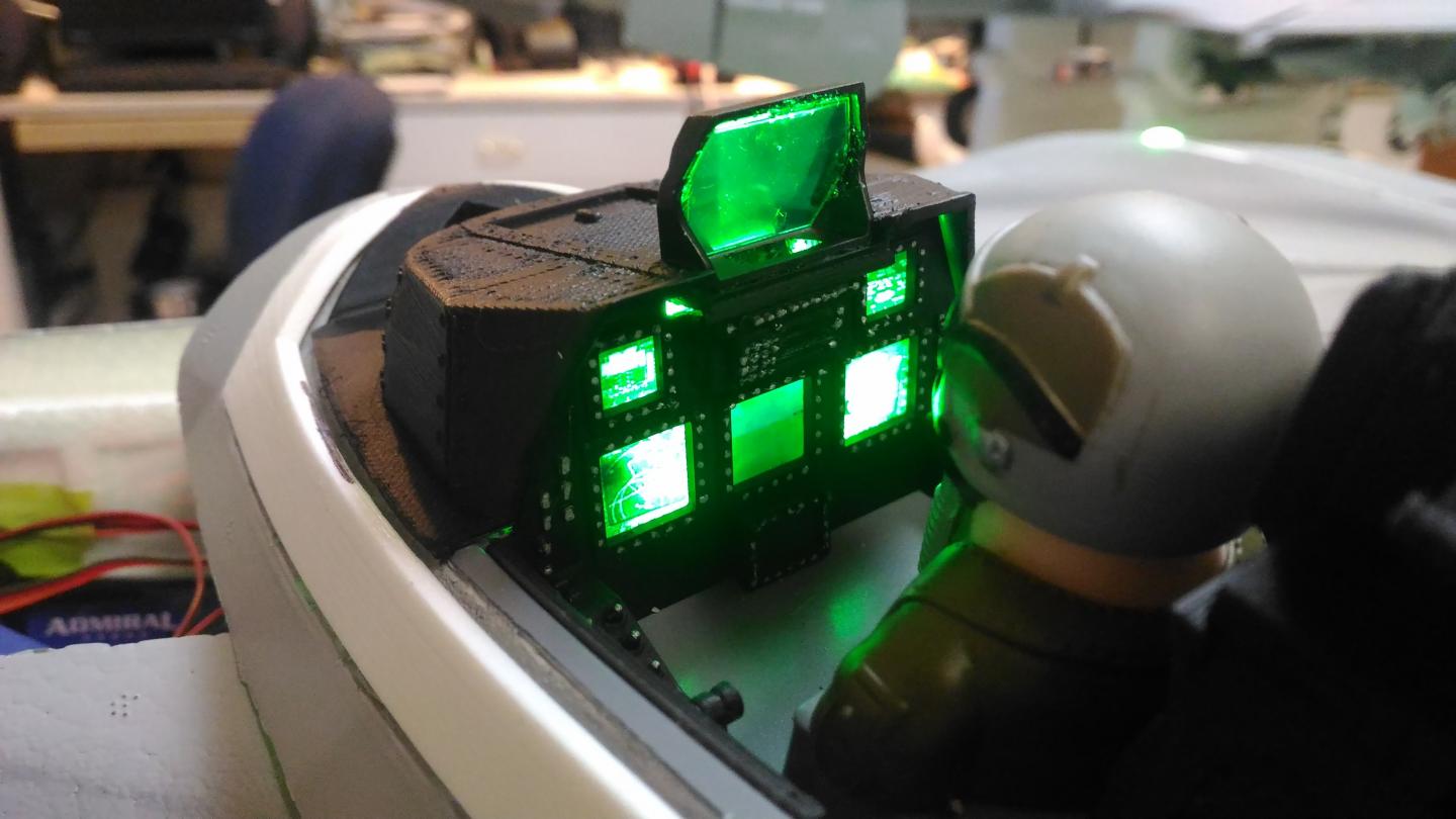

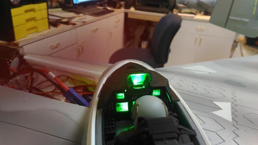

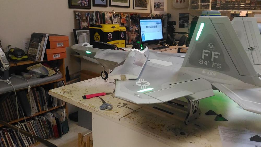

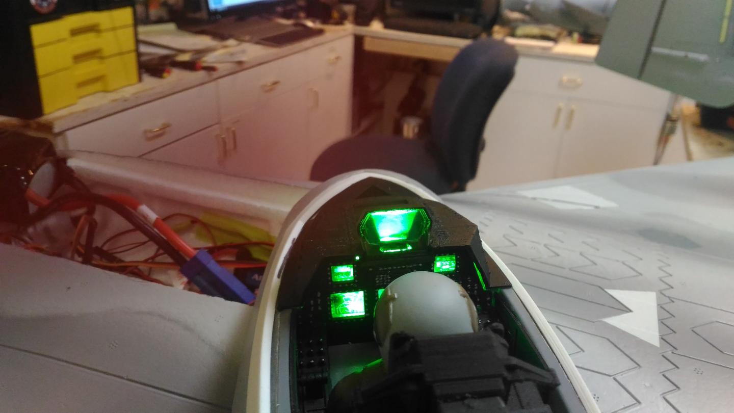

ID:	182390Click image for larger version  Name:	P_20190301_183328.jpg Views:	0 Size:	85.7 KB ID:	182387Click image for larger version  Name:	P_20190301_183352.jpg Views:	0 Size:	116.5 KB ID:	182389 O.K. put a piece of cardboard down between the led and instrument panel to calm the light down and carved out the verticle "tunnel" up to the main console so the HUD and other panels wouldn't be blown out. Added a pic of the formation lights but still no nav lights or video 'til I get the new blue box.:Straight-Face:

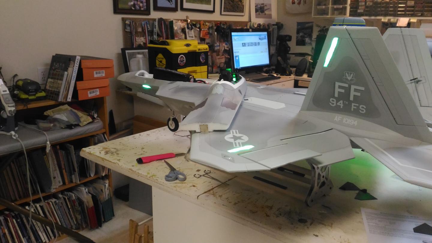

                                  [ O.K. put a piece of cardboard down between the led and instrument panel to calm the light down and carved out the verticle "tunnel" up to the main console so the HUD and other panels wouldn't be blown out. Added a pic of the formation lights but still no nav lights or video 'til I get the new blue box.:Straight-Face:
                                  Hey DL
                                  did you already share your light setup? Just wondering if you have installed LEDs in the verticals or are these the chemical lights stuffed in the slot under plastic lens.

                                      Hey DL
                                      Rich
                                      These are the formation light kits provided by Jeremy Solt. They include the lights in the verticle stabs, the wingtips and just below the cockpit. You have to assemble them, solder all the connections, and cut them into the various positions. It takes some time but very cool. My shot was too close...they look better from a distance plus I haven't cleaned up the edges yet. Still a work in progress.

                                        Looks great Brad!

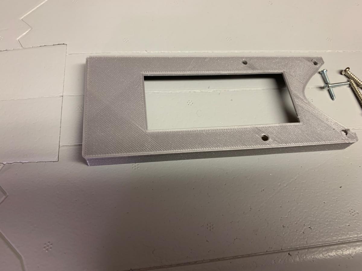

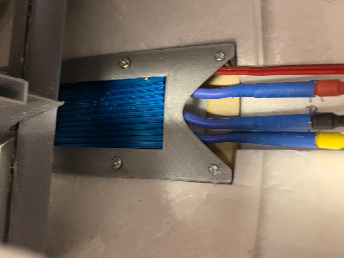

                                          Started the assembly of the Raptor today. Besides the already discussed "streamlining parts" I designed a 3D printed cover for the ESC to improve the airflow a bit more. In case anyone is interested, let me know, and I will share the file in the 3DP thread. An afterburner light has been installed as well, it's a German design drawing the power from the flight battery. No need to mess with an extra battery.
