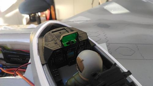

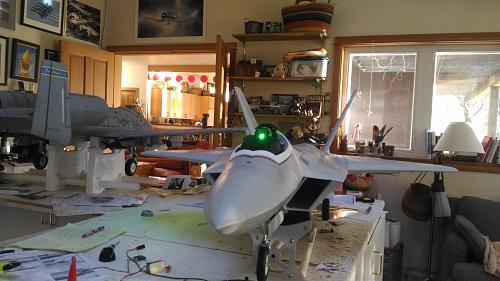

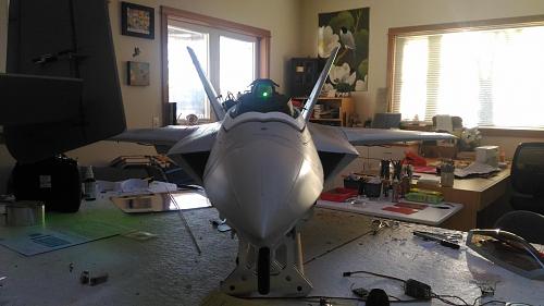

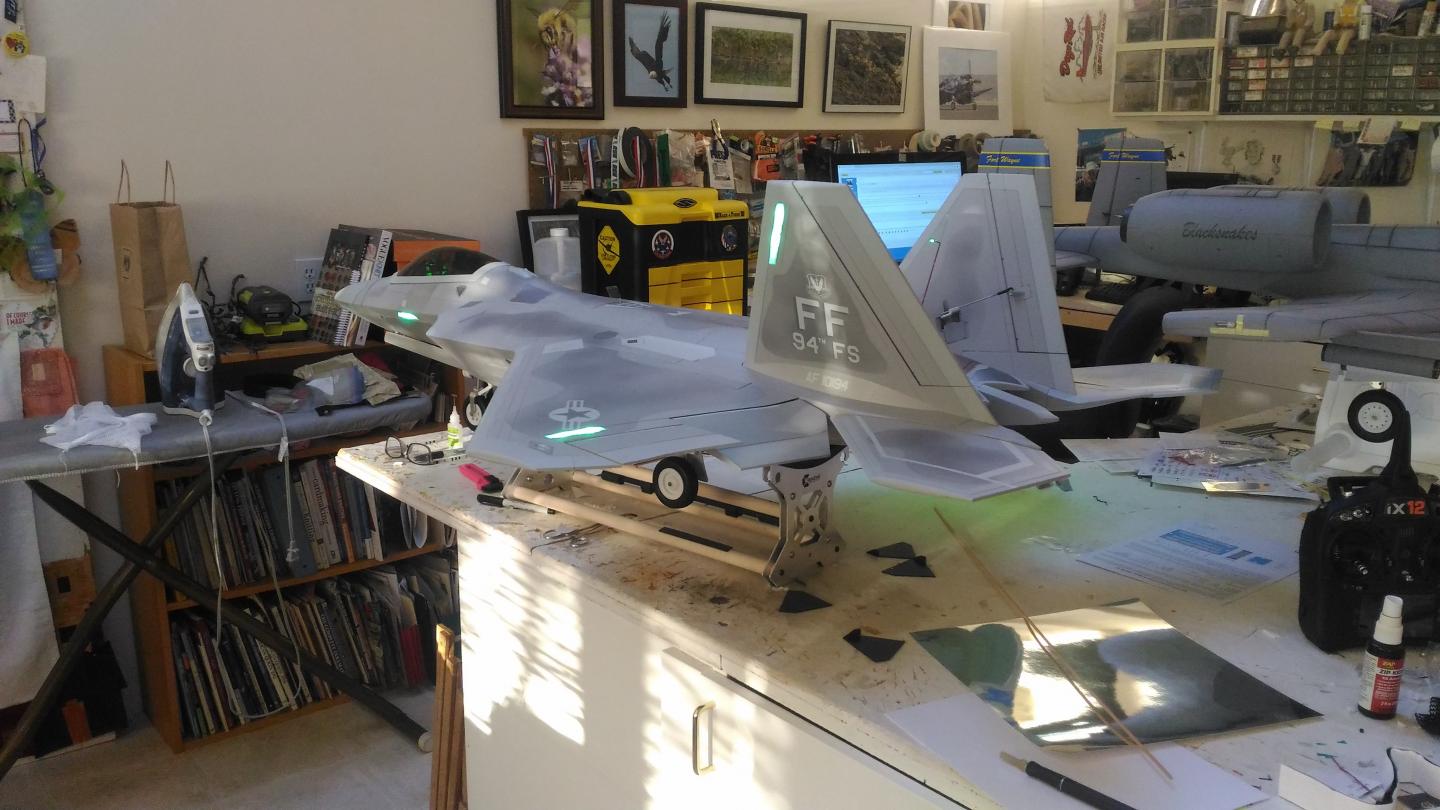

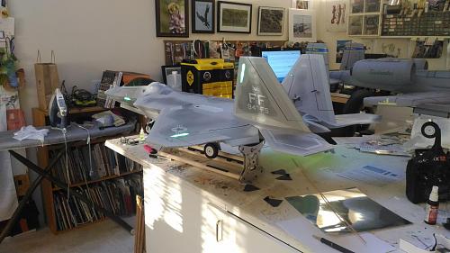

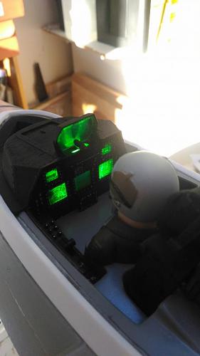

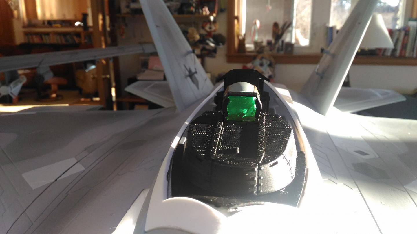

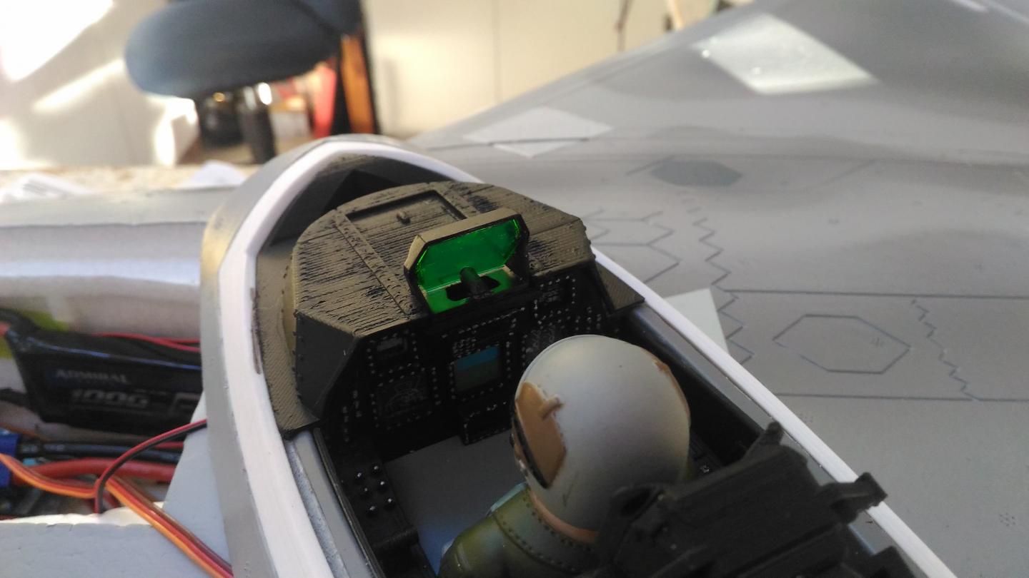

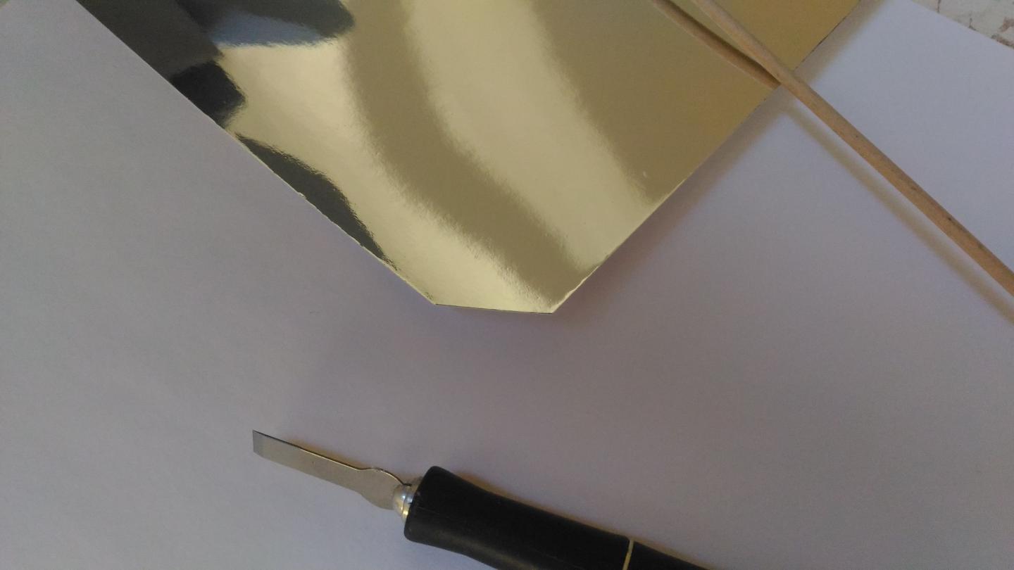

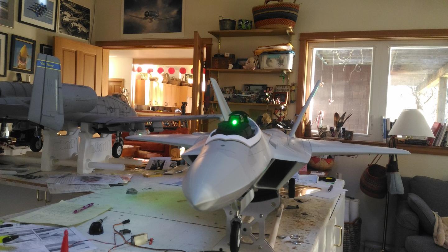

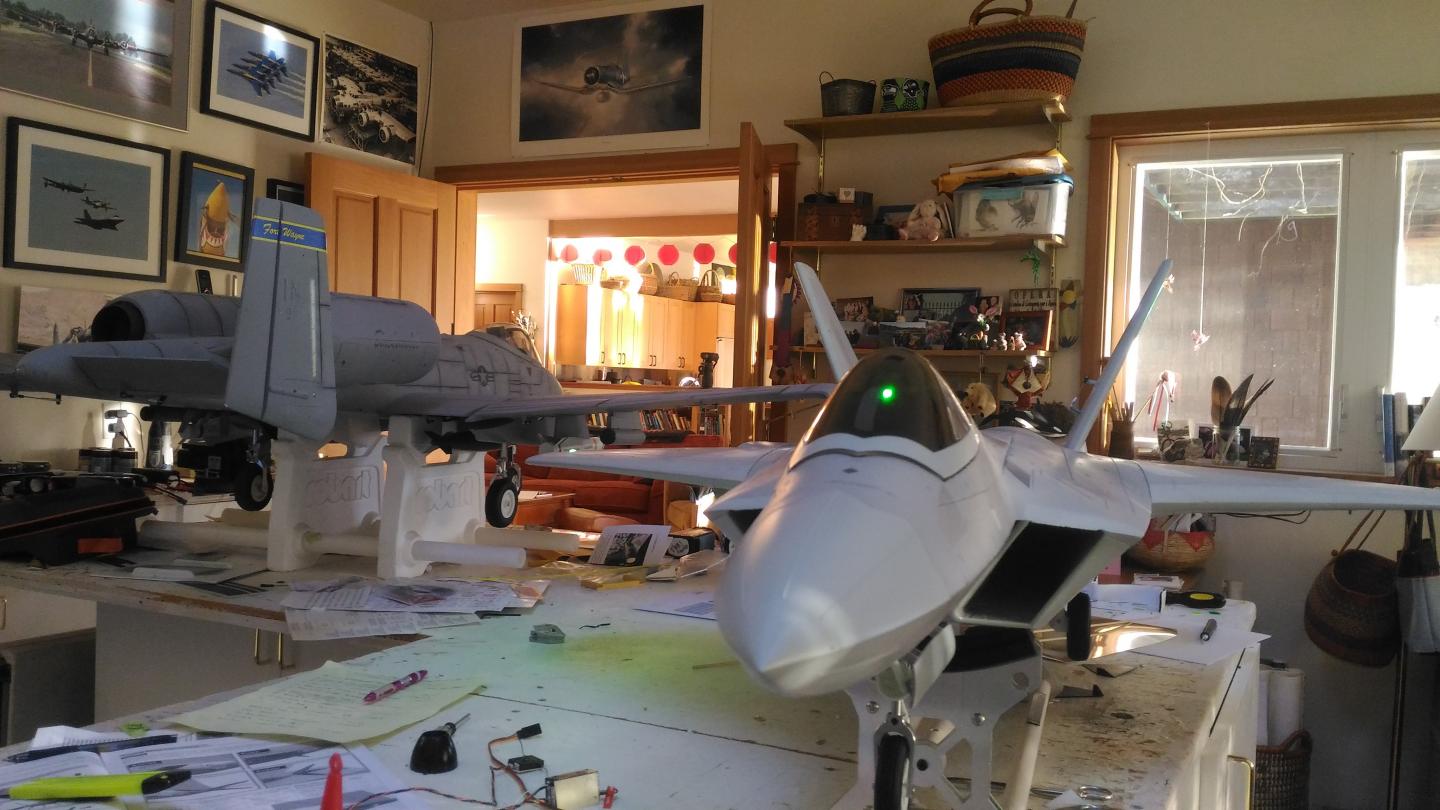

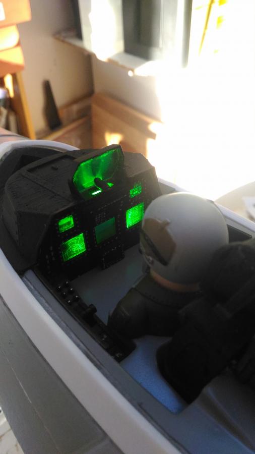

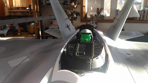

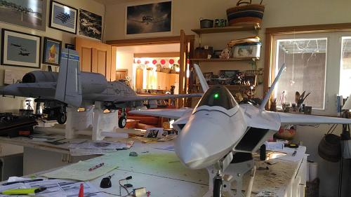

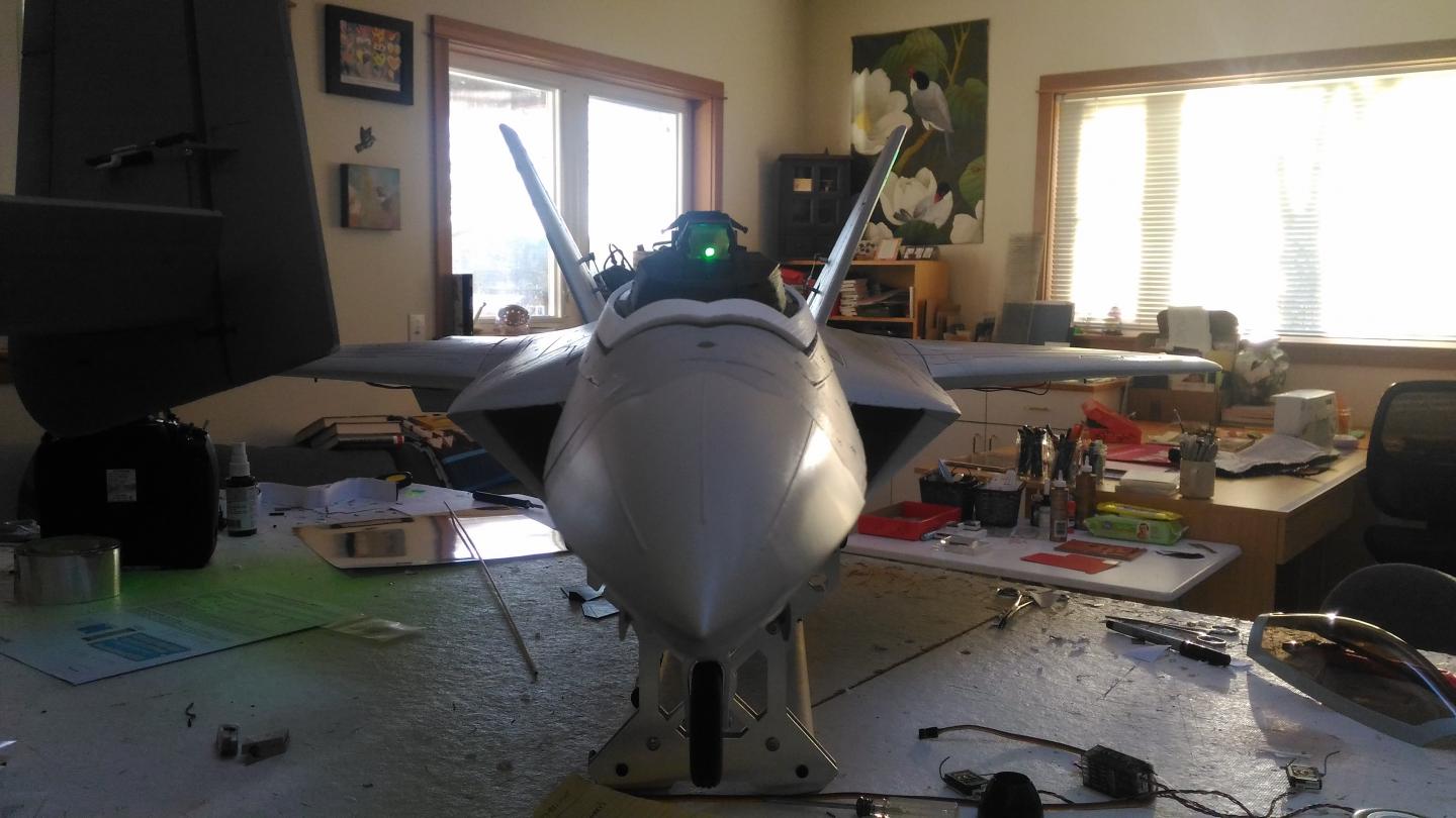

                  Click image for larger version  Name:	P_20190302_165739.jpg Views:	0 Size:	84.6 KB ID:	182562Click image for larger version  Name:	P_20190302_165825.jpg Views:	0 Size:	94.4 KB ID:	182563 O.K. sorry for the pic flood but I was on a roll today. These show my new little addition. A piece of 1/8" dowel cut on a 45 degree angle at both ends with some reflective art sheet glued to the end facing the HUD. This piece is glued to the "dash" to reflect the led through the HUD screen to be visible from the front like the real deal. I used the foam tac adhesive so I could monkey around with it to get the reflection aimed dead center to the front. Click image for larger version  Name:	P_20190302_165944.jpg Views:	0 Size:	33.4 KB ID:	182564Click image for larger version  Name:	P_20190302_170134.jpg Views:	0 Size:	115.5 KB ID:	182565Click image for larger version  Name:	P_20190302_170331.jpg Views:	0 Size:	134.4 KB ID:	182566 O.K. these are with the led turned on during the aiming process. I fussed with it for awhile to get it straight down the nose. Click image for larger version  Name:	P_20190302_170404.jpg Views:	0 Size:	142.7 KB ID:	182568 And this is what you see after the canopy is in place(just laying there). Don't know if you'll see it from the air but for sure taxiing. Click image for larger version  Name:	P_20190302_170436.jpg Views:	0 Size:	54.5 KB ID:	182569Click image for larger version  Name:	P_20190302_170512.jpg Views:	0 Size:	140.7 KB ID:	182570 Here's the 1/8" dowel, the reflective art paper, and the #17 exacto blade mentioned earlier. Hope that is some help. I look forward to the improvements that other more creative people will build off of this but ya' gotta' start somewhere.:Cool:Also, I've got a ton of the reflective art sheet and the LUD screen material laying around if anyone wants to try their hand.

                            Brad, I'm glad you got your camera working as the photos are super and your Raptor is looking great- love the "slime" lights!
