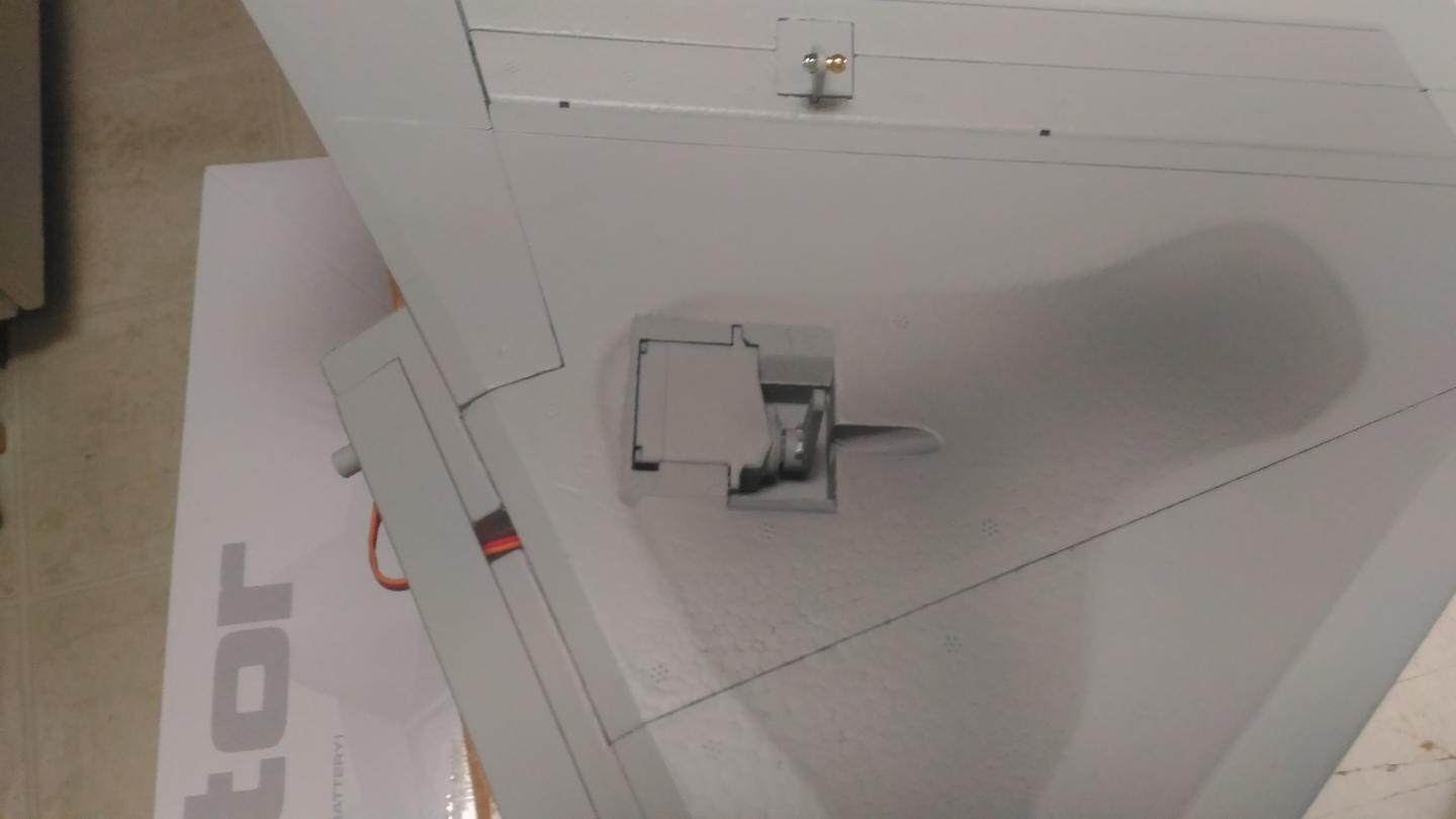

    I made some servo covers from thin fiberglass sheet and painted them with the darker of the greys from HD that Xplaneguy kindly provided. They're glued in place and blended into the existing paint with light and dark grey pastel chalks as airbrushing ain't (yet) my forte.
    Tom
    Nice job Tom. I cheated and just painted the servo, however I have often thought about making a "hood" if you will that would cover the servo horn and rod back to the control surface horn. But I feel buried by all the other mods so it probably won't happen unless someone like Steve or George or some other creative person develops one and makes it available to the rest of us poor schlubs that have no time. I noticed the real plane has something like this for the rudder control rod.;)

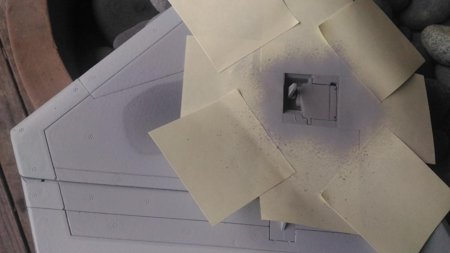

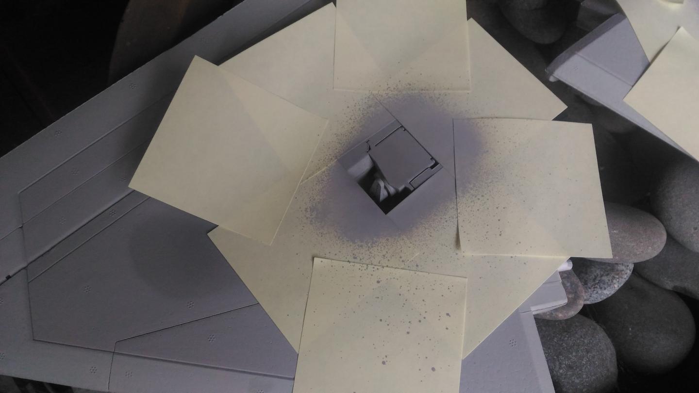

                    • O.K Here's how I short cut the servo covers and what I painted the servos with plus the ever popular sticky notes.
                      • Looks like a good match Brad, and I happen to have that very rattle can in my graveyard of cans! LOL

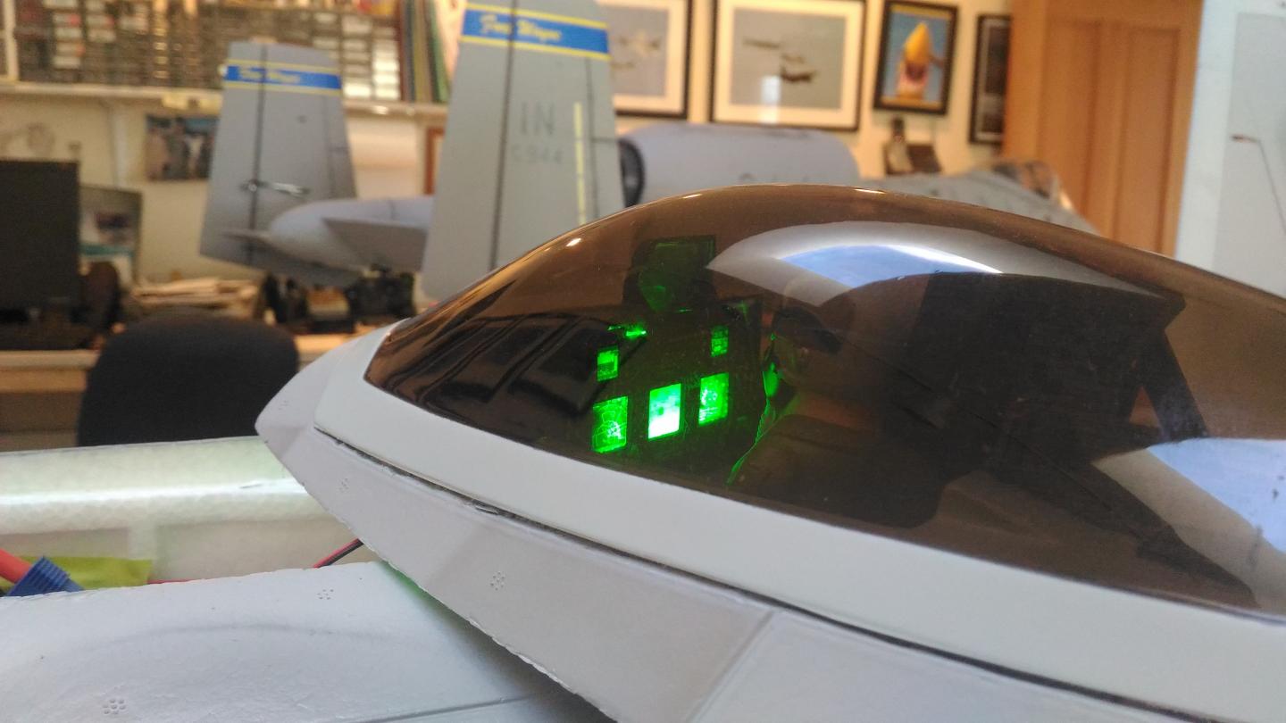

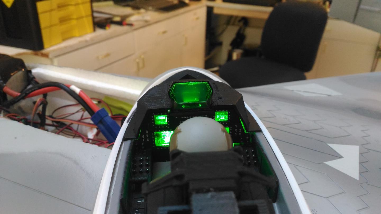

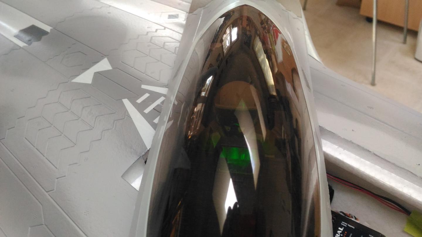

                        • Yeah, it's actually even a better match for the A-10. Anyway, I got a techy friend to get my phone talking to my computer again so I can post a few pictures. This is just a work in progress for my functioning canopy/instrument panel upgrade/lit instrument panel and HUD. I've got the slime lights and nav lights in too but waiting on the replacement blue box before they can all light up. May get a replacement canopy too since this one has kinda gotten beat up during the process.
                          • That looks sweet! Dammit now I am going to have to do that whole cockpit mod. I was hoping my laziness would prevail. LOL

                                Don't you just hate that? Believe me, if I had a cool place to fly in the winter like you do, these mods would not be happening. However.......:) Let me know if you want some of the colored plastic sheets for the HUD screen. I used one that was green and one that was luminescent. That seemed like a good balance and now I've got plenty if you or anyone else needs some. I got 12" x12" sheets and it only takes about a square inch each.:Cool:
                                • Awesome Brad, I will take you up on that! I just need to get the 3dPUP parts printed by someone...Thanks!
                                    https://www.motionrc.com/products/fr...up-cockpit-set I know of a company that sells those things..... ;)LOLLOL
                                      Yeah Todd, just pm me your mailing address and I can throw a couple pieces in an envelope. I'll send enough for a do over cause there are some fitting issues. I'll throw in a rough pattern too. BTW these pieces are made of something like lexan and they have a protective backing to peel off both sides before you install them. Also you will notice ,if you look closely at the HUD frame, on the two side ears of the frame, there are little bumps that need to be trimmed off with an exacto knife before painting. Don't know what the bumps were for but they wont let the lexan sit flat on the ears. Ask me how I know.:)
