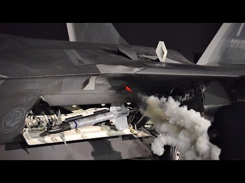

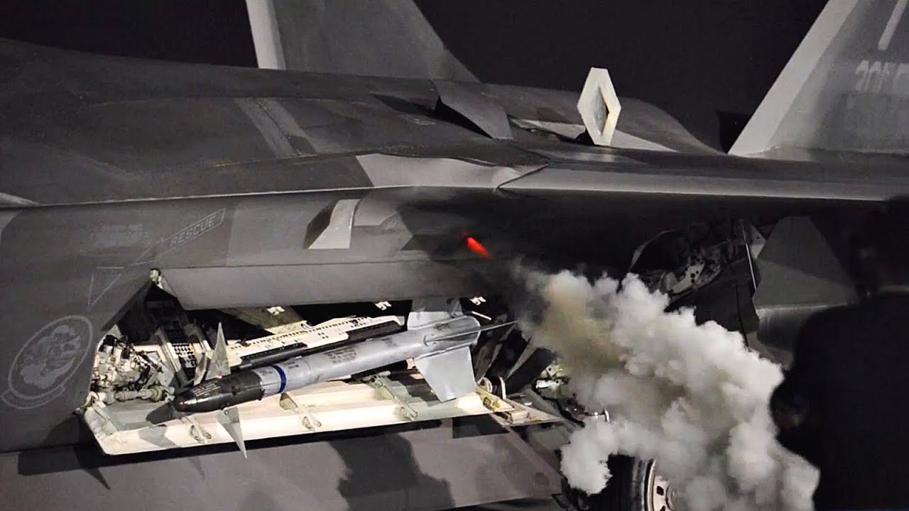

                • Hey Guys, ever wonder what those two diamond shapes on the port wing root are? Well I just found out today. Those are intake and exhaust ports, for a 450hp turbine engine, that open during the start sequence. It is part of the Auxillary Power Generating System for the F-22. So the doors open and there is a quick flash( cartridge starter kind of like the old Coffman starters of WWII) for the startup turbine followed by a release of compressed air( to get the main engine turbines spinning)and then the sound of the main engines spinning up! Awesome sight and sound! I don't have the ability to post this but if you type in F-22 startup sequence, you will get the short but sweet little show. BTW, while all this is on the port wing root, the starboard wing root has a cannon mounted. Check it out!Maybe I'm just the last to know but I thought it was very cool!
                  • O.K. here it is. Check it out.

                      Very cool! Thanks for sharing
                      Rich
                      • Nice find Brad, that is really cool!
