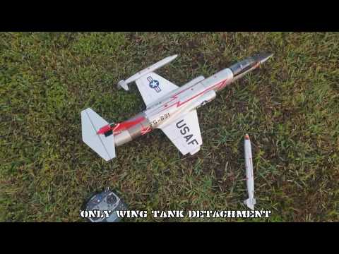

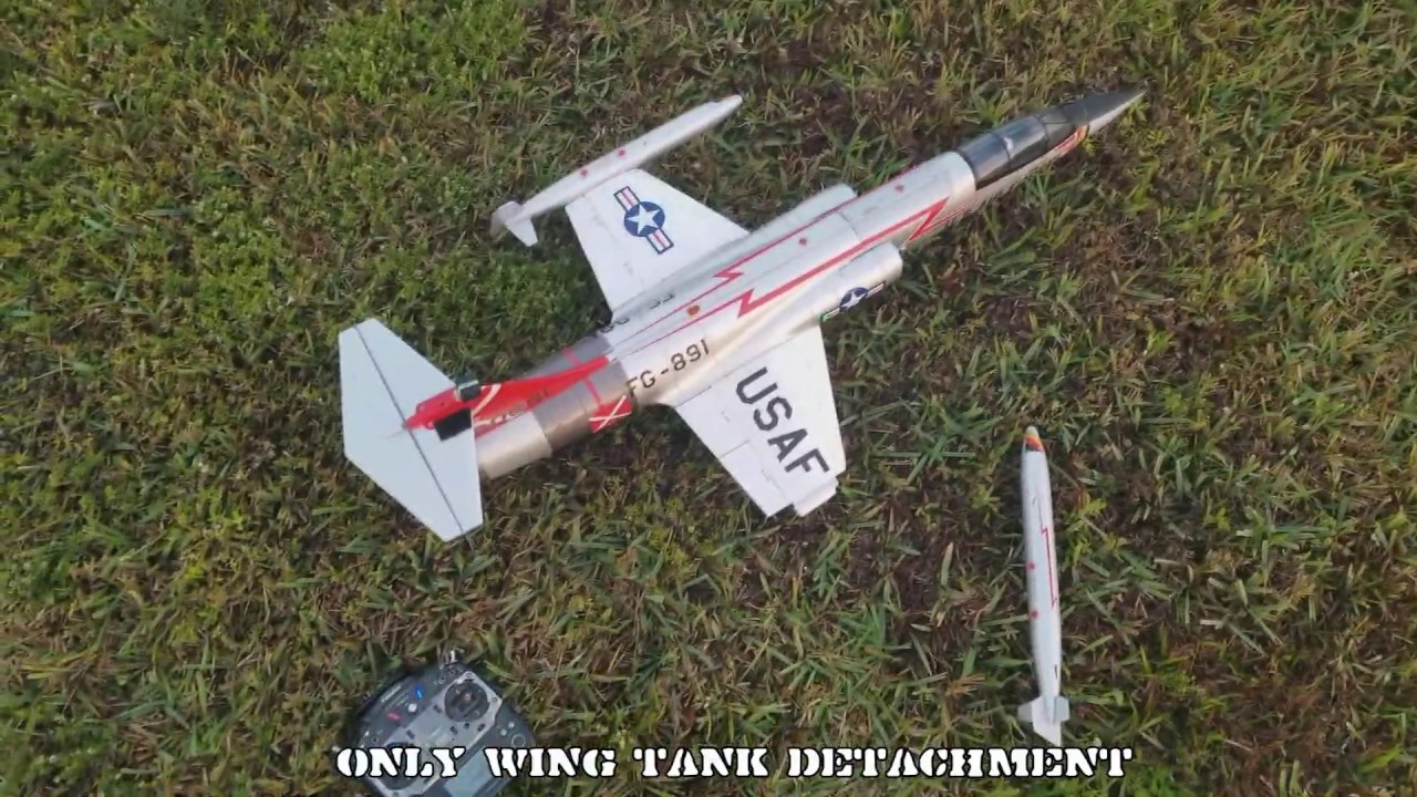

    For those that are aware of my maiden crash and the mysterious right roll and right elevator changing on me, here's what I found today.
    https://youtu.be/e-nhJCU6XX0
    Thank you for sharing your videos and observations.1 Definitely some kind of servo gear train failure.
    FYI the servo with the white, black and red wires is the reversed version servo.
