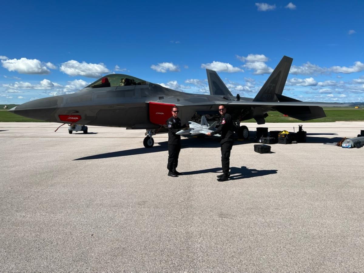

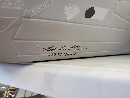

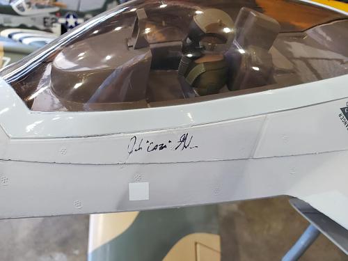

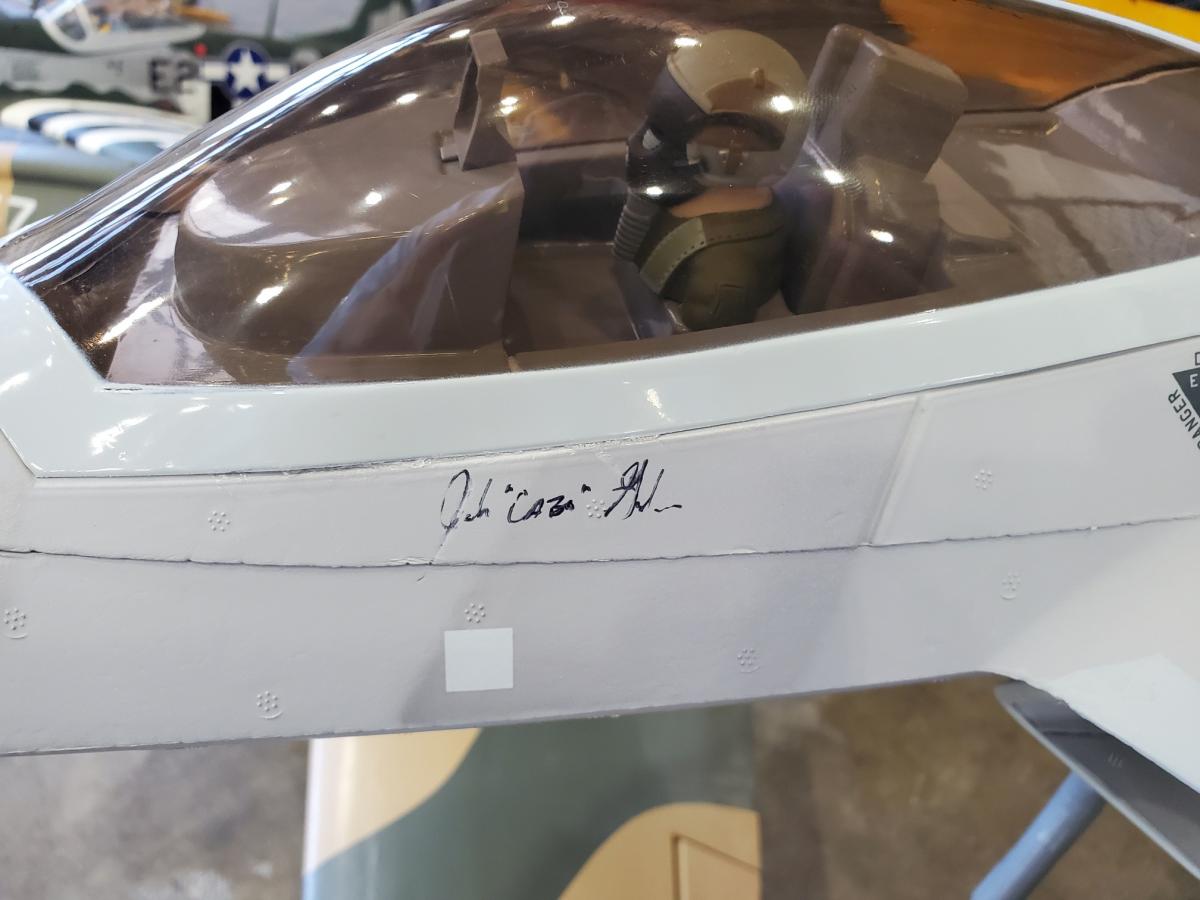

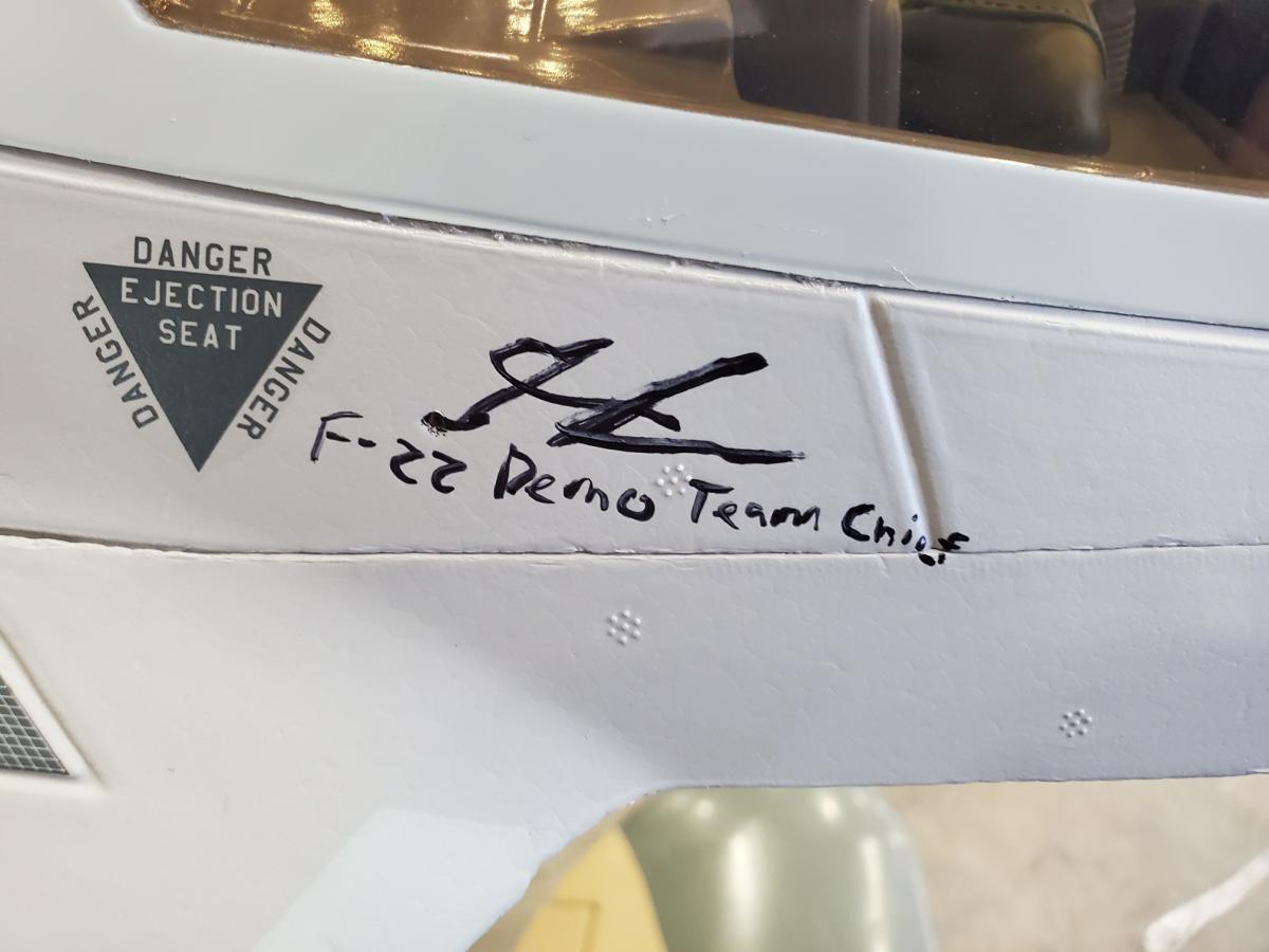

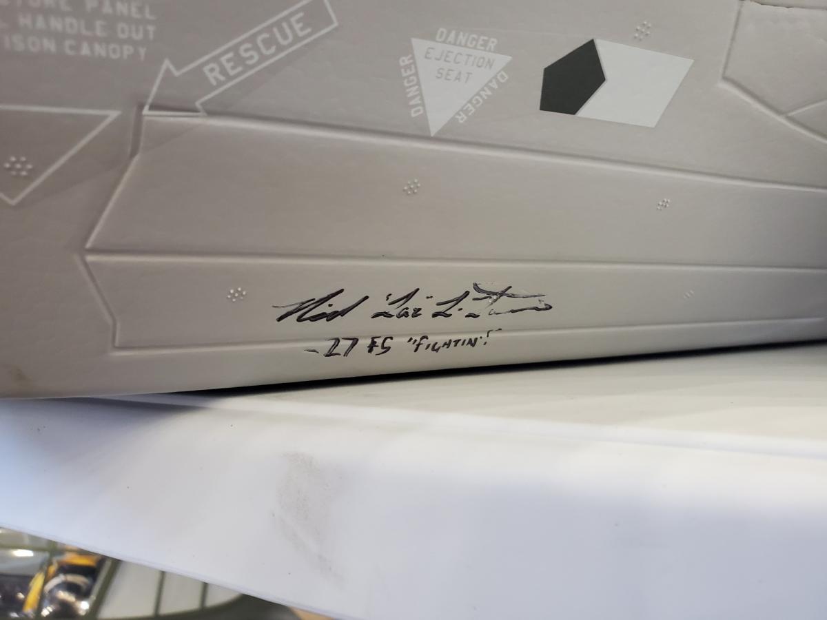

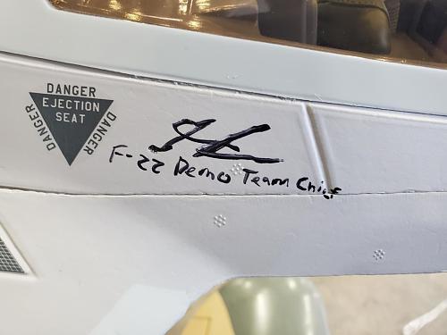

                Here is some fun I had this weekend at Ellsworth AFB with my F22. The F22 Demo pilots and flight crew autographed my plane. What a class act they are. Our club ( Rapid City Propbusters) had a display booth at the show and when I walked up to their promotions tent the crew chief grabbed the plane from me and took it to the flightline. They then delivered it back to our booth a few hours later.
                • How cool is that?!?! Thanks for sharing!

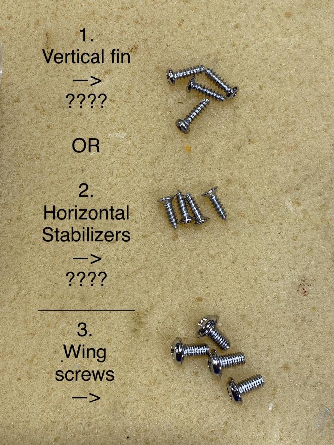

                  • Ok guys, need some help identifying the proper location for these screws. The illustrations in the instructions leave a lot to be desired. In the attached photo are the three sets of screws which I’ve numbered 1., 2., & 3. I am 95% confident that #3 are the wing screws, but I’m not clear on which ones (1 or 2) go to the horizontal stabs or vertical fins. They all call for 10mm screws and they all measure 10mm and my friend cut up the order of the bag before I could properly identify them with the legend. Thanks for the help!
                    • Originally posted by Mud Duck View Post
                      1 = Horizontal stab pivot pins
                      2 = Vertical Stabs
                      3 = Wing screws
                      • P3 install vertical tail step 1 KA3x10mm, your #2
                        P3 install horizontal tail step 1 PT3x10mm, your #1
                        P3 install main wing step 2 PWM4x10mm, your #3
                        • Yes, #3 are the wing screws for sure because they are the only 8mm screws in the kit. As for the others, see page 3 of the assembly manual. It tells you what every screw is called and what lengths they are and how many there are. Use that as your guide. I don't have easy access to my plane or I'd tell you exactly where each goes. You've only got 4 types of screws:
                          KA3x10 (4pcs.); PM2x4 (2pcs); PT3x10 (4 pcs); PWM4x8 (4pcs)
                          You've eliminated the wing screws. #1 and #2 in your picture are the only ones that are 10mm long. #1 is a KA and #2 is a PT. The others can be measured and are different from each other. Notice how KA is tapered on the underside of the head. That's a "countersunk" screw (K is for "K"ountersunk - Google will show you what the head looks like), so you know those hold the verticals on. That leaves the PTs and page 3 tells you where those go.
                          • The pointy taper head screws go into a plastic tube to attach the verticals. The pan heads have flat points to bottom onto the metal horizontal pivot shaft.

                              • Originally posted by Dan McKeag View Post
                                Orsum!
                                • Originally posted by Airguardian View Post
                                  Orsum!
                                  I told the pilots that the model was as maneuverable or more so than their planes and played your latest video for them to prove the point.
                                  • Now that's triple Orsum!!!
                                    Thanks!
                                    How did they react? :D
