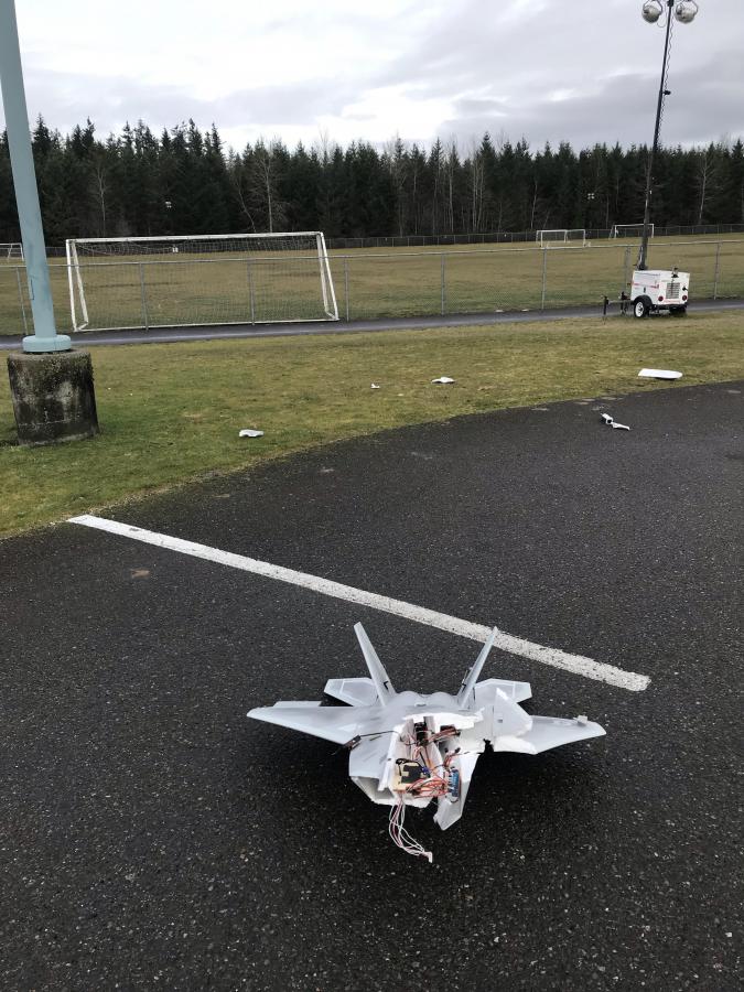

                          #1632
                          Originally posted by RichJ53
                          ...you don't want to take your new jet plane home in a garbage bag :)
                          Why I have no idea what you are talking about!! LOL :Silly::Whew::Angry::Crying:
                            #1633
                            New fuse and a left wing and looks like you would be back in business.

                              #1634
                              You know, when I dumb thumb a plane, I can deal with that. When I had problems with my DX6 and watched planes lawn dart under no control, I can deal with that. When a motor or ESC makes magic smoke, I can deal with that. I can handle all those things because I know what happened and it is part of it and carry on. I, however, HATE and cannot handle what happened on my F22 "maiden" yesterday.
                              Calm day, hardly any wind, great field. Conditions were about perfect. My buddy just got done with his 6S F22 maiden and I was ready to maiden my 8s one. Rollout was great, rotated and started a slow climb out when it suddenly for unknown reasons rolled right all the way to inverted. I pulled the power back and rolled it back over and by this time I was pointing 90 degrees to the right from the direction I took off. Decided to abort the whole deal and just set it back down. Pulled some more power and pointed the nose down to get it back down. About 10 ft off the ground it suddenly rolled right again completely inverted and lawn darted in. Damage is just a canopy and fuse and I am sure by the time the parts are back in stock, I will have calmed down enough about it put it back together.
                              Unknown cause crashes drive me crazy. I maidened another plane after that and thankfully it went well. Also got a few more flights on my 90mm Super Scorpion that I have been dying to fly lately. But, stuff like that will really put a damper on the day! Just wish I knew what in the world happened. I didn't try to rotate early at all and did not try to climb out crazy, just a long smooth rollout to a very conservative climb. Completely baffled but nothing to do besides wait for some parts and go from there. I thought about buying an ARF to make it easier but dang after that price increase, it just more than I can justify.
                                #1635
                                Bummer. Have you checked the direction of your throws? Are you flying with a gyro? What receiver are you using? Just first-responder questions on my part.

                                    #1637
                                    Throws were triple checked by two people, all good. And, it responded correctly when I rolled it back over after the first time.
                                    No gyro.
                                    New Spektrum AR620.

                                      #1638
                                      Sorry to here that Jamesonc, mine did the same exact same thing on maiden total loss ...my next one I'm bypassing the blue box on all control surfaces...

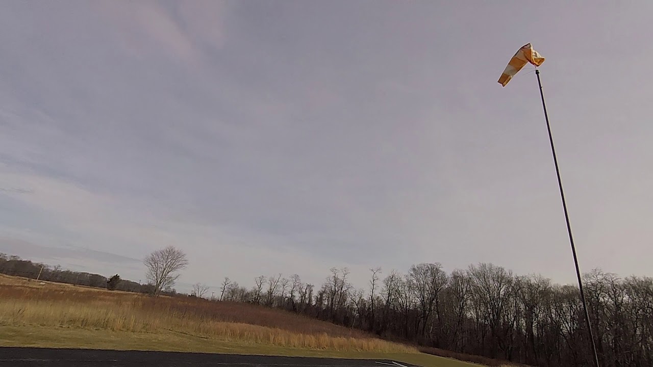

                                        #1639
                                        Love this plane. Even with a 20mph crosswind it landed like a feather.
                                          No gyro.
                                          New Spektrum AR620.
                                          JC........as a techy type myself, I totally get the frustration on the WTF just caused that. ;)
                                          Allow me to put the Rx into focus here as the maybe weak link culprit here.
                                          Since it is relatively new on the market as an economically priced 6 channel with "flyby" integrated telemetry and built in antenna there is minimal experience out there about it.
                                          Being that it has no external antenna, I wonder how many folks shove it into tightly confined spaces.
                                          The Spektrum tech guy on this linked Horizon Hobby vid for the AR620 clearly states starting a the 3:15 mark that this Rx needs about 2-3 inches of clearance from metal, carbon fiber, flight pac and other similar system stuff.
                                          I know that stuff is tight in these birds and maybe...............who knows. :Thinking: ;)
