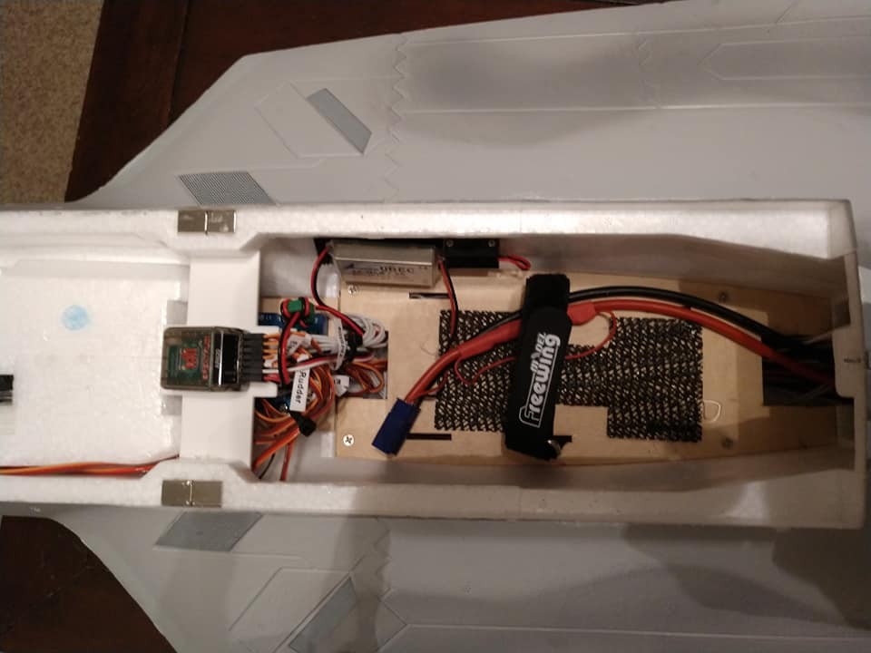

        Originally posted by OV10
        JC........as a techy type myself, I totally get the frustration on the WTF just caused that. ;)
        Allow me to put the Rx into focus here as the maybe weak link culprit here.
        Since it is relatively new on the market as an economically priced 6 channel with "flyby" integrated telemetry and built in antenna there is minimal experience out there about it.
        Being that it has no external antenna, I wonder how many folks shove it into tightly confined spaces.
        The Spektrum tech guy on this linked Horizon Hobby vid for the AR620 clearly states starting a the 3:15 mark that this Rx needs about 2-3 inches of clearance from metal, carbon fiber, flight pac and other similar system stuff.
        I know that stuff is tight in these birds and maybe...............who knows. :Thinking: ;)
        Yeah the way it acted was really really strange and I have no explanation right now. It is truly driving me nuts! For what it's worth, here is how it was setup before the maiden.

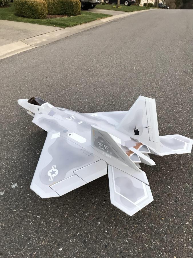

                  Sheeee's Baaaaaaack! :Cool:

                    #1649
                    Click image for larger version  Name:	arfplus_premaiden1.jpg Views:	1 Size:	124.8 KB ID:	175073
                    Cool!! Did you go with the ARF plus or all new? Your still ahead of me as I'm bogged down with the mods. (can't fly this time of year anyway) So far, shortened the gear springs per George,almost done with canopy mod per Steve, waiting on slime lights per Jeremy, half way through cockpit 3d upgrade,waiting on afterburner leds from Chris, will do the spar and streamlining upgrade when afterburner shows up, waiting for replacement nose wheel, capacitor upgrade etc.from MRC. Gonna hold on Thrust Vectoring 'til I've flown it. Life is good!:Cool:

                      After lots of try this try that over the past week Motion RC and I finally figured out that my 6s F-22 just doesn't like my old Spectrum DSM2 AR7000 Rx. I tried a Spectrum AR610X Rx I had on hand and the rudder/steering jitters with the gear switch down went away. That AR7000 is an old reliable Rx so this is all a bit strange but yeah, it is a compatibility issue. Motion RC recommended their rx600 RX with a diversity antenna/satellite. Man those are pretty cheap. Is anyone using those Admiral Rx? Do they have a good reputation? If I decide to stay with a Spectrum Rx is anyone using a basic 7 or 9 channel Spectrum Rx successfully? I am not interested in telemetry and all that. Just a basic Spectrum DSMX Rx. The AR610X I have does not have a satellite and I am not too keen on flying a large, expensive, EDF jet with what I consider to be a park flyer Rx. Thanks!
                        Can't wait to see all your mods! I too am waiting on Chris' centerburner. He must be backlogged pretty good. Hopefully #2 won't meet an early demise like the #1 so I can actually put it IN the jet by the time it arrives!
                        I did get the ARF +. Just added the power system from #1 into it and she's good to go. Guess who will be avoiding light poles like the plague on her maiden!

                          [QUOTE=Aros.MotionRC;n175072]Sheeee's Baaaaaaack! :Cool:
                          Looks great. I assume you installed the Anti Pole radar device.;)
                                Dang it! I forgot to add that!!! :P
