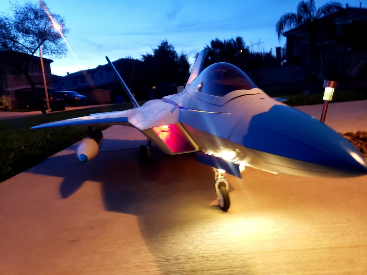

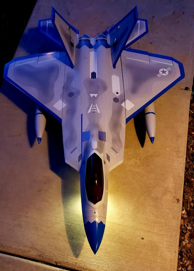

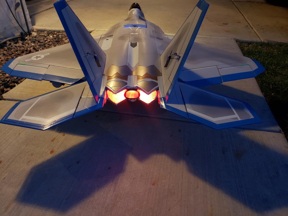

        Added led afterburner was a tricky with a turbine in thier but worked it out .And wing tanks ..

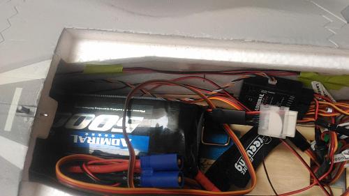

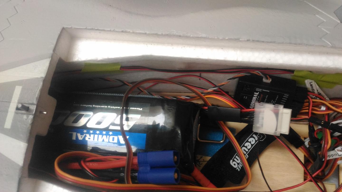

          Click image for larger version Name:	P_20190408_172149.jpg Views:	0 Size:	105.8 KB ID:	189101 O.K. different subject. Just got around to balancing the Raptor and found that the battery(Admiral 5000) had to be pushed so far back to balance that it's out of strap range.:Thinking: Has anybody else had this issue? It's easy enough to cut new slots and move the strap aft but I'm just wondering if I missed something. Forgive all the loose wires as I haven't got everything like the operable canopy wiring and lit instrument panel sorted out yet. Those wires have to be extra long so I can pull the hatch back a ways for battery changing.
          Looks like I answered my own question. I went back to Alpha's preferred setup and found that my battery position is pretty much on. I didn't realize that there are already 3 strap positions(slots) provided and Alpha had moved his back to the middle strap position which allowed the strap to be more towards the middle of the battery while mine came stock with the strap in the front position.:Whew::Cool:

              Hey Grover, good to know for sure. BTW I am back to the original question on battery placement and cg. After I cleared all the loose wiring out of the way and pulled the battery out, I realized that the stock position of the strap is already in the middle position so that means my battery is much further back than Alpha's as a for instance. His is posted at #2141. Has anybody else wound up with their battery position this far aft? I've checked it on my new balancer like three times now using the 150mm back from wing root as shown on the instructions. What am I missing?

                    That's true Steve and thanks for the input, I also added the afterburner mod to the motor and the streamlining parts which would add a certain amount of tail weight. In any case, I'm wondering what you're battery position wound up being or did you go the 8s version? If anybody else went 6s, I'd be interested in knowing their sweet spot for battery position especially if you did the canopy mod and cockpit upgrades as Steve mentioned.:Confused:

                            This is SOOO Cool! I'm not at the jet level yet - need to continue improving my skill sets but I'm definitely getting there. I assume the LED is tied into your throttle so when you reach X% it lights up? More details please.:Cool:

                              Yeah, as to the led afterburner, it has a separate controller and battery(small) and you can set it to come on at whatever throttle setting you want like you said. It also actually flickers on and flickers off like the real deal.:Cool:

                                    Brad, mine is the 6s version as well. Here's where the battery (Roaring Top 5000 @ 740 grams) needs to be for a CG of 150mm. The addition of a couple of ounces with the canopy and cockpit mods so far forward of the CG makes this necessary on our birds. I have the little 280 mAh battery for the centerburner velcroed in place as gar back as it'll go, and the exhaust ducts are lined with foil tape, which helps the nose heaviness a bit. Good thing, as I almost couldn't balance it without adding weight in the tail as the flight battery is as about far back as it'll go.

                                        Hey Tom , that is exactly the response I was looking for and within an 1/8" of where my battery wound up. Thanks for stepping up and helping my friend.:Cool:Just needed to know I wasn't off my rocker.
